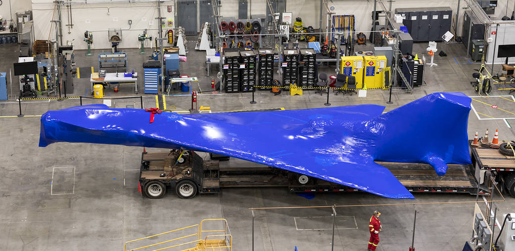

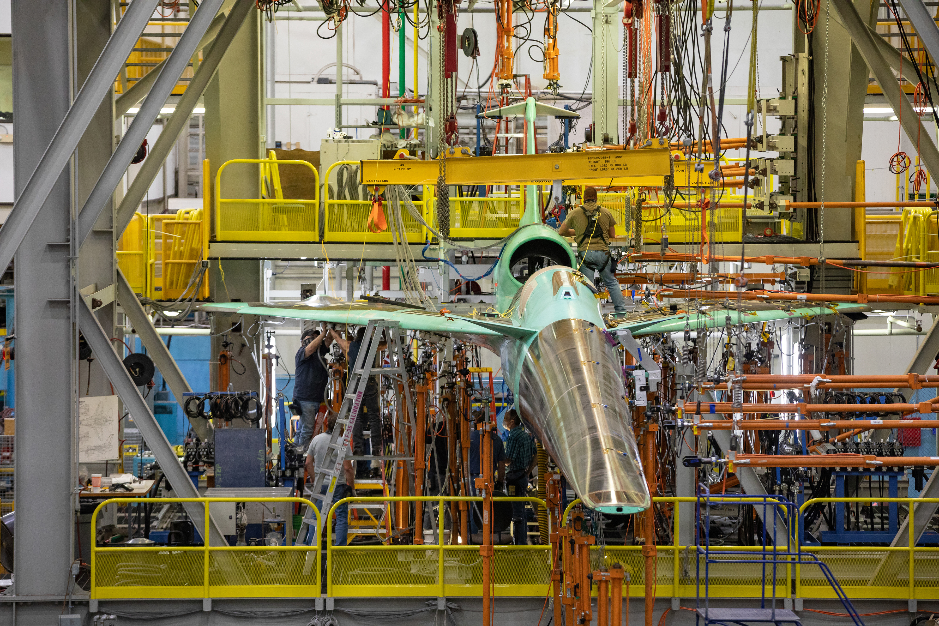

Training to fly a one-of-a-kind experimental aircraft like NASA’s X-59 Quiet SuperSonic Technology requires a flight simulator that authentically replicates the real deal. Thanks to recent upgrades to the X-59’s flight simulator at NASA’s Armstrong Flight Research Center in Edwards, California, NASA test pilots are taking the flight training and preparation of this advanced X-plane to new heights.
How much stress is too much? Buonanno explained the loads applied to the X-59 are 25 percent greater than any load the airplane was designed to ever see in actual flight.
Because the X-59 isn’t a prototype for a series of aircraft, none of the tests are designed to see how much stress a part could take before it breaks. This type of “test to destruct” is seen only in large production runs where one airplane can be pulled away and sacrificed.
“In any case, there are all sorts of safety features built into the testing so that if anything we don’t want happening is detected everything shuts off and the whole thing goes into a safe position,” Silva said.
The second goal is to calibrate the sensors built into the X-59 that are designed to tell the pilot how much stress is being measured at that point on the airplane. This is done by comparing what the sensors say with the known amount of stress being applied during a test.
“The third goal is to take the data and compare it with the computer models we used in designing the airplane in the first place and make sure what we thought was going to happen turned out to be accurate and the airplane is built as designed,” Silva said.
As of the last week of January about 80 percent of the structural tests were completed, and all is well
“Everything is passing with flying colors, and nothing is bending in a way we didn’t expect,” Buonanno said.

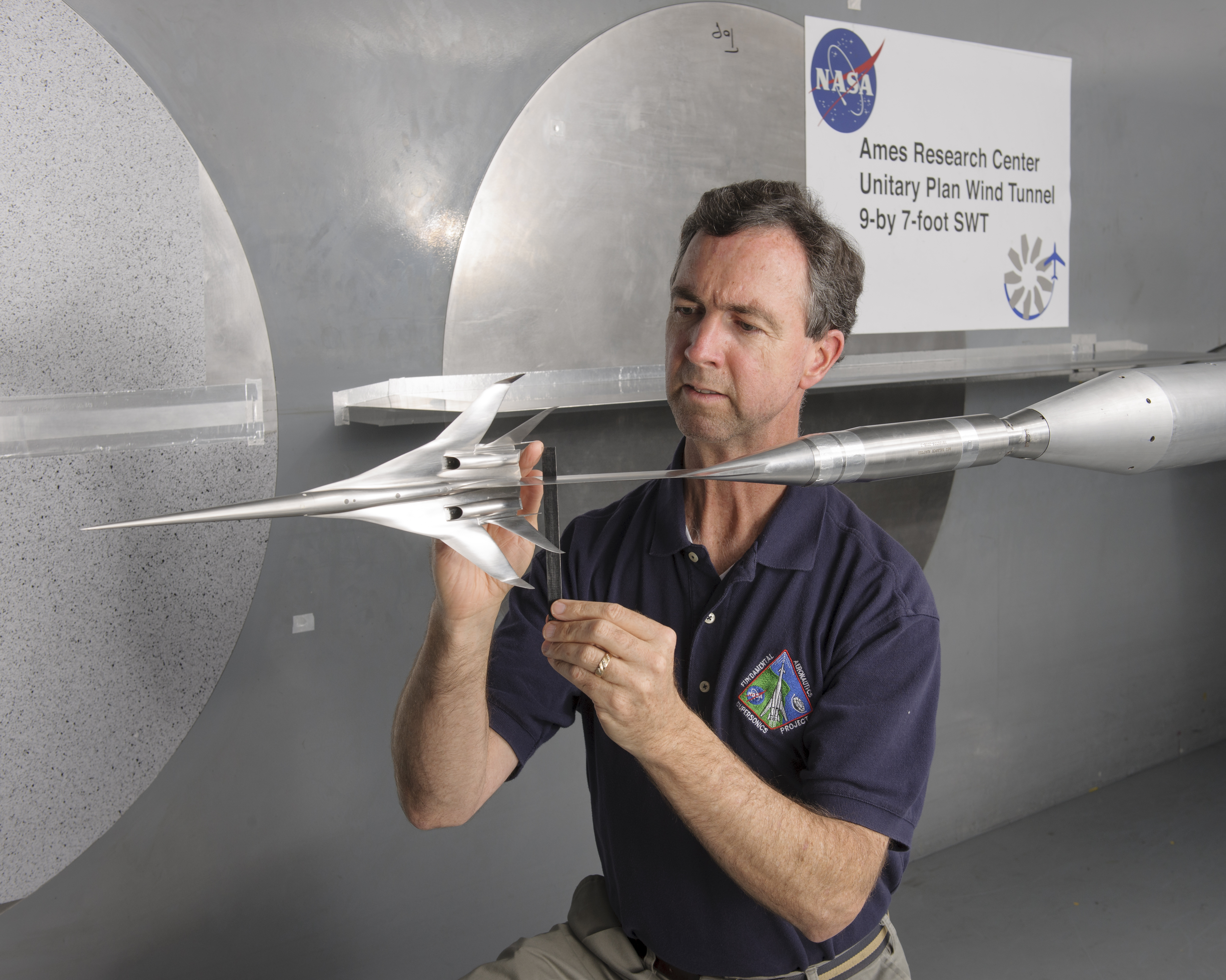

Don Durston, an aerospace engineer with a model supersonic aircraft, ready for testing in the 9- by 11-foot Unitary Wind Tunnel at NASA’s Ames Research Center in California's Silicon Valley.
Don Durston, an aerospace engineer with a model supersonic aircraft, ready for testing in the 9- by 7-foot Unitary Plan Wind Tunnel at NASA’s Ames Research Center in California's Silicon Valley.
Credits: NASA/Dominic Hart
Some researchers think of computational fluid dynamics as a virtual wind tunnel test. Luckily, Ames has run thousands of hours of supersonic tests using actual wind tunnels since the 1950s. The 9- by 7-foot Supersonic Wind Tunnel facility is part of the Unitary Plan Wind Tunnel complex at Ames where generations of commercial and military aircraft and NASA space vehicles, including the space shuttle, have been designed and tested.
One way to make sure the X-59 will work as intended is to “fly" smaller versions of the real thing in a wind tunnel. While supersonic air flows over precisely crafted small models, engineers can take measurements of the pressure waves and be sure the plane behaves as expected. Some models measured as little as five inches long, while others stretched to more than six feet in length.
But even in the 21st century, with all our technical know-how, measuring supersonic airflow over an airplane model in a wind tunnel is an uncertain process. Even running the same test with the same model can produce slightly different results on different days because the airflows in the tunnels are not perfect. Put the model in another wind tunnel and you’ll get a slightly different version of the data.
This is why Ames continues to contribute its expertise to wind tunnel operations in support of the X-59. Ames contracted a model-building company, Tri Models, Inc. of Huntington Beach, California, to design and fabricate a small 19"-long model of the X-59 for sonic boom wind tunnel testing. The first test of this model took place in 2021, in NASA's Glenn Research Center's 8- by 6-Foot Supersonic Wind Tunnel in Cleveland. The second test will take place in 2022 in the supersonic wind tunnels at the Japan Aerospace Exploration Agency, or JAXA, under a recently-announced collaboration, which will allow researchers to compare results from tests of the same small-scale model
Anyone knows what aircraft the model represents? Kinda looks like the Lockheed n+2 and Boeing Icon II.

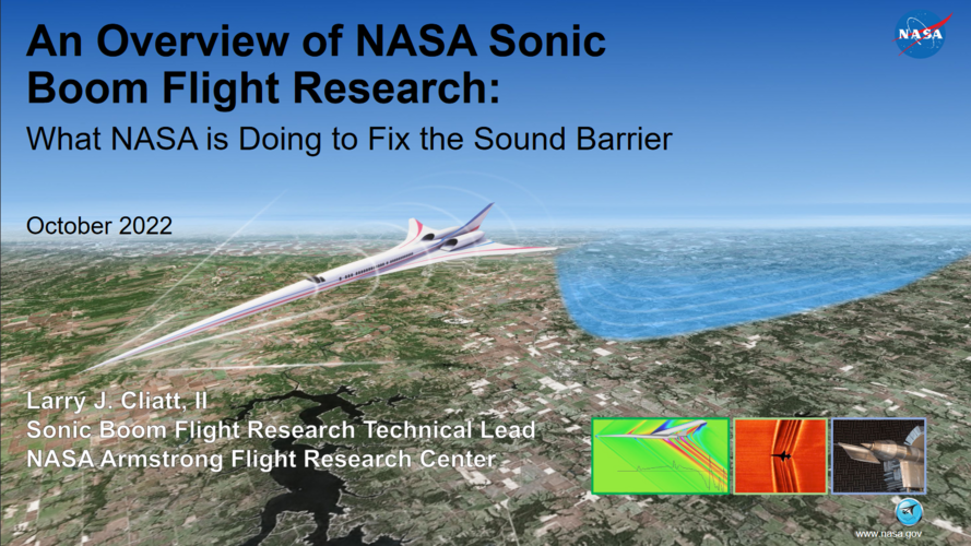

  • Screenshot 2023-01-29 at 09-03-18 An Overview of NASA Sonic Boom Flight Research - NASA Sonic ...png
  • Screenshot 2023-01-29 at 09-03-04 An Overview of NASA Sonic Boom Flight Research - NASA Sonic ...png

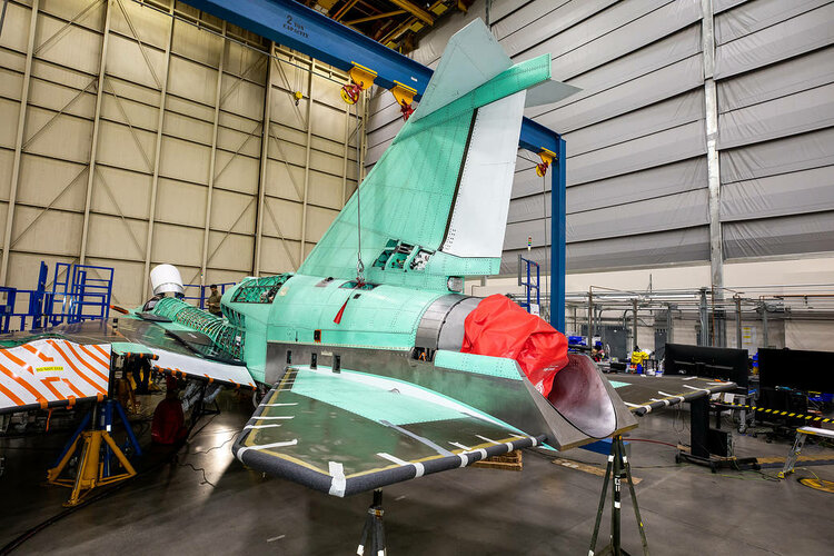

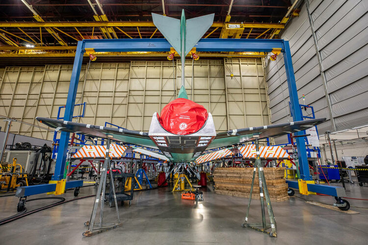

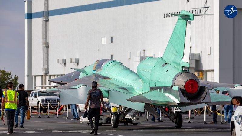

Honestly, you have to wonder why is it taking them so much time to assemble an airframe that got apparently no innovative assembly process. And look at the staffing ratio, a couple of wrencher for 2 dozen persons walking or standing around. Looks like a community service job...
Pretty large wing trailing edge surfaces, makes sense, won't need much surface deflection for supersonic flight.

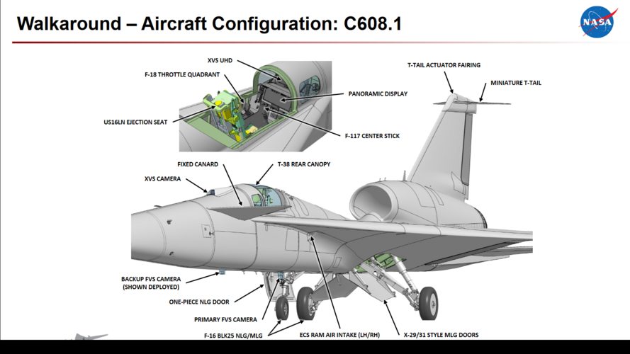

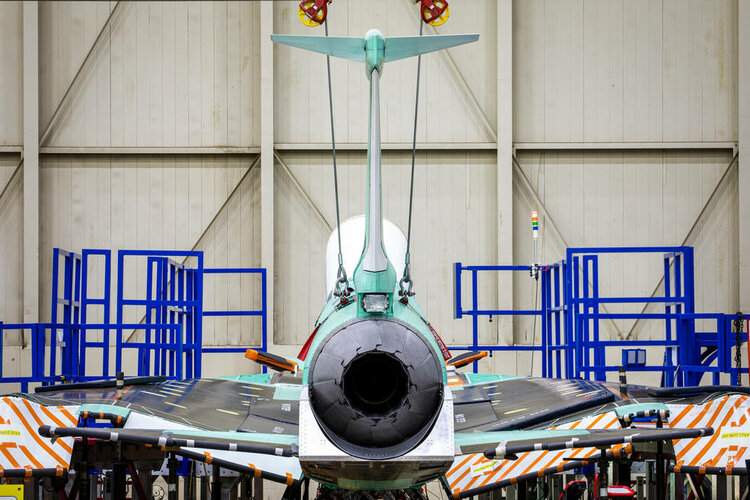

I was not expecting that shovel shape to the nose, but apparently the computers say that should reduce boom noise even more.
But flight trim for this plane is going to be weird. Engine exhaust is pointed upwards, so the canards are going to have to push the nose down.
[personal note: X-59 uses F-117 center stick]
Wasn't that an A-7 stick?
