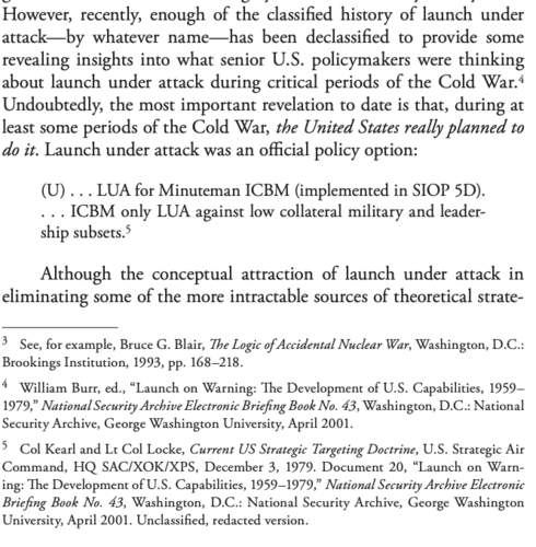

Where do you get "thinking about?" That's total mischaracterization of the source material which
conveniently italicized it for the hard of seeing: The United States really planned to do it.
If it's in your warplan and your EW/C3I and missile are technically capable of doing it (they were)
that's called "adopting."
Now, the US wished to LUA long before it became technically possible. It has a long history going
back to Eisenhower. And RAND gets it right: it was the big revelation about US strategic planning.

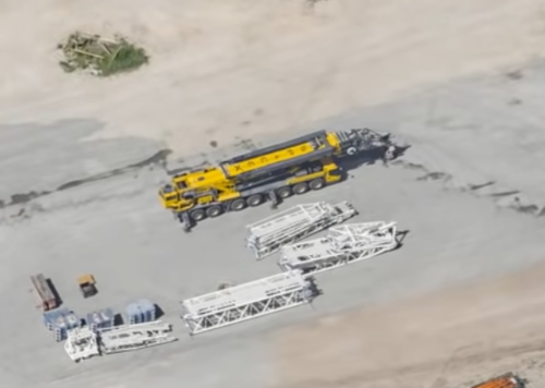

Heh. Look what's sitting at Boca Chica in the latest flyover:
Planning for a mobile Falcon 9 you think? :)
Randy
Ohpleaseohpleaseohpleaseohpleaseohpleaseohpleaseohpleaseohpleaseohplease........
SpaceX TELs trundling up and down the highways launching USSF Falcon's willy nilly from wherever they may be, filling the sky with Starlink-derived comsats, spysats, antisats, navsats... oh, my, yes.

From what I can gather from the discursive incoherency above you are describing what Garwin called Launch on Attack Assessment.
It's clear from RAND and the number of declassified docs that that's not the form of LUA the US adopted.
Maury above was talking about tactical warning timelines which he incorrectly described as launch on warning. But even so:
It's clear from https://nsarchive.gwu.edu/briefing-...-warning-nuclear-strategy-its-insider-critics
that at various times the US had adopted LOW and LUA. Sorry but the declassified documents count for more than your anecdotes.

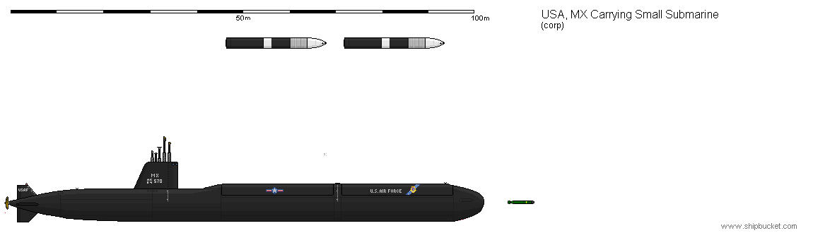

sublaunchmx-jpg.86618
Via Shipbucket:
Initial Draft of markings.
"Tail Code" located on the fin follows USAF conventions
The large two letters "MX" in this case are symbolic of the missiles being carried. The small two letters "AK" represent the proposed basing of Anchorage Alaska. In terms of the numbers, USAF has the first 2 as the Fiscal Year the air frame was approved with the other digits being sequential for that year.
Since the service entry was expected to be 1992, I figure an 8 year development time for the lead boat would be reasonable. In addition some Peacekeeper missiles were approved that year so it seemed a good fit. IRL for the FY 1984 budget the missiles received serial numbers in the 84-0540/0560 range. Following this range there's a jump to USAF serial numbers 84-0809/0812 (These were F117s). I feel that it's plausible the boats would be approved alongside the missiles so I decided to use the allocated (as far as I can tell) 84-0570 range for the serial numbers.
If this had gone through, the screams of the Navy would have probably been heard out past Pluto!

Via Shipbucket:

Via Shipbucket:
This remains the most bizarre of the MX proposals IMHO. There's no way the DoD would allow the AF to make a submarine. Even if they managed to convince anyone that it was a requirement to have MX, they'd simply hand the program to the Navy. This was more a threat to the AF than the Soviets.
You do get some feeling for the complete loss the AF was at after Puzzle of Polaris was released when you see things like this.
