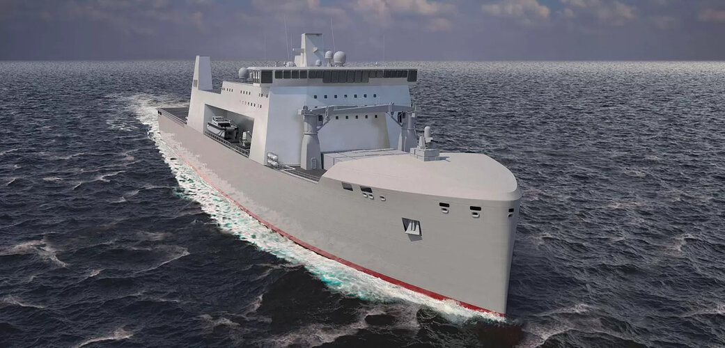

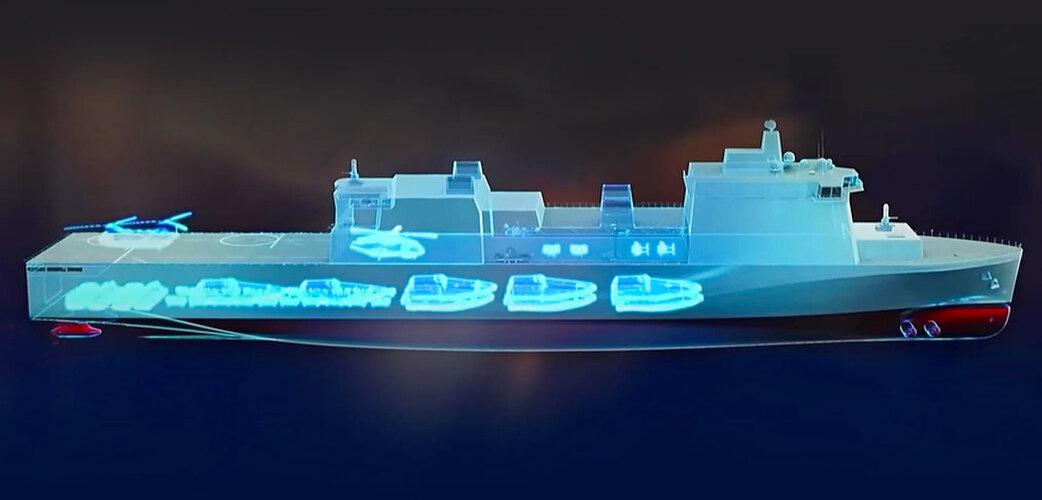

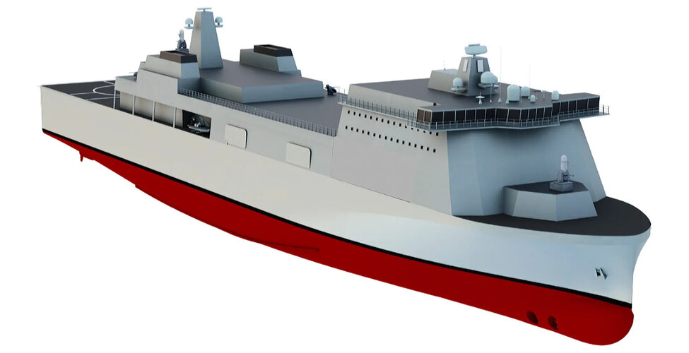

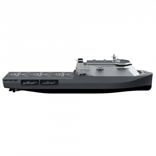

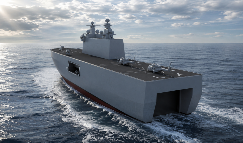

Importantly the RN says the ship must have sufficient self-defence capability to operate independently in a medium-threat environment, although they would be protected by other assets in high-threat areas. The dividing line between threat levels is increasingly blurred and raised as non-state actors and sub-peer adversaries are now able to develop or obtain much more potent weapons. It is plain that the threats to surface ships are evolving fast, particularly in the littorals and survival will demand much-improved combat capability over existing RN amphibious ships.
Keeping that in mind, how might the various proposals compare? What has been proposed so far are shots in the dark without a visible target but now that target's visible. I expect some substantial evolution to happen.
BMT's ELLIDA is arguably the most mature in terms of development but renders show a couple of CIWS and zero offensive armament. Likewise BAE's and neither design in their present form seem to have much facility for more to be added without a major redesign. In contrast Steller's is bristling with a variety of weapons. Maybe it even has a French Taunter.
(edit) Assuming the Red Sea is medium threat.
Steller's may be a bit overgunned, since it looks like it has a 5" forward, Bushmaster and CIWS amidships, and what I'm assuming is an OTO 76mm on top of the hangar. In addition, it's got a VLS of some type forward, which I am assuming is a CAMM "mushroom farm."
I think I'd drop the bow gun to another OTO 76mm. No sense in having both 5" and 76mm.
I'd rather give the CIWS wider arcs, so I'd want to swap the locations of the Bushmaster and CIWS. Can make a small deck extension/sponson to allow the Bushmaster wider arcs even if it is down on the main deck. And I might want 4x Bushmasters, honestly. One below each corner of the flight deck and the other two roughly amidships.
My concern is how capable CAMM is against AShBMs, even the low end ones that the Houthis are getting.
(edit) The other designs are inadequately protected for the Red Sea without escorts.

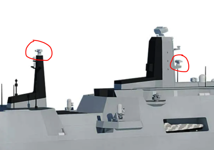

Generally agree, especially regarding the Bushmasters, though maybe the bow gun is considered necessary as offshore artillery support for commando groups when things get messy.
It appears to have a Dragonfire director on each mast too. They would be for drones and at least low end AShBMs.

Good eyes on the Dragonfires!

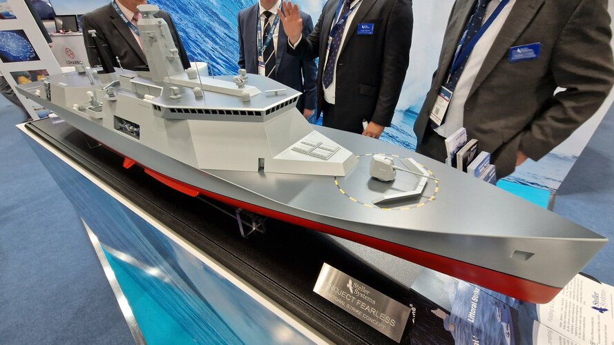

Alas, Steller Systems has appointed liquidators. I'd have liked to have seen HMS Fearless and her sister ships, Reckless, Indifferent, Lackadaisical, Overenthusiastic, and Pyschotic.
My personal opinion was that the Steller Systems MRSS concept would have been the best fit (well it was the best-looking...) for emerging requirements of the MRSS proposals we've seen so far, though to be fair, the requirement to have significant defensive and offensive weapons systems or to deploy drones was not written into the briefs for those proposals. BAE Systems now seems to be responding.

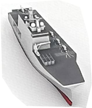

The LSC design includes unconventional hull and superstructure shapes, reflecting the emphasis on stealth, speed, range, and seakeeping. This emphasis enables LSC’s ‘mothership’ to operate beyond A2/AD reach, with LSC then deploying towards and through that threat and on to the littoral region and shoreline.
The second half of the video covers a BAE Systems concept for an amphibious warship concept with an integrated welldeck and flightdeck. The 'mothership' in the article appears to be intended to stay further from shore than the Stellar Systems Fearless design, with these new landing craft taking on more offensive as well as logistic roles.
Q: Are you pitching this to the Royal Navy for MRSS?
A: It's a conversation that's ongoing...
New article looking at proposed landing craft etc.
At first glance, the [Littoral Operations Ship] has the appearance of a typical LPD but incorporates much greater flexibility and is able to change roles more quickly than legacy amphibious platforms. This is primarily achieved through spaces that can easily be reconfigured to accept different equipment. This could include command facilities, medical space or additional storage for PODS/containerised payloads.
The
[Littoral Strike Craft] is an LCVP replacement but is not seen as a ‘landing craft’ but a multirole vessel. With a length of up to 20m and between 30-50 tonnes displacement it can transport troops and/or vehicles and act as a weapons or ISR platform. It is designed from the outset to have the option to be used without a crew for some missions but more likely to be lean-crewed, frequently operating in pairs for mutual support.
