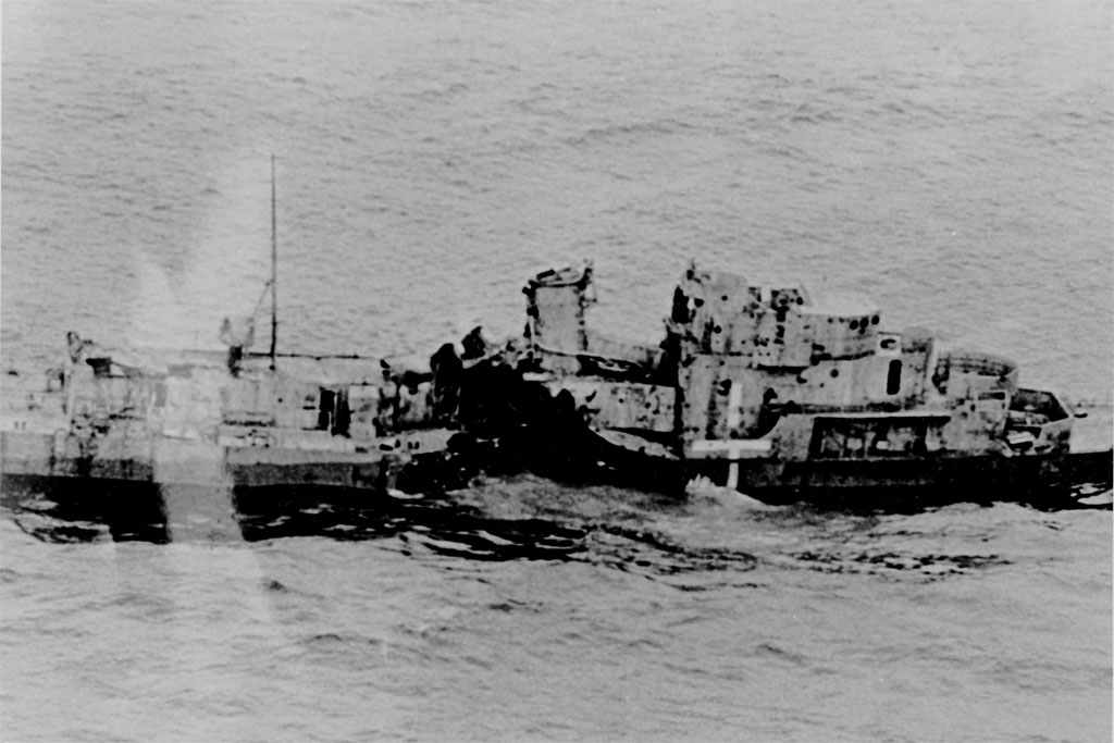

This is what a Talos without a live warhead does to a WW 2 era destroyer escort:
The hit nearly tore the ship in half. And considering it hit the engine room, it would have had to destroy the boilers and engine along with the hull structure.
