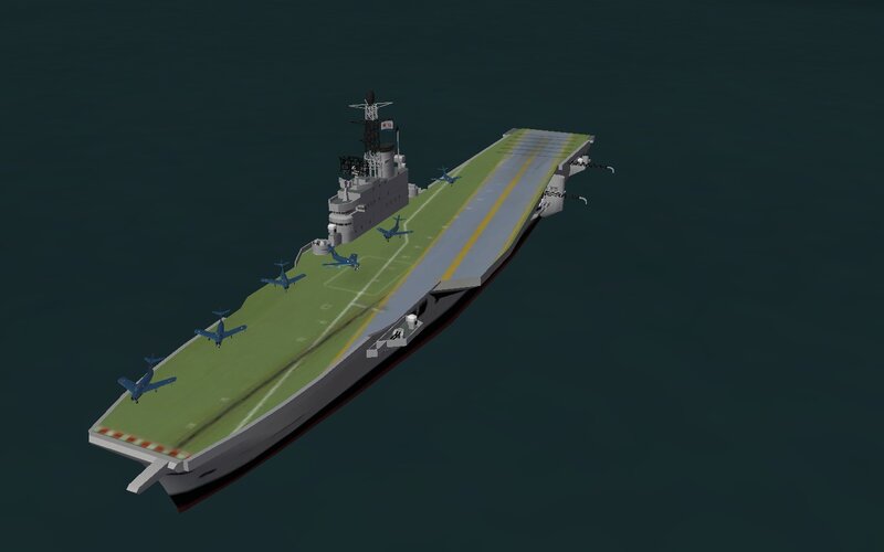

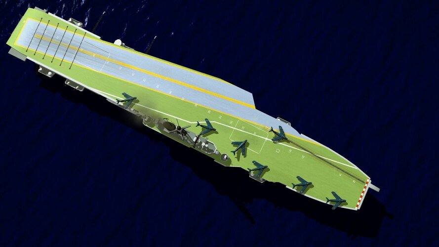

As to exports, its worth remembering the RN saw these carriers as commerce protectors, then H-Bombs come along and Strath Report says the UK doomed and will be wiped out in a day so need to worry about reinforcement convoys. So ships without use, apart from niche roles like Commando assault that doesn't need heavy choppers or aircraft.
For export nations, they saw these ships as a cheap means to enter the carrier club as fully fledged carriers with fighters and strike and ASW aircraft. Like turning up at a Ferrari race meet in a Fiat 500 Abarth...
Sadly the lack of suitable fighters rather limited export nation's choices if they couldn't get ex-USN stuff and/or the expertise or money to ask someone else to refit the carrier with new steam cats etc. like the Dutch did.
