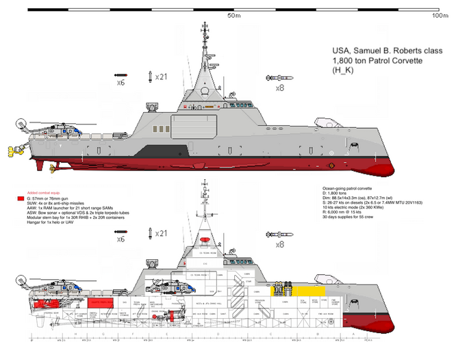

Kind of what I had in mind with my patrol corvette derived from the 1,500 ton / 87m Gowind OPV design (MN L’Adroit / ARA Bouchard class), which is about the same size as the Oaxaca class or Batch 2 Rivers.
1800 tonne patrol corvette
D: 1,800 tons
Dim: 88.5 x 14 x 3.3m (overall), 87 x 12.7m (waterline)
S: 26-27 kts on diesels (2x 6.5 or 7.4MW MTU 20V1163)
10 kts electric mode (2x 360 KWe)
R: 6,000 nm @ 15 kts
Crew: 55 pax / 30 days supply
Guns: 1x 40mm 57mm or 76mm main gun, 2x 30x113mm Bushmaster
SUW: 4x or 8x anti-ship missiles
AAW: 1x RAM launcher (21x SAMs)
ASW: Bow sonar + optional VDS & 2x triple torpedo tubes on flight deck
Modular stern bay for 1 or 2x 30ft RHIBs/USVs + 2x 20ft containers
Hangar for 1x helo or 2x UAVs
Oh, good you included a hangar space! That was going to be my main criticism. You don't want to keep aircraft on deck unless said deck is 80+ft above the waterline.
I'd personally want the 76mm, but I suspect that a US-service version would end up with the 57mm. Though I'd bet that many other countries would run the OTO 76mm instead.
Yes here's the internal arrangement (taken from the original Gowind OPV, with only minor changes, indicated in red + the enlarged superstructure and raised foredeck with inverted bow).
The modular arrangement would allow for the following:
- Hangar (port): 1x ASW helo or 2x VTUAVs or 1x 20ft container
- Boat bay (starboard): 1x RHIB or 1x ASW USV or 1x 20ft container
- Stern ramps: 2x RHIBs or 1x RHIB + 1x towed sonar
- Stern bay: 2x 20ft containers 1800t patrol corvette 20px=1m v2 copy.png
