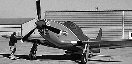

Fair start point?
@Scott Kenny I'm not into that "psi thing", anyway port fuel injection might be a better option for alcohol, mybe with a bit of central injection before the compressor.
@Scott Kenny I'm not into that "psi thing", anyway port fuel injection might be a better option for alcohol, mybe with a bit of central injection before the compressor to lower the compressor work and temperature rise.
Fair start point?

Last Corvette ZR1 is twin Turbo powered with 1000+ Hp & 1200Nm in a reliable package (at least they say!)
You can certainly make something with a twin LS set modified for an overall conservative 3000hp,
The Grumman F-7 had only 30% more power for more than 3 time the dry mass of an unlimited and reached credible speed to win a race.
iu
View: https://youtu.be/jDqkkB3DNLg?t=168
