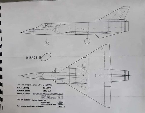

Having looked at FSP:1 last night I agree with Paul's assessment. The Mirage IIIK is an Atar 9K powered derivative of the III F2 but with smaller dimensions, presumably for export. Who or what it was aimed for is speculation, but it could carry Martel and was a two-seater so it seems to be aimed at the high-end of the market.

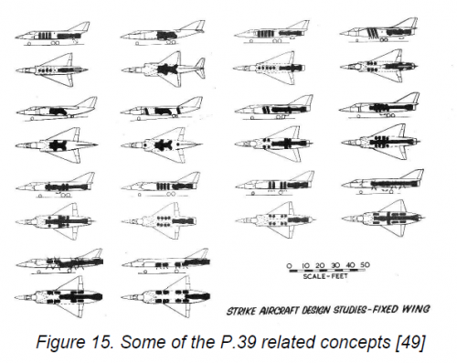

My goodness hesham, some of those P. 39 designs have a ridiculous amount of lift engines incorporated into them, whichvI would think emphasised V/TOL as its principle role, as opposed to an actual strike mission :eek:
Thanks for sharing the diagram!

The answer was the P1154, which has been pretty well covered. The P.39 studies were mostly very brief. the question was 'how many lift/propulsion engines?" Turns out the answer is one, but they did not hold the patents.

Finally reading JC Carbonel excellent book "French Secret project 1"
I start to ponder about Mirage IIIK Data from may 1965
it from it size, mass and arms, its match almost aircraft like SEPECAT Jaguar or Dassault/Dornier Alpha Jet.
except it's Mach 2.4 top speed.
