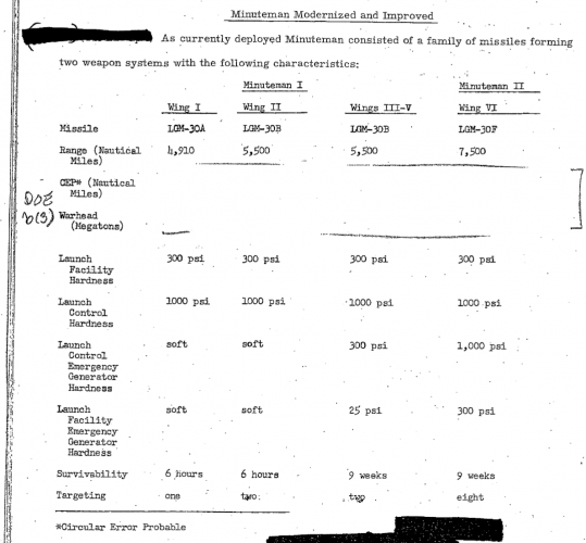

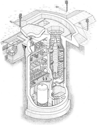

...the Hard Rock Silo Program (HRS), one of several programs the Air Force had looked to protect the Minuteman force from improvements in the Soviet offensive strategic missile force that were taking place in the mod-1960s. Thirty concepts were evaluated, with HRS selection approved by Secretary McNamara in November 1967. HRS would develop new LFs, drilled out of solid rock, that would be able to withstand 3,000-psi overpressure, while the LCC would be able to withstand 6,000-psi overpressure. Initially they would house Minuteman III, but the LF design would be large enough to incorporate future ICBM systems.
A nationwide search located several feasible areas, ending up with the selection of Laramie Range near F. E. Warren AFB. There was enough suitable land to allow 1000 LFs to be built, though initially only 150 to 450 would be constructed. On 21 November 1968 and 26 March 1969, Rocktest I and II, respectively, were conducted, simulating the air blast and direct induced ground motion characteristics of nuclear explosions using HEST on both quarter-scale model and full-size LF structures. On 30 June 1970, the Air Force Council recommended that the hard-point defense approach be changed to a relatively low-cost program, with the attributes of the Minuteman III being the deciding factor. Elements of the LF could then be approved in increments. HRS was cancelled, and instead Upgrade Silo was implemented.
