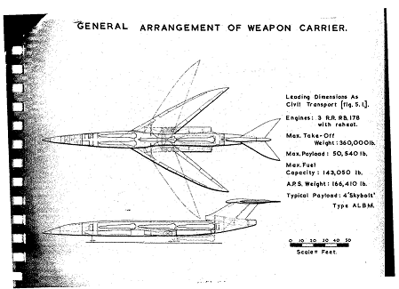

I have been told that Canberra crews in RAF Germany were to perform a similar door-kicking role for the V-force prior to its replacement with Polaris.
The proposed military Concorde carries something like SRAM so it’s a cruise missile carrier just like the B52/B1/Tu95. SRAM had a low level operating mode and was replaced by ALCM in about 1990 hence its not unreasonable to assume a similar line of evolution.

The best way to solve this bomber conundrum is for someone to go to this 'Concorde archive' (I find that far too vague for my liking) and dig out the file.
Also, back in the early 60s, Skybolts (and MR kit) were being strapped on and in anything that could possibly lift them in various design studies (Atlantic, Belfast, Trident, VC10, HP.117). I suspect the same was true of SRAMs and any British equivalent studies in the 1970s, so perhaps some drawing office apprentice might just have been sent to draw up a Concorde bomber. Always bear in mind Ralph Hooper's 'boy racer three-views'. I'd be surprised if it wasn't done.

At a guess the elusive 'Concorde Archive' might have been at Bristol (Filton) or Brooklands.
