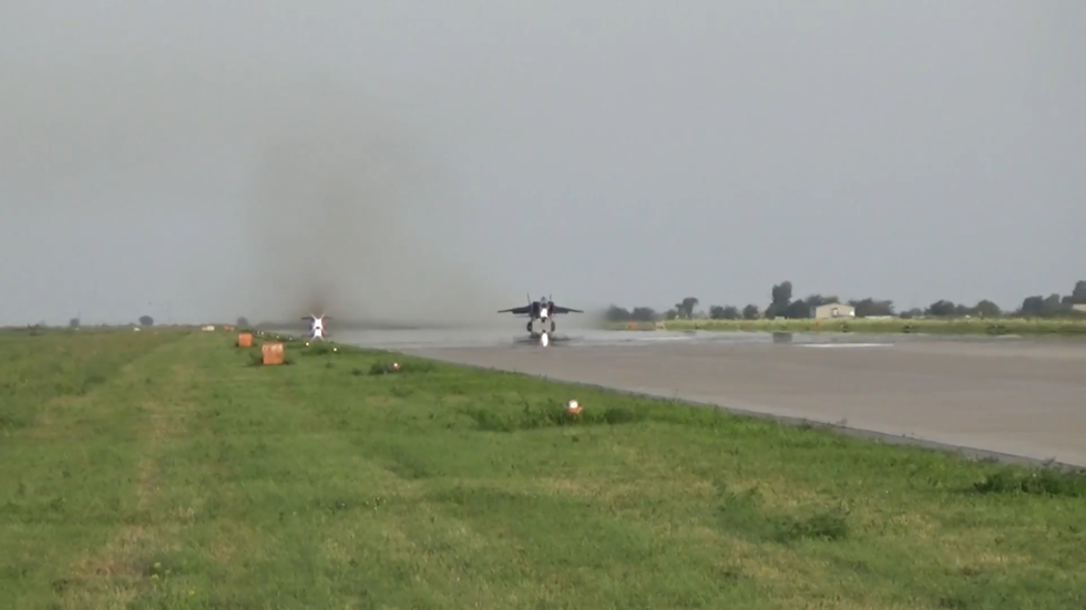

But i thought it be only fitting, as we now see Mig-31K leaving for Syria. Wont surprise me to see them test some kind of new wepons.
Thoughts?
Well, I don't see any point in flying 2000km to test Khinzal over the target, so I doubt we'll be seeing that.
Maybe they want to stick "combat proven" on the MiG-31 posters at MAKS (which is about three weeks off).
Is it possible to pre-flight program the Kinzhal to do a medium to low flight profile?
If not, would it not be wise to alert some neighbors of Syria prior to launching them..

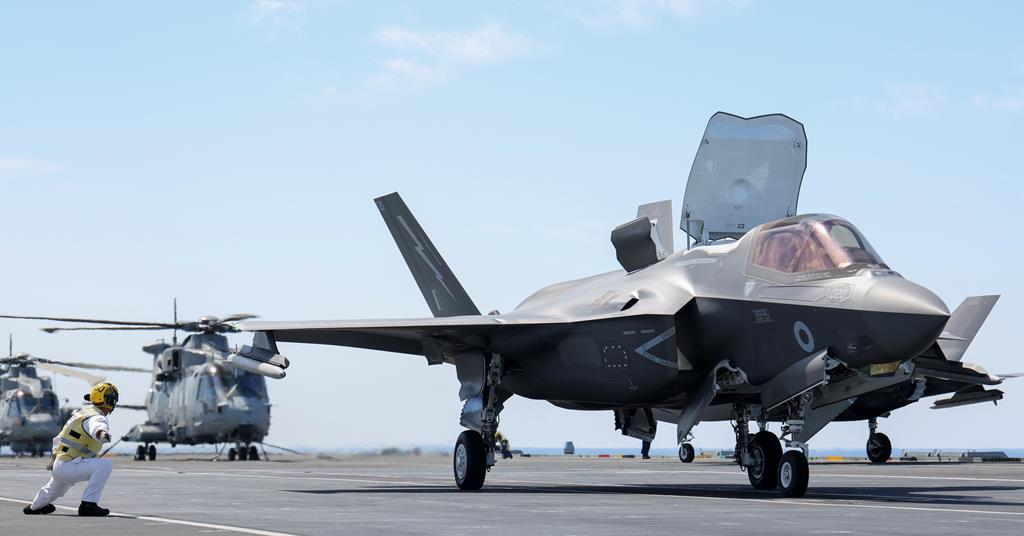

Most likely trying to take a peek at F-35s.
With what, Kinzhal?
I was wondering just a couple of days ago why the F-35s that launched strikes into Syria from HMS Queen Elizabeth were carrying external Sidewinders, but when you think about the Russian presence, it's obvious, and flying with external ordnance will completely invalidate any radar data they manage to pick up, whether from ground radar, MiG 31s or other aircraft.
With what, Kinzhal?
Never mind the external AAMs*. The F-35s were also flying with luneburg lenses, which should increase RCS far more than LO-optimised pylons/rails/missiles.
