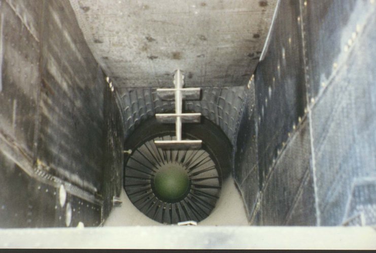

The inlet spikes physically run out of travel at Mach 3.55 and unstart the engines, though. Also, at Mach 3.55 the nose shock cone will touch the ailerons and cause control issues.

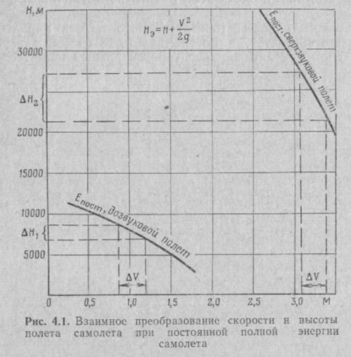

The maximum Mach-number of the aircraft with and without the stabilizer differential control system is limited with respect to thermal strength of the engines and it amounts to 2.83.
For the same reason, the flight endurance at Mach-numbers exceeding 2.4 equals 15 min (at Mach-numbers M = 2.65 it amounts to 5 min). The flight time at Mach-numbers of M = 2.4 and less is not limited.
The service ceiling of the aircraft carrying four missiles under standard atmospheric conditions is 20.500m.
In this case, the aircraft mass at the service ceiling equals 25,800 kg and the remaining fuel amounts to 3500 kg. The average time of gaining an altitude of 20,000 m at M = 2.35 in standard atmosphere conditions, with the engines running at FULL REHEAT (ПОЛНЫЙ ФОРСАЖ), from the moment the take off run is started is equal to 9.7 min for the aircraft carrying four missiles .

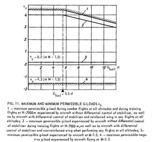

I rest my case.
