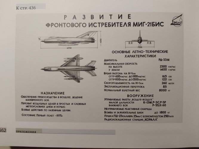

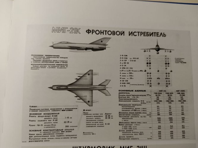

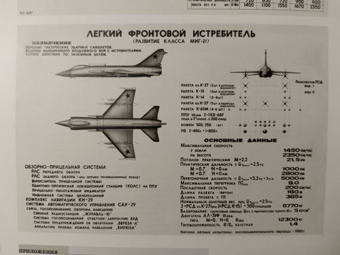

Incorrect. This "Project 33" is from the mid 1970s and was based on the MiG-23 with a new fixed wing with LERX. It was planned to use an R-100D engine (further developed R-35) and a "Коrall" (Coral) weapons system and the weapons of the later model MiG-23s (GSh-23, K-23/K-24/K-60/K-13M1) with the addition of K-14 and K-73.

Thanks for confirming that information Paul.
MiG certainly seem to have tinkering with LERX throughout the 1970s on their legacy delta and swept wing designs.

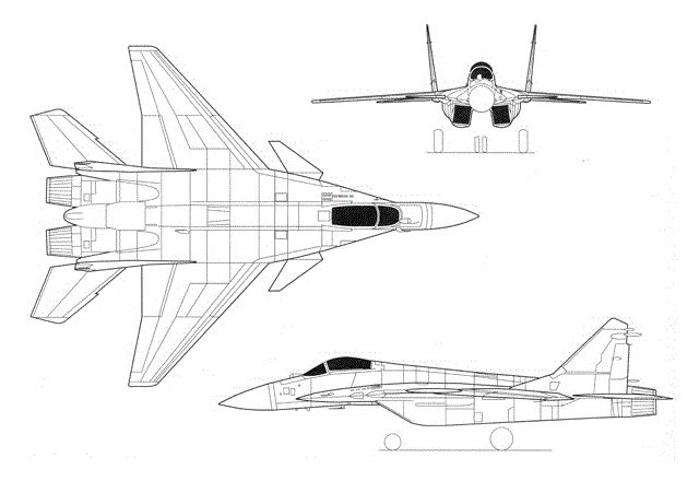

MiG-33-further development of the MiG-29, probably the MiG-29M3 with RD-43 engines
MiG-35 - 1.44 / 1.42
Was it built ?.
Do you have any more information or sources for this version? Been on a bit of a MiG-29 kick lately and want to include this in an alternate history timeline I'm writing.
