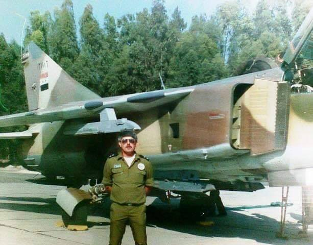

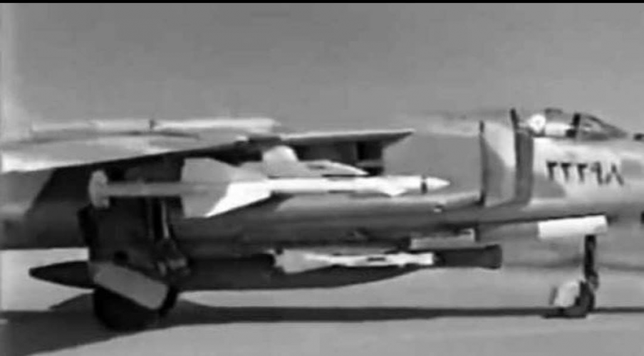

Another interesting conversion was the Iraqi conversion to allow the MiG-23 to carry the french Exocet missile:
D6RzdvyUcAANQSB
D6RzeEeVUAIKG6x
The Twitter thread with this picture has some follow-up on that. Turns out the metal bashing to make a suitable pylon was easy enough, but the MiG-23 did not have enough room for some specialized equipment that Exocet needed, so this idea was a bust in the end.
The electronic components can fit inside the micro nose of an Etendard IV!?!
The Etendard IV ? Don't think it ever carried Exocet. the Super Etendard yes.
