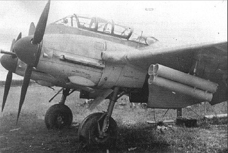

Thanks, Dan! Strangely enough, for an aircraft meant to operate at night in mid 1944 it doesn`t show any radar apparatus. Is it me or that is a belly radiator?
According to info in this book:
the belly fairing was for "Düppel" (Chaff).

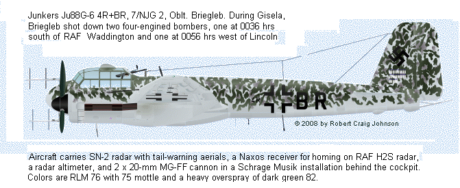

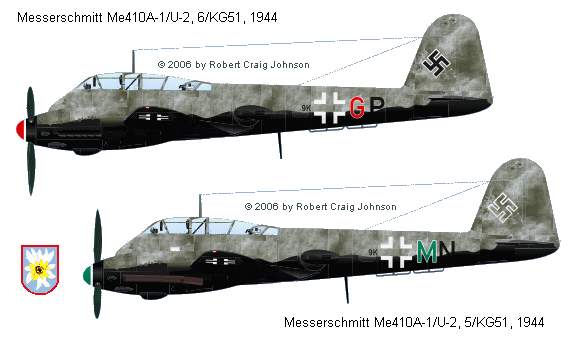

Here are a couple of the illustrations (I'm not sure what has gotten into the background of Ju88):

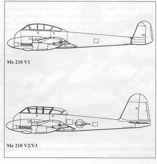

The wing of the Me 210 was - against the will of Messerschmitt and because of an order of the RLM - designed by Arado (and not Messerschmitt) engineers which led to the inadequate flying characterisics of the 210. The correction and the political hickhack between Messerschmitt, Milch, etc. also contributed to a lot of wasted time as well as the reconstruction of a new wing. By the time the 410 was ready, the more agile US escort fighters began to dominate the sky which accelerated the decline of the 410. But certainly forum members like Dan or Calum have a more detailed analysis.

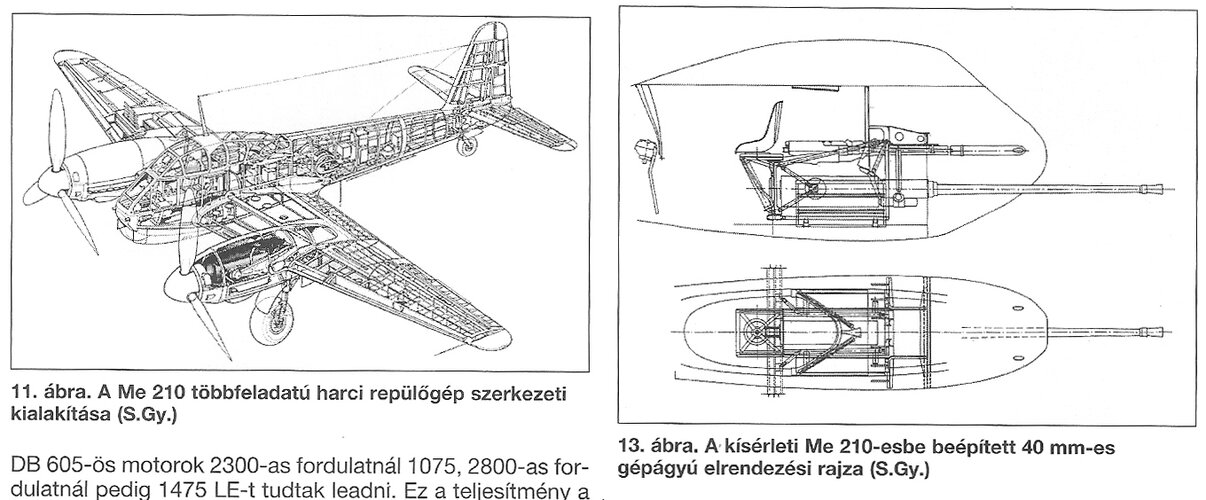

Although the Me-210 was mostly a failure in German service it was licensed to Hungary where work was done to turn it into the somewhat successful Me-210Ca-1. These changes included a lengthened tail, new wings swept back by 4 degrees, as well as DB605 engines and the removal of most of the armor. One of the intended roles for this new heavy fighter was to encounter bombers from outside the effective range of their tail guns. The ability to fit 15cm nebelwerfer rockets was thus included and to increase firepower even more a 40mm bofors 39M cannon was able to be fitted into the front bomb bay. Loading of the 40mm was the responsibility of the radio operator. The factory was stopped before mass production of the 40mm armament could start. Overall, these changes brought the Me-210 up to a similar level to the Me-410 which enjoyed some limited success.
