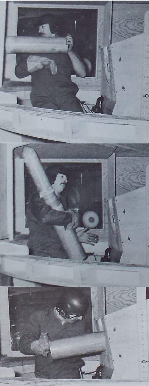

To test the MBT80 a Chieftain was modified to represent the internal arrangement with the STAMPLAR to check that the loader could still do his job. Also a number of system development rigs were to be built by 1981, including three turrets, a hull and a fire control rig. Nine prototypes were planned to be delivered in 1983 with the production line starting from 1986 and an in service date of 1989. Despite all the new tech to be developed there was pressure to bring forward the in service date to 1987.

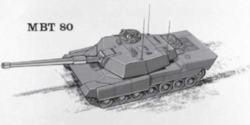

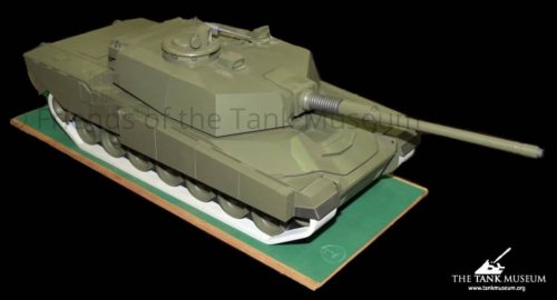

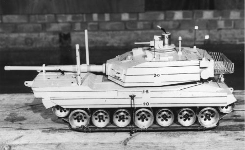

Found these images online.
The drawing is already here but the Tank Museum model is new

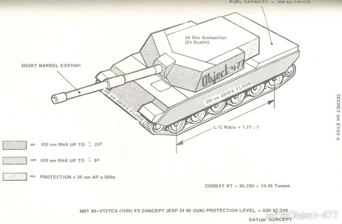

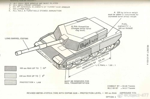

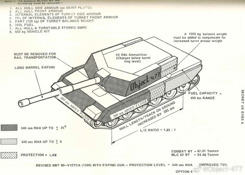

Some information regarding the Ordnance designations mentioned ab9ve in the MBT80 concept figure titles.
Ord BL, 120mm EXP3 M1-M6
Based on the Ord. 120mm Tk. L11 but with Crossley pad obturator and a three step, two piece breech block. This was later reconfigured to a two step, two piece breech block with a recoil energised auto tube loader.
Hence two (three) part separate loading ammunition
Ord BL, 120mm EXP24 M1
Modified version of 120mm EXP 19M13A for MVEE. SA cam required underneath which meant a re-design of the breech mech. Design study only.
Hence one piece loaded ammunition.
The breech configuration identified by MVEE for the 120mm EXP24 was used later for the 120mm EXP28.
Based on this the mock up shown must be based on using the EXP24 ordnance and ammunition configuration as the later EXP28 used crossley pad obturation and hence separate ammunition.

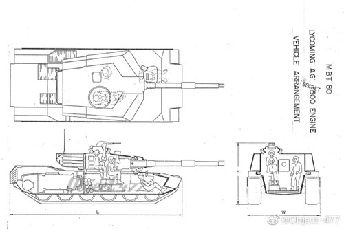

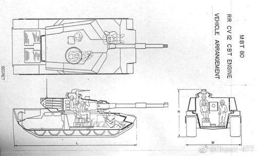

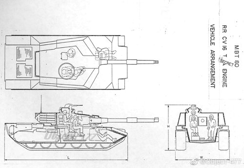

A few MBT-80 concepts, including protection and internal vehicle arrangements, appear here.
so if i understand these concepts correctly, the gas turbine engine would have had an aditional ammo storage in the hull because of its compactness. Is there any information on the amount of ammo carried in the different mbt-80 concepts?
