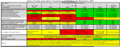

JAIF status estimate March 16 12:30. Don't know why they didn't cool the spent fuel rods normally, they don't have huge power anymore, it's standard operating procedure that's done at every nuke around the world. I imagine there must have been lots of time to anticipate that too! It's always a lot harder after a hydrogen explosion. There must have been some massive communications breakdowns.

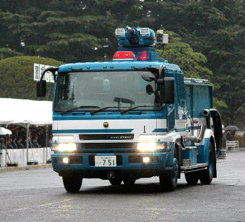

Latest I've heard is that the National Police Agency has provided their Water Cannon Units to help tackle the #4 fire too.

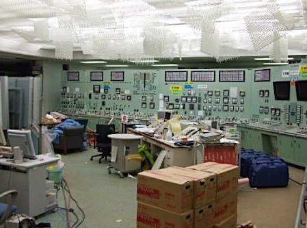

Normally there are no man in the control room because of high radioactivity level. Sometimes operators come to the control room to check reactor sea water level and reactor pressure,etc.

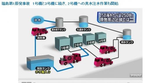

High pressure water truck already reached near No.1 Fukushima site preparing discharge water to #3 and #4 reactor spent fuel storage pool. (this morning 3/17 2011)

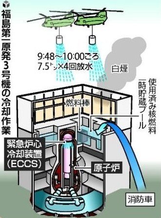

Today Japanese Self Defense Force's two CH-47(which has lead plate floor) dropped 7.5ton water 4 times to #3 reactor's spent fuel storage pool.NISA and TEPCO evaluating the effect of water bombing. High pressure water truck is not effective because reach is too short for #4 reactor spent fuel storage pool then discharged water to the #3 reactor spent fuel storage pool. CH-47 crews irradiation level was under 100mSv/h while radioactivity of mission area was 87.7mSv/h. The crew observed water in the spent fuel storage pool of #4 reactor.(TV news 19:20 17/3/2011)
Japanese self defense force's water truck #1(from 19:30) and #2(from 19:45) begin discharge water to the #3 reactor spent fuel storage pool.
Total 5 water truck discharged to #3 reactor about 1 hour. NISA and TEPCO evaluating the effect.(TV news 19:55 17/3/2011)

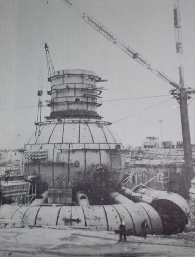

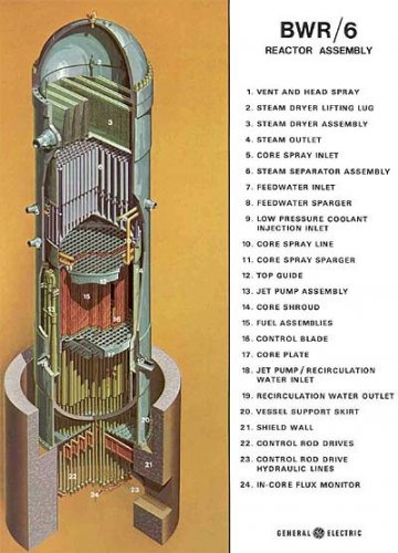

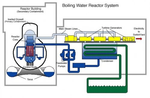

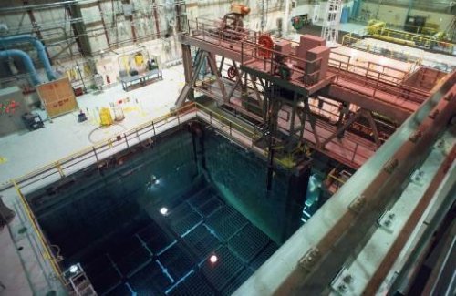

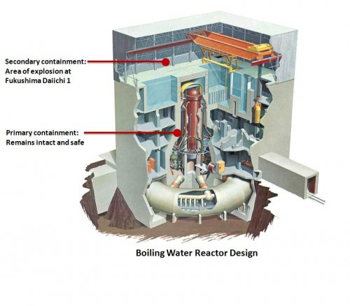

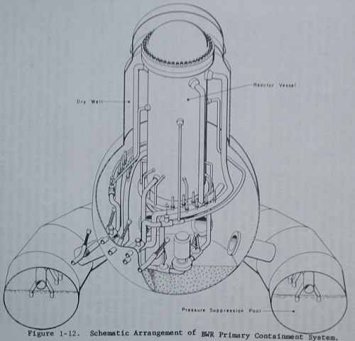

Hi! Fukushima nuclear power station Boilimg water reactor(BWR) system.
You can see spent fuel storage pool in second picture.(right side of the reactor top.)

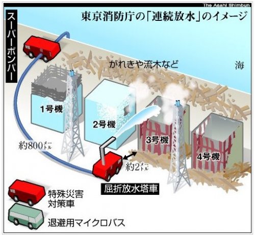

Water discharge from water truck to #3 and #4 reactor building will begin this afternoon,after finish to connect cable to the reactor building.White steam appeared from #2,#3 and #4 reactor building.(12:30)(NHK news 10:00 19/3/2011)
Tokyo Fire Department plan 7 hour continuous sea water discharge to #3 reactor building from 13:30 19/3/2011.
Also Japanese Self Defence Force(JSDF) plan sea water discharge to #4 reactor building.

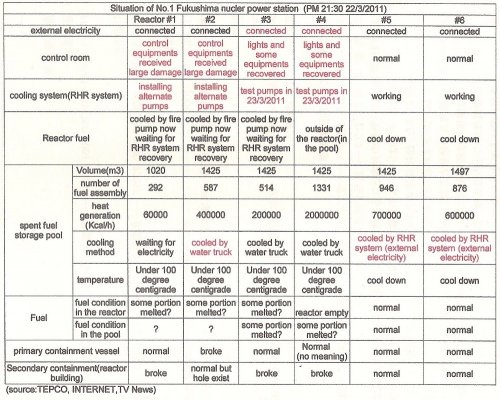

I will make a table which describe all reactor's situation.Please wait for a moment.

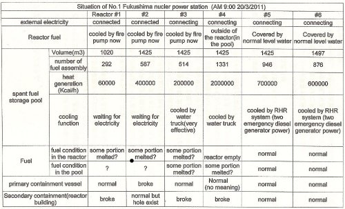

Hi! Situation of No.1 Fukushima nuclear power station AM9:00 20/3/2011.
The reactor building of #5 reactor and #6 reactor already have Small hole to prevent hydrogen explosion.
(Source:TEPCO,Internet, TV news,Newspaper,etc)
TEPSO said that #2 reactor power center recieved electricity at 15:46 20/3/2011.
Tokyo fire department will begin water discharge to #3 reactor building from this evening. (16:20 NHK news)

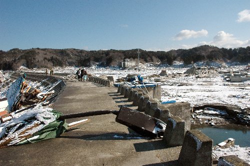

The height of this TSUNAMI fence in some village is 10m, people call this the giant wall in Japan, but no use. TSUNAMI height was twice of this giant wall.

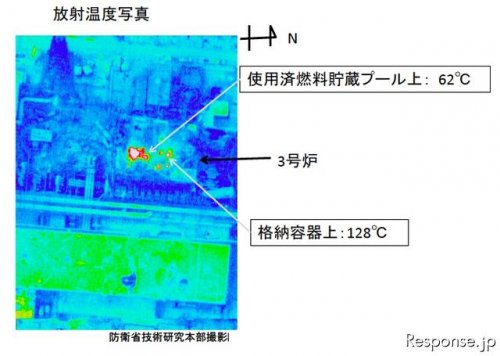

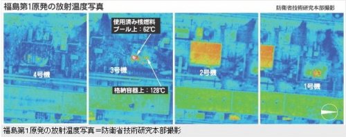

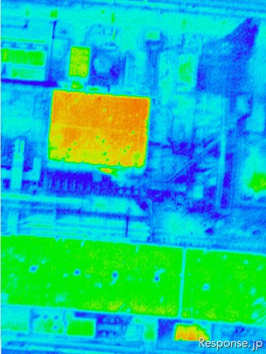

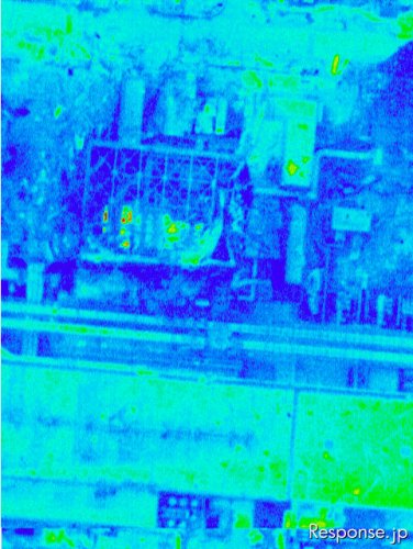

Minister of defense Kitazawa said No.1 Fukushima's temperature measured by CH-47 sensor(PM 1:00 20/3/2011) are as follows.
#1 reactor : 58 degree centigrade, #2 reactor : 35 degree centigrade, #3 reactor 62 degree centigrade,
#4 reactor : 42 degree centigrade, #5 reactor : 24 degree centigrade, #6 reactor 25 degree centigrade
According to these data,Kitazawa said spent fuel storage pool of all reactor has water. (NHK TV news)

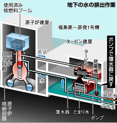

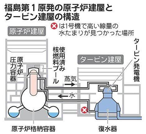

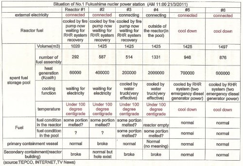

Hi! The situating of No.1 Fukushima Nuclear Power Station at AM 11:00 21/3/2011.
使用済燃料貯蔵プール上:above the spent fuel storage pool
格納容器上:above the Primary containment vessel
3号炉:#3 reactor

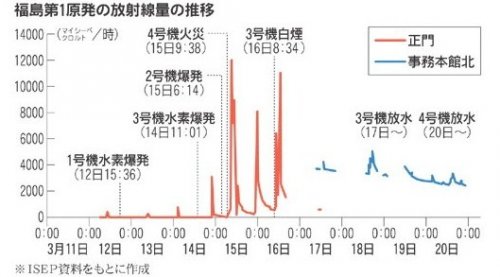

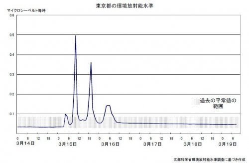

Radioactivity level in Tokyo shows 4 peaks. There are 4 explosions in No.1 Fukushima nuclear power station.
They occurred in #1 reactor building,#3 reactor building,#2 reactor primary containment vessel and #4 reactor building.
I surprised that #4 reactor building seems to be low temperature. ???
TEPCO said that TSUNAMI height was 14m, while design height was 5m.
Source:Internet
Hi! The situation of No.1 Fukushima Nuclear Power Station.(PM 22/3/2011)

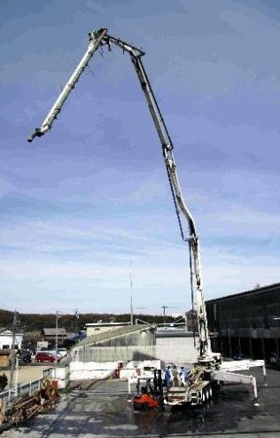

Japanese Government use special pump to cool #4 reactor fuel storage pool.
Also use dozer tanks.

TEPCO said that they begun fresh water injection to the #1 reactor instead of sea water from PM 3:40 25/3/2011.
Also they plan to begin fresh water injection to the #2 and #3 reactor.(Source Internet 20:00 25/3/2011)

The last picture show the radioactivity level of No.1 Fukushima site. Unit:μSv/h
正門:the main gate
事務本館北:the north side of the office building, 号機:#, 水素爆発:hydrogen explosion, 火災;fire, 白煙:white smoke, 放水:water discharge,
月:month, 日:day
Very high radioactivity water discovered in #1,#2 and #3 reactor turbine building where cooling system pumps located.(about 500mSv/h,”2's level is more high) TPECO is transferring #1 reactor turbine building water to the steam condenser. TEPCO and NISA judged that high radioactivity came from the reactor. They are searching the route of high radioactivity from the reactor to the turbine building.
(PM 0:50 27/3/2011)
