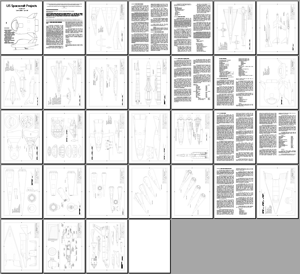

Love that side-mount TAV.What is all my hard work on the SRI Space Cruiser to go un-utilized?
https://www.aerospaceprojectsreview.com/blog/?p=2048
