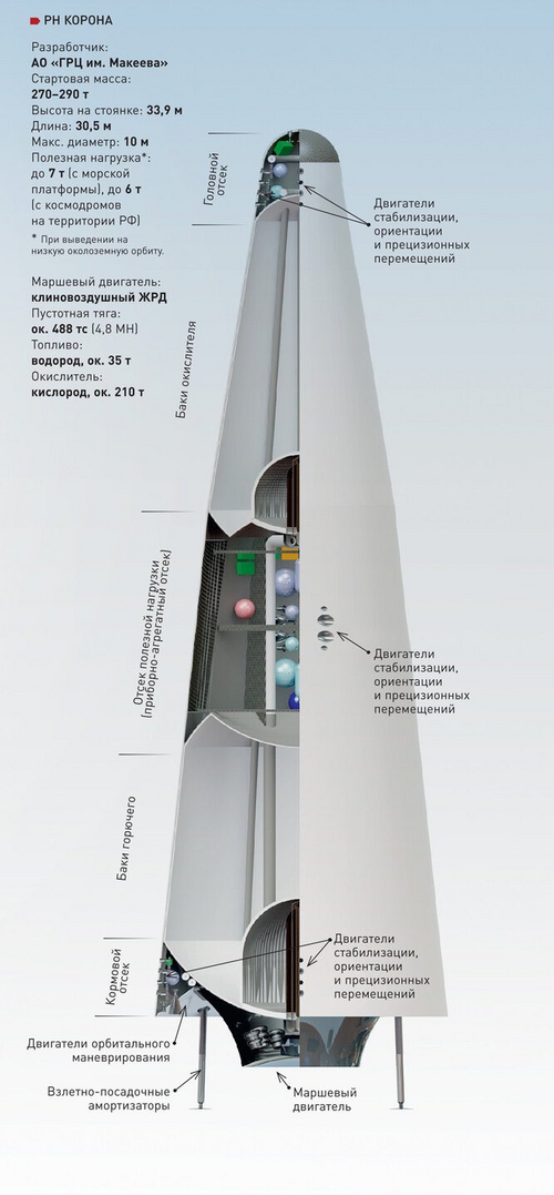

Corona
Designer: Makeev DB
Launch mass: 270-290t
Height w/ legs: 33.9 m
Length: 30.5 m
Max diameter: 10m
Payload: 7t (sea launch)
6t (Russian cosmodrome)
Main engine: aerospike engine
Vacuum thrust: ~488tf (4.8MN)
Fuel: H2 ~35t
Oxidizer: O2 ~210t
Construction, from top to bottom:
Frontal bay with stabilization/orientation and precision movement engines
Oxidizer tank
Payload bay (instrumentation and service bay) and another set of stabilization/orientation and precision movement at this level
Fuel tanks
Rear bay + another set of stabilization/orientation and precision movement
Orbital maueuver engines
Landing/takeoff shock absorbers
Main engine
