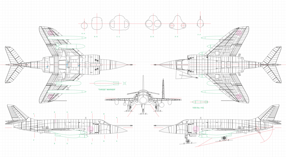

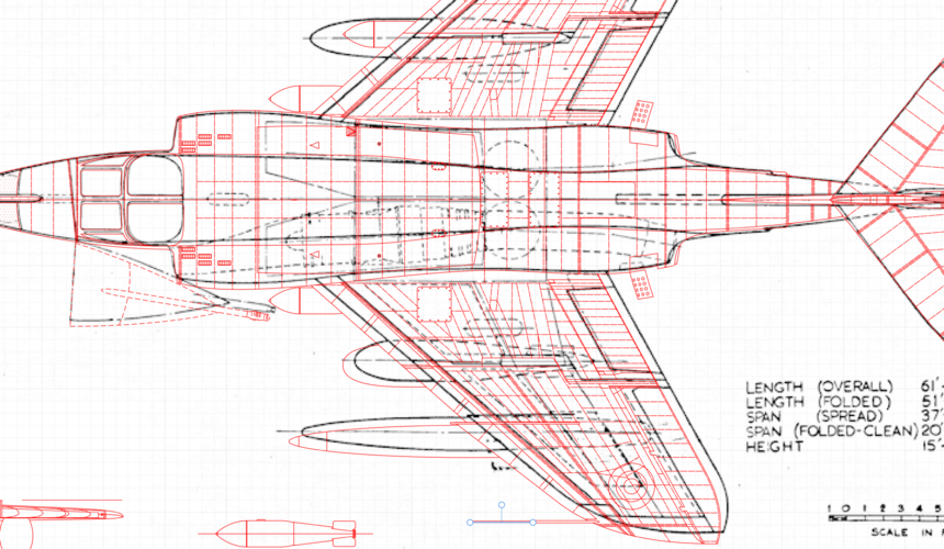

Would the Swift have been a complete mess? The PR.5 seemed to operate ok so perhaps it might not have been any worse than many other fighters of its generation, certainly boasts about it being faster than a MiG-15 meant very little by 1957 though.
Considering the basic nature of the original drawing, its not too far off from matching. Barrie's drawing was derived from original Supermarine drawings. Sadly, unlike some of the other drawings Barrie did I don't have the source drawing numbers, but he went as far on other drawings as listing Dowty (undercarriage) and Rolls-Royce (engine) drawing numbers as well, so I would be surprised if there was too much inccuracy in basic shape.
I've seen greater disgreement between two different Hawker drawings of the same design... :)
