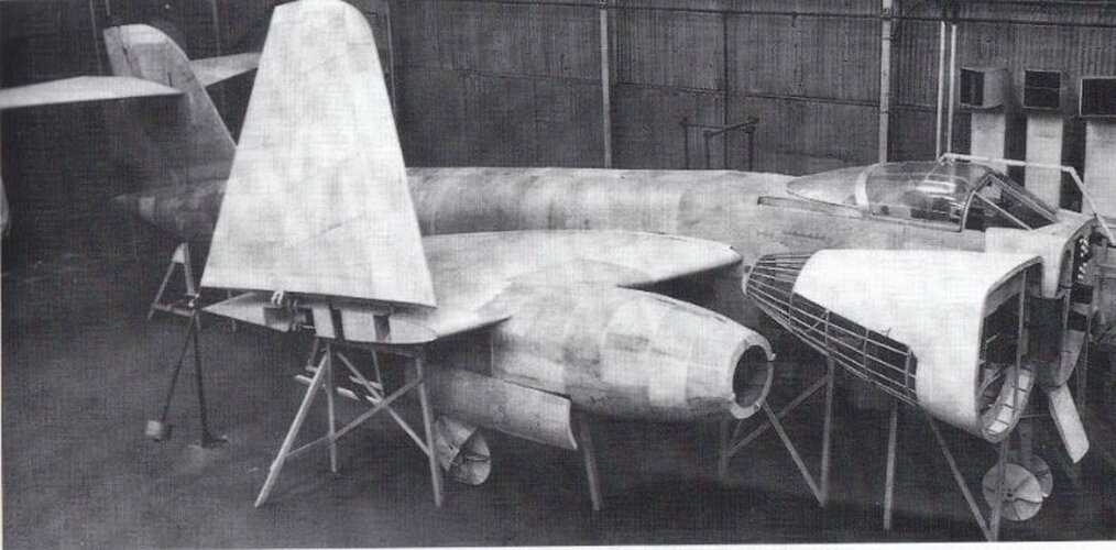

Hi! A.W.168 mockup.
Source : US & British Experimental & Projected Aircraft after W.W.Ⅱ, DELTA Publishing , Tokyo.
Obviously a rush job by Hawker. Clearly with enough time they could have figured out how to over complicate the windscreen, give it bubble side windows, transition the design to a T-tail, imbed air intakes into the wing, and create a curved compound wing that took twice as long to build. Maybe even add another engine to each wing. But I have to give them credit for the short amount of time they had, it looks pretty nice.
