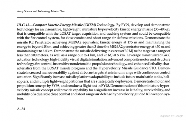

“The projected operational CKEM is expected to have at least an effective range of 400-8000 m (440-8750 yds), and the weapon system will be able to attack multiple targets within a few seconds.”
From the link I’m assuming LOSAT would have similar min range of 400m. How many tank on tank or APC v. APC, etc. are inside 400m?
