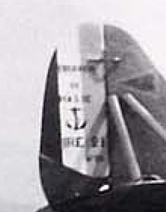

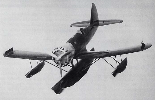

A proof that the Loire 21 is the the prototype of Loire 210: it's written on its rudder.

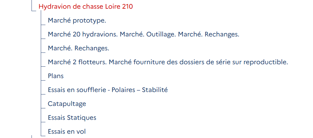

There is a reliable French sources,and to know that,I didn't fake anything,
please look to this site and they mentioned Loire-21;
Wind tunnel model test curves.
General dimensions of the Loire 21 "seaplane glider" (two examples).
Correspondence.
