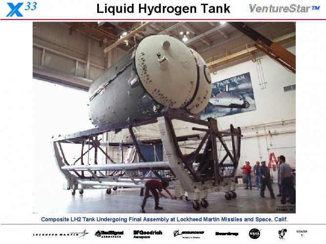

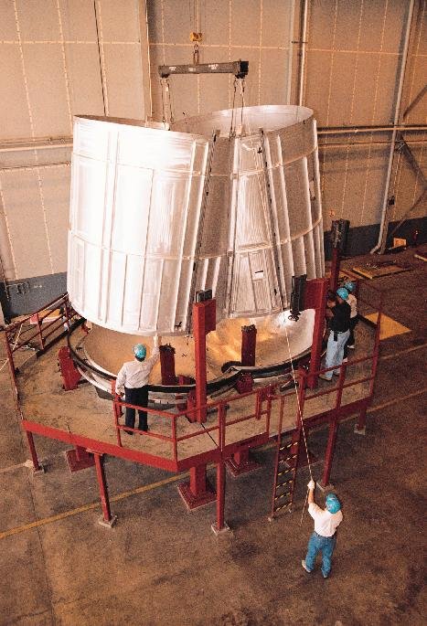

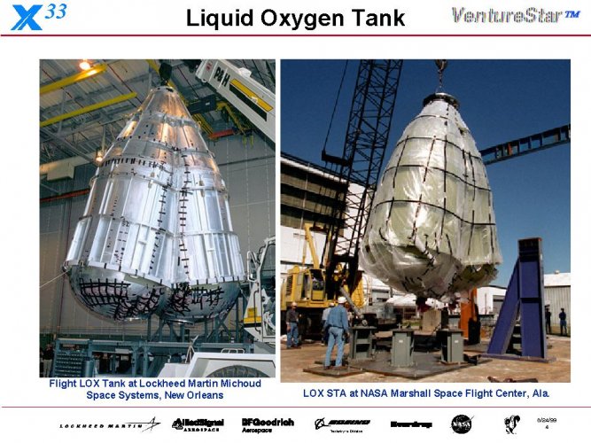

One of the poor decisions which were made by LM, was having Allied-Signal at the time responsible for systems integration, A-S made various components but had no idea how to integrate the various vehicle systems, not in their wheelhouse, that should have been LM responsibility. Had a couple of former NGC buddies who worked X-33 at the time for LM.

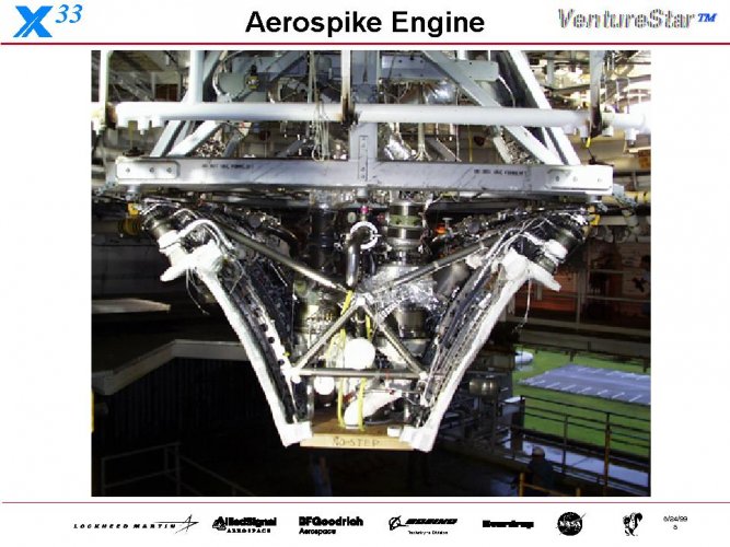

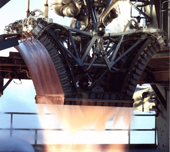

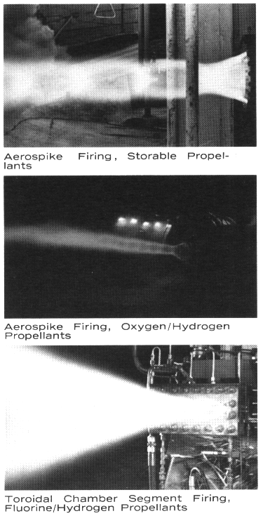

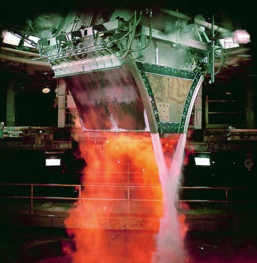

I've a vague memory of reading that the available CFD 'Computational Flow Dynamics' software predicted significantly better performance than the Linear Aerospike prototypes actually gave. Bit like Fusion research, which has spent five decades discovering umpteen exasperating ways for hot, dense plasma to thwart sufficient containment...
Beside that 'bridge-too-far' of tankage design, could we do better now ? Or is the 'Linear Aerospike' concept inherently flawed ??
FWIW, I've seen a claim that, like MagLev, Linear Aerospikes only reach useful efficiency at an impracticably large scale...
Aerospike should work but it is not sure it brings enough performance improvement to make a SSTO happen. It is no the "silver bullet" Lockheed hoped for.
Aerospike tends to be heavier than a classic engine.

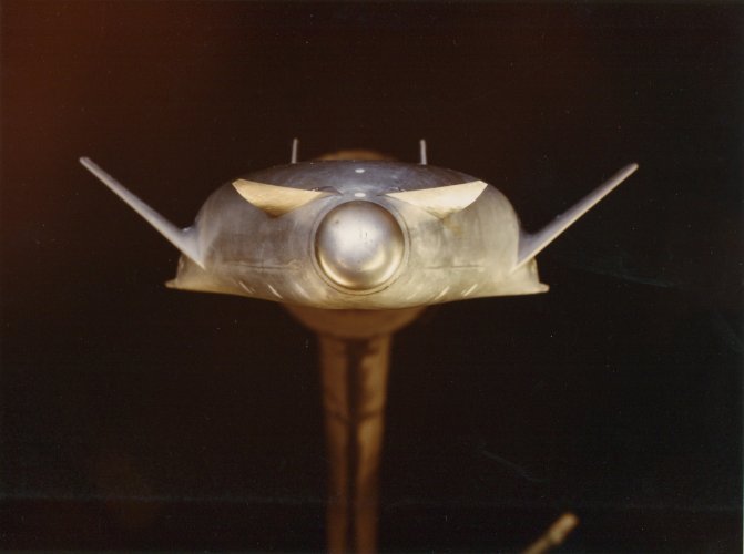

What a stupid, idiotic concept - as we Germans say: "nicht Fisch und nicht Fleisch". Late in the last millennium I did a quantitative comparative analysis of the two VTHL X-33 configurations by Rockwell and LM for the ESA FESTIP program, and the Skunk Works design ended up having a larger combined wing and body wetted area (and associated structural mass) than the classical Rockwell cylindrical body with wings for the same design mission, while even the nominally VTVL McDonnell Douglas concept derived from the Delta Clipper/DC-X all of a sudden started sprouting fins for reentry, much like Musk's current Starship. Coupled with the complex non-cylindrical tankage of the lifting body that failed in the actual X-33 demonstrator manufacturing, the takeaway message, as always, is KISS, but program cycles these days are apparently just too long and too few and far between for many actual lessons learned to be passed on to the next generation of engineers and designers. But even Musk, god bless his heart, is going with cylindrical fuselages with distinct fins and wings these days, so there is some hope for sanity yet.
multiple wrongs.

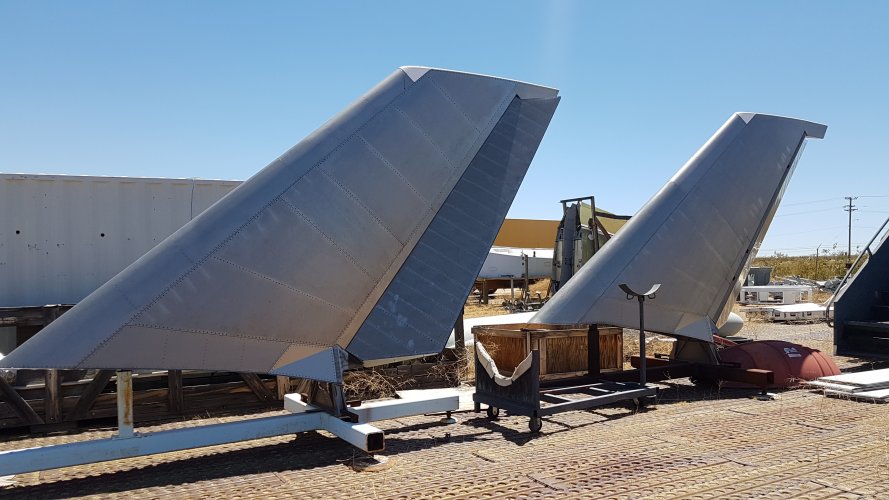

A. Wings do not belong in space.
b. Delta Clip per/DC-X had aerosurfaces.
c. "sprouting fins" is from optimization. Instead of having a having a large RCS, it is better to share the load of control. The fins on DC-X follow-on are no different than the Falcon 9 grid fins or the New Shepard/Glenn fins.
d.Starship does not have wings. It is has two sets of control fins. They are not there for lift but for control. The Starship does not fly, it is still a controlled fall.
e. "nominally" VTVL McDonnell Douglas ? How does "all of a sudden started sprouting fins for reentry" change that?
The McDonnell Douglas entry was simpler and cheaper. The rocket equation is a bitch, Rockwell system would not have worked with the added mass of wings.

A.: The Shuttle/Buran/X-37B designers would like to have a word with you...
B.: Correct, but the MDD X-33 design started out without *fins*, which were only added after apparently some aerodynamic insights were gained in the design process. The final design also had a clear top and bottom for reentry that almost made it look like a Shuttle fuselage with amputated wings, rather than the original four sided purportedly reentry orientation agnostic symmetry.
C.: Completely agree - you just made my point that aerodynamic appendages *do* have a place in RLV design, so thanks!
D.: I love a good semantics match as much as the next guy, so let's just call them aerodynamic surfaces per my point above, OK?
E.: Point taken - I should have elaborated that it ended up *not* being a purely ballistic design, but then again, apart from the Vostok/Voskhod spacecraft, even so-called ballistic capsules strictly weren't.
I firmly and strongly believe however that *neither* the Rockwell or MDD X-33 (and, quite obviously, let alone the "Chosen One" LM lifting body abomination) designs would ultimately have resulted in an actual operational SSTO, but at least the Rockwell design would have been a darn good point of departure for an actual VTHL TSTO RLV (as would have been the late lamented XSP/XS-1).
