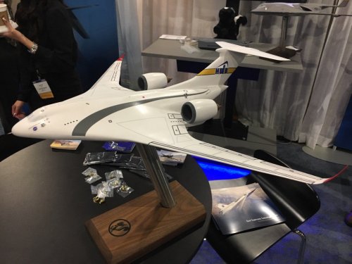

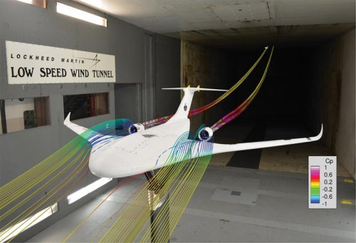

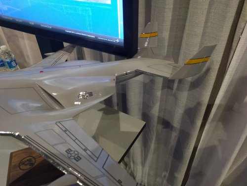

Model of the Lockheed Martin Hybrid Wing Body (HWB) demonstrator on display at the AIAA SciTech Forum and Exposition 2017.
https://twitter.com/TheWoracle/status/819211718576443395

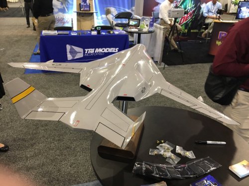

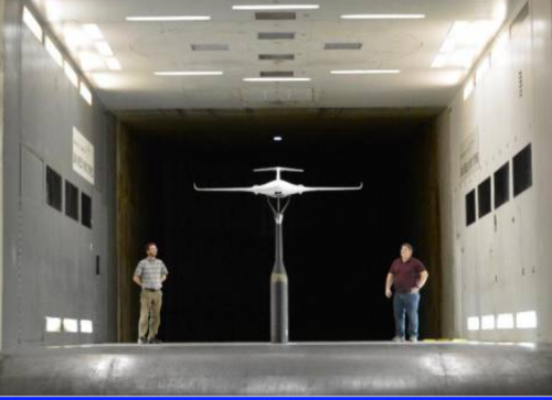

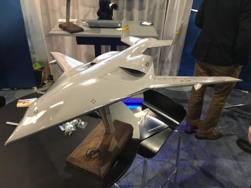

Model of the Lockheed Martin Hybrid Wing Body (HWB) stealth tanker on display at the AIAA SciTech Forum and Exposition 2017.
https://twitter.com/TheWoracle/status/819211171442081792
https://twitter.com/TheWoracle/status/819210345659174912

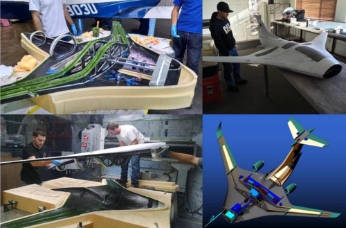

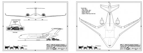

I've included the HWB in the latest issue of US Transport Projects (#7). I have high confidence that both the configuration and the dimensions are accurate, coming from a CAD diagram of a wind tunnel model.
USTP #07 available here: http://www.aerospaceprojectsreview.com/blog/?p=2956

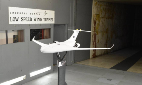

Current LM HWB STV configuration
It keeps getting more and more like a regular aircraft. :p Pretty soon we'll be looking at a Fokker 614 and calling it an HWB.
Well that's the X-plane demonstrator, not the operational vehicle. Ease of manufacture to facilitate flight testing is probably one of the key design criteria.
A conventional tail to allow continuity with existing loading practices and equipment is Lockheed's point with this design and they'll want to trial that. There's a minimum size to the rear ramp, unless you only load pedal cars and tricycles on to it, so a subscale demonstrator is going to have different proportions from a large aircraft.
HAHAHAHAHAHA.
I wouldn't be surprised if they keep going with their multidisciplinary FEM/unsteady RANS/ LES / CFD/ PIV/wind tunnel/adjoint method/insert-random-three-letter acronym analysis, they will find out the optimum real world design is...a tube and wing.
But seriously, i am not sold on the whole premise of the HWB. Just from first order considerations.
The tube and wing configuration has lots of wetted area but excellent stability. The BWB on the other hand has minimum wetted area but it's harder to get the cg range. So you say "let's combine the two!". Problem is, you inherit both the qualities and the flaws of the parent configurations. When i look at the HWB, i don't see less wetted area, and the non-circular pressure vessel is still there. So most of the overall benefits must come from the powerplant using very large bypass ratio, and large usage of composites, which you can still apply to tube and wing (well, not with engines under the wing) or BWB configurations.
Man, i am really cynical of late. :(

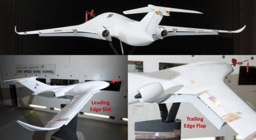

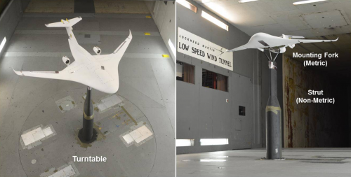

Powered Low Speed Testing of the Hybrid Wing Body
https://arc.aiaa.org/doi/abs/10.2514/6.2017-0100

@AeroFranz:
HWB function like more or less like an augmentor. It's all the airframe that works in symbiose to reach a better level of efficiency. The difficulty comes with the propulsive system and airflow distorsion at certain flight regime (low speed is one). Hence the model with representative bolted-on slats and flaps.
Boeing has already worked hard that flight domain.
For a century designer have mostly decoupled the airframe and its propulsive means. Stepping firmly into the futute is to get that right... from low speed to high speed.
(Woaw got straped in gradiloquence. Sorry if that sounded pedentic).
