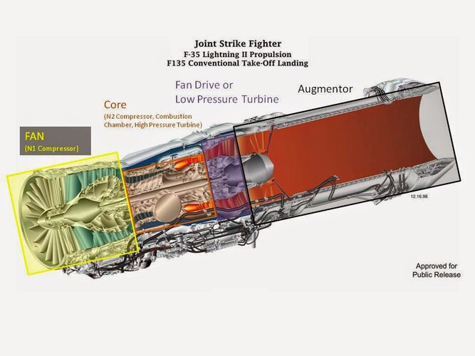

Yes, the F135 is supplying 30kW of bleed flow for 3F. However, this requires the engine to run hotter and faster to offset this diversion of core airflow, which reduces hot section life, driving the power module back to depot sooner than planned.
Do you have additional source for that or it come from your experience working on these engine?.
Anyway, I find this pretty interesting since F-18E/F intended to provide 15kW liquid cooling for APG-79. Given that APG-81 has a bit more T/R modules than APG-79 (1626 modules vs 1368 modules), I wonder what the cooling requirement for APG-81 would be. Maybe 19-20kW?
39 years as a Customer Support / Field Service Engineer for P&W
Taking bleed air from the core airflow is a double penalty for engine performance. All of the air taken from the compressor has absorbed turbine power to get it pressurized - this lost turbine power has to be offset by pushing more fuel and temperature into the combustor. And this air is no longer available to drive the turbine, which means further fuel and temp increase. And the impact is increased at altitude where air density is lower but the cooling demands remain relatively constant.
This increased bleed flow pushes up the operating temperatures throughout the flight envelope. The engine performance is reduced when against the max operating limits, and the temperatures are increased at all other operating conditions, cumulatively using up available hot section life.
I don't quite get it. How come the air used for cooling is not available to drive the turbine?. Isn't it supposed to pass through the fuel-air heat exchanger then still go into the turbine, just slightly hotter?.
Also if I understand correctly, this method of using engine air seem to generate much higher cooling capacity compared to the traditional ambient air scope right?. The air flow is obviously higher because the engine such air in?.

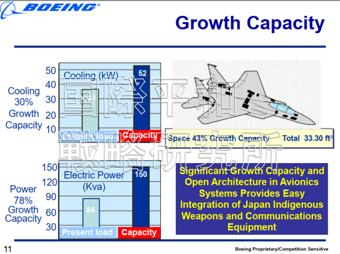

I recalled the cooling capacity of the big F-15E is only around 35kW, so for the medium size F-35 to have 30 kW cooling from its engine alone seem quite impressive. Then it probably get another 5-10 kW of cooling through the top left side cooling scope for a total of 40kW cooling

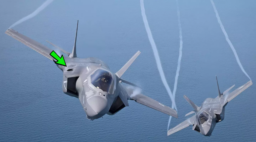

Wait a second, so if I understand you correctly, not only the air from the low pressure stage of the engine (the fan stage) is used for the cooling of the aircraft. But also the air from the high pressure compressor (the core) is used for cooling?. Isn't that a bit counter productive?. And why don't they use the fuel to take heat from the avionic/airframe, then flow the fuel into the heat exchanger for cooling (you know like a computer cooler). Isn't that a lot more efficient since liquid conduct heat much better? what the point of taking air from the engine into the airframe and not the other way around aka pumping fuel over hot stuff then into the heat exchanger inside the cool section of the engine
Another thing, I thought that only the vent on top of the body is used for avionic cooling and the belly vents are for engine and airframe cooling? (I vaguely remember reading that on Codeonemagazine)
But from what you explained earlier, both top side and belly side vents can be used for both function: avionic cooling and airframe cooling?
Roger on the vents cooling function. What ever happened to the heat issues with the two weapons bays?
Relative to avionics cooling, yes to all of the above

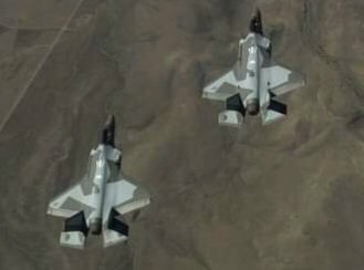

The Aggressor F-35A is sporting a rather interesting splinter pattern reminiscent of some J-20 patterns.

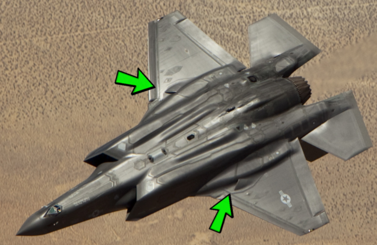

You can see both sides of the aircraft in those two pictures. One of the F-35s is not carrying the lenses while the other one has the usual 4. Wouldn't make much sense otherwise.
one of them carries luneburg lens while the other does not. Interesting.
Isn't there another possible mounting point on the other side, which wouldn't be visible from this angle?
Look at the second photo. Both F-35s are facing the camera at the same angle. Lunesburg lens is visible on the one further away. There is no way that the vertical slab could’ve obscured it.
The below image shows it clearly.
