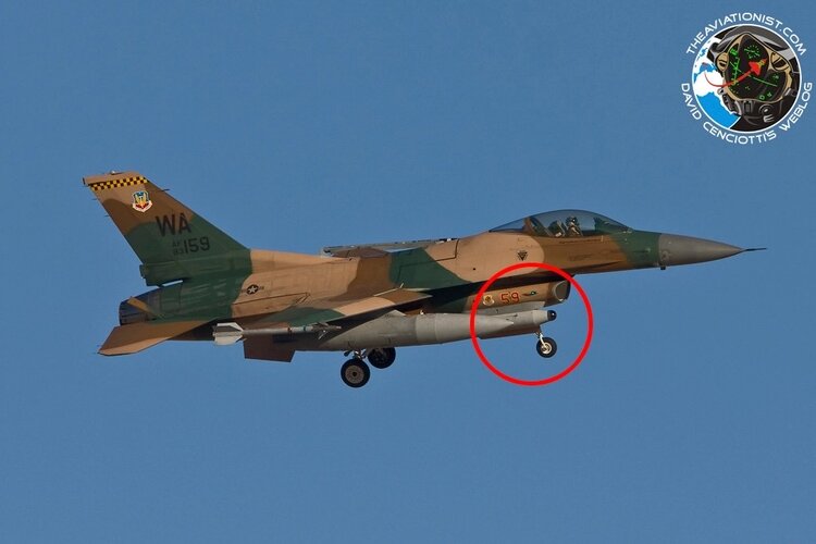

Aggressor F-16 has IRST

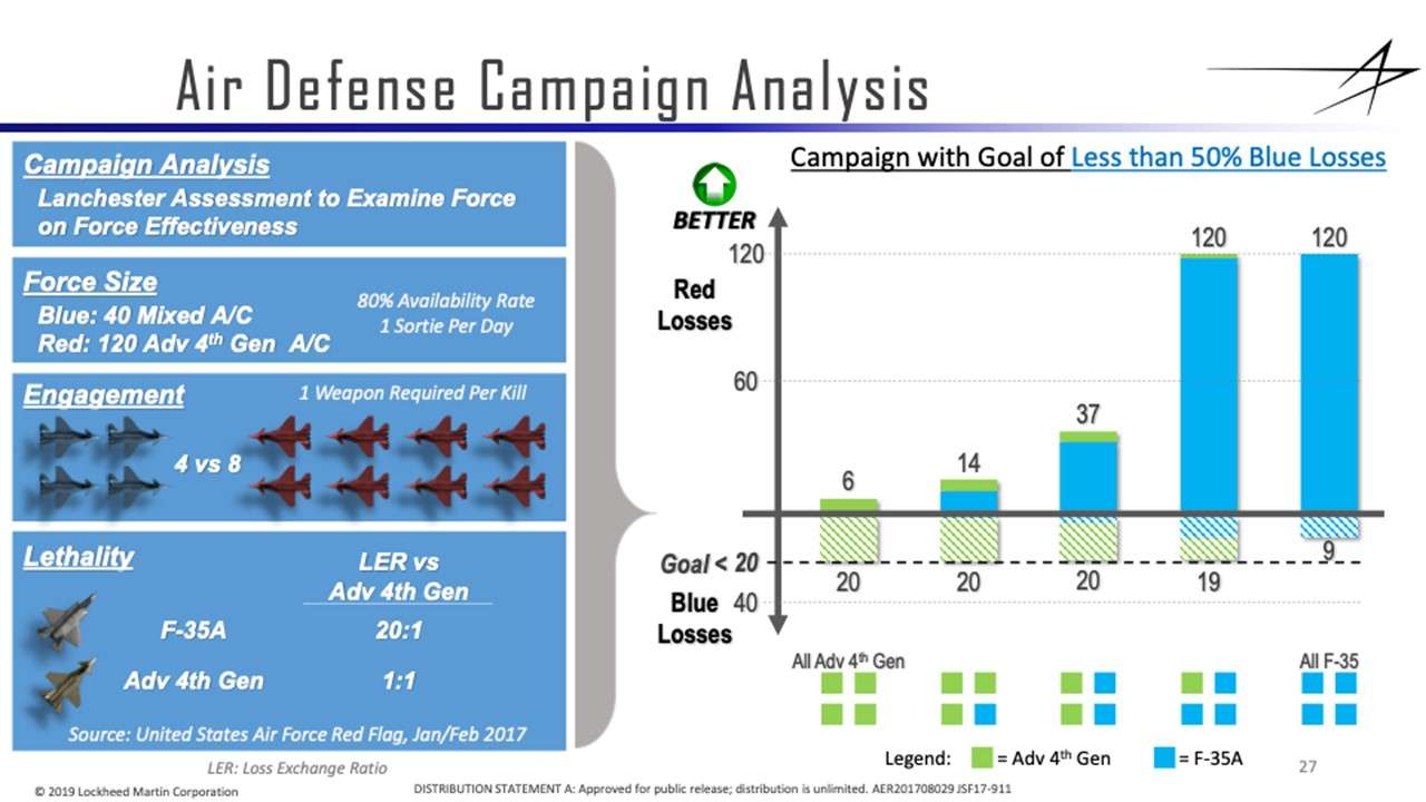

What do you mean by entirely blue? 20:1 kill-loss ratio that F-35As running Block 3i software (2x AMRAAM only, no gun, 7G max loading, reduced mission systems functionality) got going up against F-16A/Cs, Draken International aircraft, and F-15Cs (the 125th FW had their jets augment Red Air at times) - remember too that the dedicated aggressors are designed to use range instrumentation systems to emulate the capabilities of MiG-29s, Flankers, etc (even using virtual radars, etc to emulate the mission systems of other jets).
That chart on the right is then running through 5 scenarios where a Blue Air comprising of 40 jets (100% 4.5th gen on the left, then 75%, 50%, 25% and then finally 100% F-35s on the right) goes up against 120 Red Air jets of equivalent 4.5th gen capability. Red losses are shown above the horizontal axis, Blue losses underneath. Colours designate what Blue Air jet made the kill or was killed.
So initially on the left 6x 4.5th gen Red Air fighters are killed and 20x Blue Air 4.5th gen fighters are killed. On the second-last from the right all 120 Red Air are killed, with something like 95-99% of kills made by F-35s and the remainder made by the Blue Air 4.5th gens. Meanwhile 19 Blue Air jets are killed, with about half being 4.5th gen and half being F-35s.
It's a very simplistic / simplified analysis that's just running those 2 kill ratios, the availability rate and force sizes (40 vs 120) through the Lanchester laws, but it delivers the intended message.

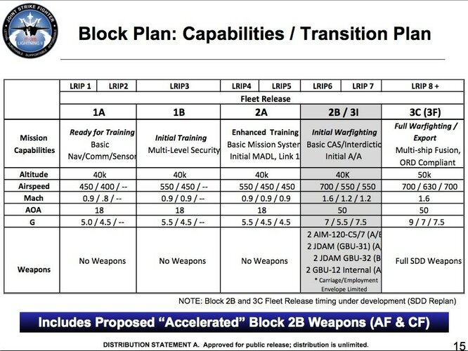

As per the chart below the F-35As flying with Block 3i were only capable of 50 deg AOA, 7Gs and could only carry 2x AMRAAMs (vs 4x today and 6x in the near future with the Sidekick bay adapter), and 2x GBU-12/31/32s. The internal cannon on the A variant (and gun pod on the other variants) was also only cleared for use in Block 3F.
Here's another chart which is a bit more convoluted but you can see the gun being mentioned as a Block 3F addition where there's there's a semi-circle with "INT" written under it (and on the left it says how that Block 3F loadout is just Block 2B/3F CTOL [F-35A] loadouts + Internal Gun - on the right it also has the tick indicating that that specific payload configuration applies to the F-35A variant only [because of the internal gun]):
