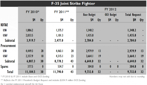

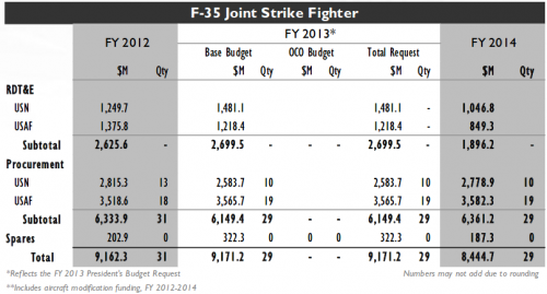

Per the FY2014 USAF budget docs (USN/USMC are similar):
Funds to upgrade all F-35s to Blk 2B were part of the FY2012 and FY2013 budgets.
FY2013/14 funds are focused on Blk2B Concurrency issues.

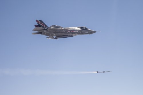

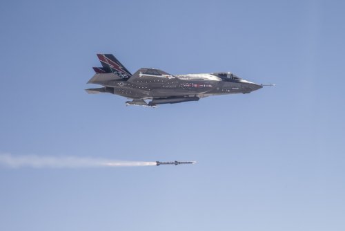

F-35A completes 1st in-flight missile launch 06 Jun 2013
"6/6/2013 - EDWARDS AIR FORCE BASE, Calif. (AFNS) -- An F-35A conventional takeoff and landing aircraft completed the first in-flight missile launch of an AIM-120 over the Point Mugu Sea Test Range, June 5.
It was the first launch where the F-35 and AIM-120 demonstrated a successful launch-to-eject communications sequence and fired the rocket motor after launch -- paving the way for targeted launches in support of the Block 2B fleet release capability later this year"
http://www.af.mil/news/story.asp?id=123351580

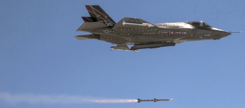

Ok, more F-35 launch AIM-120 pics ;D

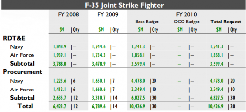

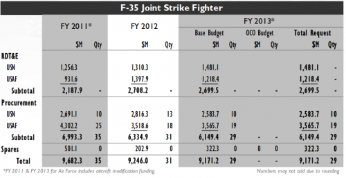

Winslow Wheeler argues F-35 procurement costs per aircraft have in fact gone up over the past three years:
His figures are based on Defense Comptroller data. I have extracted the relevant data from the 2010, 2012, 2013 and 2014 budget requests. The Comptroller's data are at odds with the latest SAR's view that costs are finally coming down.
From http://comptroller.defense.gov:
FISCAL YEAR 2010 BUDGET REQUEST
FISCAL YEAR 2012 BUDGET REQUEST
FISCAL YEAR 2013 BUDGET REQUEST
FISCAL YEAR 2014 BUDGET REQUEST

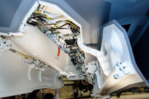

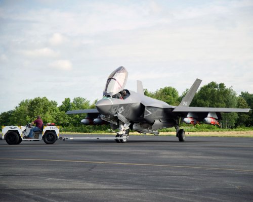

F-35C Heavy Weight Ground Tow Test 4 x 2,000 lb GBU-31s
"F-35C CF-3 was used for a heavyweight ground tow test at the Naval Air Warfare Center Aircraft Division test facility at NAS Patuxent River, Maryland, on 6 June 2013. The aircraft was fitted with four 2,000-pound GBU-31 guided bombs on the aircraft’s external pylons. US Navy Lt. Cmdr. Tony Wilson was in the cockpit during the test."

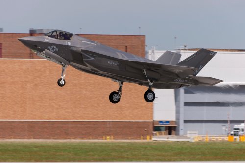

F-35B BF-28 First Flight
Lockheed Martin test pilot Billie Flynn was at the controls for the first flight of F-35B BF-28 (US Navy Bureau Number 168726). The flight occurred on 8 June 2013 with takeoff and landing at NAS Fort Worth JRB, Texas.
