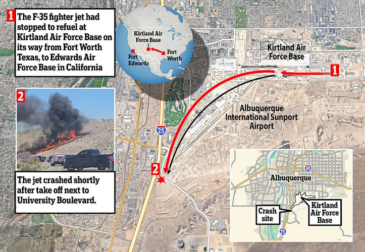

I've driven by that site many a time, and flown over it quite a few, going in and out of ABQ on holidays.
It looks like the KOAT article cited by Daily Wire may have been revised. It now says that this aircraft was a new aircraft on a delivery flight from the Lockheed Factory (Fort Worth, presumably) to a Marine base (Yuma, possibly?) to be placed into service.
Breaking news from CBS:
The pilot was able to eject but is now in hospital with serious injuries.
Crosspost:
From Aviation Safety Network:
https://aviation-safety.net/wikibase/388482
"A Lockheed Martin F-35B Lightning II crashed shortly after takeoff from runway 21 near Albuquerque International Sunport (ABQ/KABQ), New Mexico. The pilot ejected and was hospitalized with serious injuries, but in stable condition.
"It was a developmental F-35B model on a delivery flight [to KEDW] by Lockheed Martin.
"Possible candidate is TR3 & Bk4 test aircraft Bu 170052, c/n BF-159."

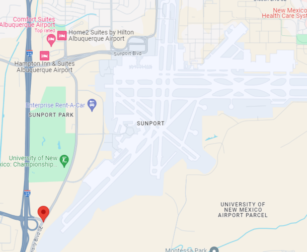

So, lifted off in STOL mode and crashed just after. Probably an automatic ejection. Let´s hope that this was not a factor in the crash.
We can see that the a/c didn´t clear the hill at the end of the runway (the picture in the link are the best to see that).

I see the picture with the fan door open. But I can't understand why they would be doing an STO on a 10,000-foot runway, especially with a long flight ahead of them (sounds like it was supposed to be direct from ABQ/Kirtland AFB to Edwards).

Yes, this is the picture we discussed yesterday. You can see, as you said that both the nozzle is rotated and the ramp opened... but also that the aircraft is past the paved runway end.
Interestingly also, the series of shots suggest an attempt to turn port after liftoff.
