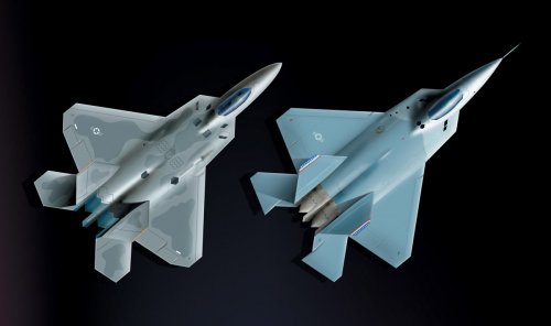

this is, obviously, YF-22A
but it's nice picture..
here is another one

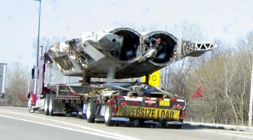

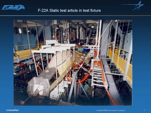

quite a rare photo
That looks setup for two JDAMs and two AIM-120s.

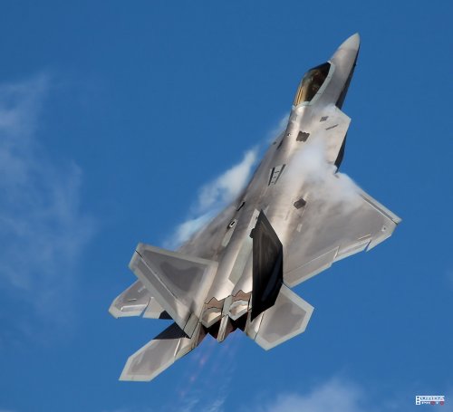

Triton said:
Stephen Trimble mentioned the F-22 photographs of Polish photographer Slawek Krajniewski in his The DEW Line blog. These photos were taken at last month's Royal International Air Tattoo (RIAT) at Fairford, UK and they are just too cool not to share. Enjoy! ;D
URL: http://www.hesja.pl/XPL/galeria/show/181
Source: http://www.flightglobal.com/blogs/the-dewline/2010/08/photos-f-22-as-high-art.html
Very interesting that this aircraft has the rear facing camera mounted. I had thought that was only on the flight test articles at Edwards.
Also looks like they flew on a very humid (and at points rainy!) day. I saw quite a few condensation effects like vortices and Prandtl-Glauert clouds. I was wondering when we would solve the RAM-not-waterproof problem I remember from the F117 days.
quellish said:
It helps with parallel parking in tight spaces.
Are you referring to that thing hanging off the bottom? You sure that's not the RCS enhancement device?
mr.sukhoi said:
great shot!
If you look near the centerline you'll see a cylinder. On the test force air craft this is definitely a camera - I have close up shots of it. I've seen it on operational F-22s, which had me wondering why the heck they would be carrying a rear facing camera!
Turns out the same mount that Edwards uses for the camera, operational F-22s use to mount a radar reflector:
http://www.mayurakshi.net/luneberg.htm
