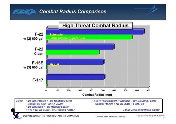

Here's a little bit of mental gymnastics that yielded an estimate of F-22's ferry range.
If we use the same factor on F-22 we get 1454 nm (or 2690 km) of
ferry range
for a clean Raptor without drop tanks.
I am sure there are issues with this calculus but it might shed a bit more light on the F-22 potential ferry range.
No need to guess. Raptor has 1600nm ferry range with two 600-gal EFT.
Like it or not, but in terms of internal fuel and range F-22 is pretty shortlegged bird. Especially in comparison to Sukhoi's new heavy fighters, as Su-35S and Su-57. Probably this is why LM erased this and some other figures from the new version of the Raptor's page on their official website.

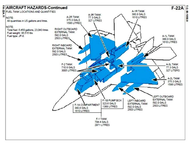

Maximum take-off weight 83,500 lb / 38,000 kg ....
This is a mass with four external tanks, which were abandoned after the replacement of the wing spars.
Maximum take-off weight of the F-22: 19660 kg (empty) + 100 (pilot) + 9367 (fuel) + 3700 (external tanks) + 1744 (weapons) = 34571 kg
with 4 AMRAAMS on the external suspension and 2 external tanks
Internal fuel 18,000 lb / 8,200 kg....
9367 kg !
9367 kg !
Not sure what point you're trying to make. That sheet shows the F-22 having 20,167lbs (9148kg) internal fuel.
