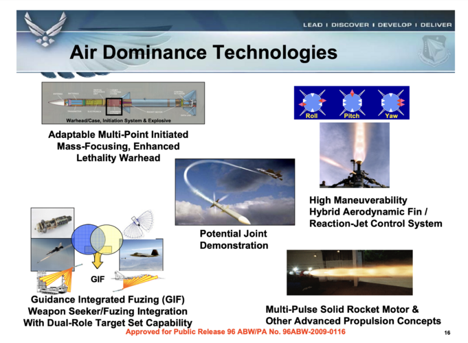

2008 JDRADM > "JATM" posted by ACC along with Sketch by @Shusui > AFRL Air Dominance technologies (circa 2009).
The difference between 7" and 8" is significant. That's 30% greater volume, and 10" is over double 7" volume. You don't need to jump to extremes to have notable benefits. Square cube law is a beautiful thing. I don't see any reason to move this discussion until JATM is revealed publicly.
I suppose you could always grow in size and get better performance in some areas. But there are ways, that I'm sure you are aware of, of doing this without going down that path and ending up with a bulkier missile with integration challenges.
If the rumors and renderings appear to be close to what the actual design is then they have chosen a multi-pulse rocket motor coupled with a very low drag design that screams efficiency. I am also willing to bet that they've shrunk down the WH and guidance volume to allow for more propellant and ended up with a lighter missile overall. If its main purpose is to pop out of a internal bay of F-22 and NGAD then this seems to be the optimal approach.
With a more efficient air breathing VFDR propulsion something like the Meteor or DARPA T3 designs you incur a drag, size (compressed carriage) and weight penalty that would not be the case for the path chosen (last image is that of Meteor) which again points to the F-22 and its replacement (and Navy's FA-XX) as an influential force driving requirements.
Basic reading on google seems to indicate that the move to AESA from a traditional mechanical scan method would greatly reduce both volume and weight of the system's guidance method. Somehow I'm convinced the enhanced target detection device is not going to be lighter than the previous model but perhaps that is a necessity as countermeasure systems are more advanced than ever.
Though a more advanced target detection device could better utilize a smaller warhead.

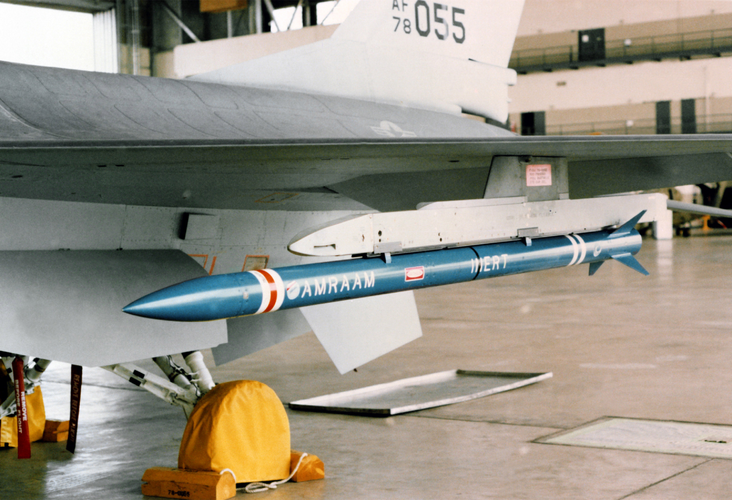

Remember that the AMRAAM was intended to be the same form factor as the Sparrow, and yet it ended up 1" smaller in diameter.
So I wouldn't be surprised if the AIM260 went back up to 8". Assuming equal density, that's a 30% mass increase but still only makes a ~460lb missile. Still lighter than Sparrow, and about equal in weight to Meteor.
