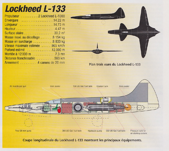

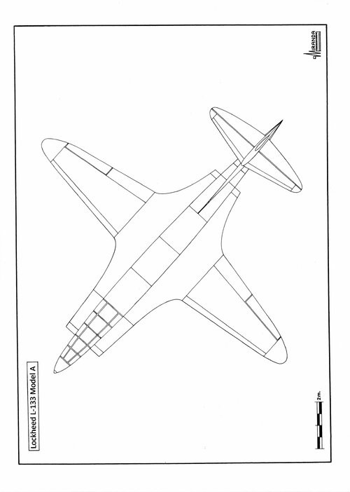

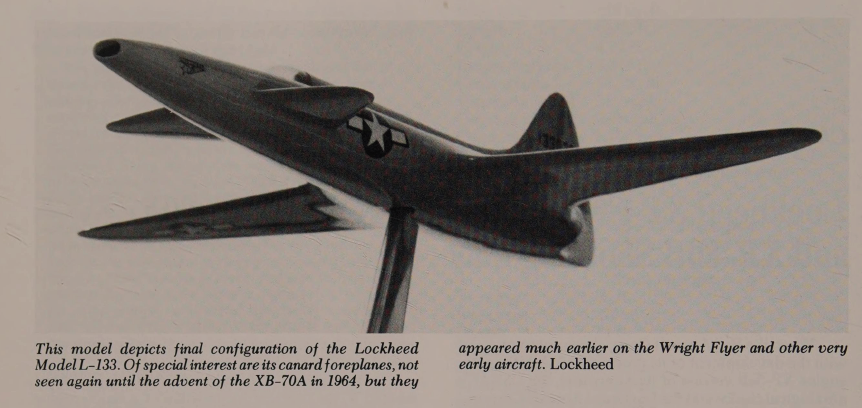

I've never seen this model for the L-133, though admittedly it looks simpler than the other versions. It still looks very advanced and honestly reminds me of the Cutlass (twin tails)
sienar said:
From code one

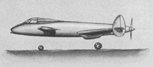

Interesting bit of text with the first pic;
"The L-133 was Lockheed's initial design study for a jet propelled fighter. (...) In evolving the design, Lockheed built a similar, 3/4-scale, propeller-driven configuration (shown lower right). The design effort began in January 1942."
Does anyone know more about the demonstrator? Do any photos exist?
I was just as amazed by this piece of information as you are. Frankly, I'd never even heard of this before...
One can imagine that the work was done in high secrecy and that perhaps all information pertaining to that program has been lost.
Otherwise I cannot see why Lockheed wouldn't willingly share a pic or two of that demonstrator 70 years down the line...

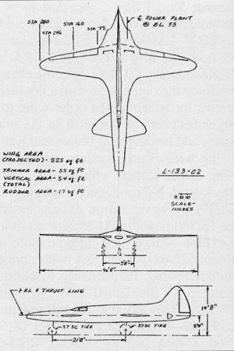

A clue to the missing link here is provided in AAHS Journal Vol 44 no. 1, in "The Lockheeds that Never Were" by Bill Slayton. Two Lockheed drawings, labeled L-133-02 and L-133-5, are reproduced. Slayton writes re L-133: "To test the general configuration, a similar but smaller propeller-driven aircraft was built and successfully flown in late 1942." As you see, the "L-133-5" bears a certain resemblance to the Curtiss CW-24B. I'm thinking Lockheed bought data from Curtiss rather than build their own testbed.
--Ian

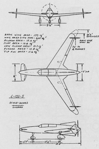

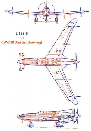

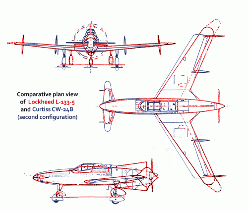

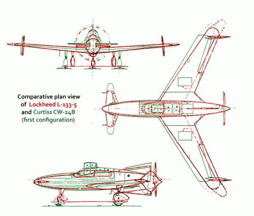

I have attempted to compare the L-133-5 and the CW-24B and to determine whether there were more commonalities than differences. Please note that I didn't try to put both plans in the same scale but to make the shapes coincide as best as possible by retaining the fuselage length from one end of the thrust line to the other.
First image compares the L-133-5 with the CW-24B in its first configuration (definitely the closest) while the second image compares it with the modified one.
The general configuration of the two designs are remarkably similar. Here is a small recap of what's different and what's the same:
DIFFERENT
  • Completely different canard shape
  • Greater wing sweep on the L-133-5
  • Narrower wings on L-133-5
  • A little more dihedral on L-133-5
  • Slightly longer wings on the L-133-5
  • Rounded off wing tips on the L-133-5
  • Fuselage considerably narrower on the L-133-5 and presenting a circular section
  • Wing roots blend into fuselage on CW-24B, not on L-133-5
  • Wing roots of L-133-5 more cranked on trailing edge
  • Wheels of main undercarriage closer to fuselage on L-133-5
  • Higher undercarriage on CW-24B
SAME
  • General configuration
  • Fuselage rear fin shape and arrangement, extending above and below fuselage in a trapezoidal shape
  • Eye-like shape of wingtip fins
Despite the many small differences, the commonalities are so obvious that it is more than likely that the two projects are two close stages in the same development phase. The Lockheed plan seems earlier and less thought out than the Curtiss one, which corrects issues such as insufficient height of undercarriage and size of cockpit.
Either Lockheed got wind of Curtiss's efforts and copied their design or (more likely) this is simply Lockheed allocating dash numbers, within a general "L-133" project, to noteworthy competing programs, as Orionblamblam showed us was current practice at Lockheed a couple of days ago in another thread.
Besides, the Lockheed document posted by CodeOne shows a different bird. Therefore I believe there were both a Curtiss prototype and a Lockheed prototype (both company-built and unrelated). There is NO indication that L-133-5 was the configuration of the built prototype, is there, Apteryx?
Because if there was, and the L-133-5 was the final configuration chosen by Lockheed for their prototype, we should therefore consider that the CW-24B was initially a Lockheed product that was passed over to Curtiss!!! I don't personally see this as very likely, if only because the design evolution of the CW-24B through the P-244 and P-249 design proposals is well-documented. Thoughts, anyone?

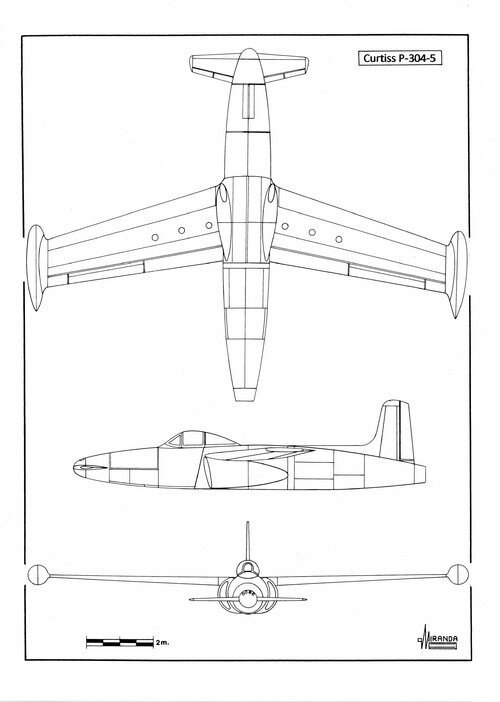

P.S. Curiss had it's on jetpowerd canard designs in the P-304-4 and P-304-5 concepts of March 1945.

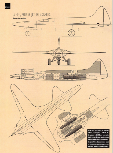

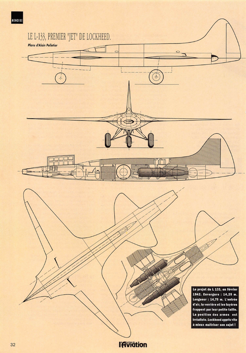

Original Lockheed's cutaway of L-133 ca.1941
Lockheed Horizons, Issue 8

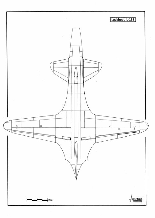

Am I correct in my understanding that the L-133-5 has nothing to do with the L-133 Jet Fighter?
I'd really love to see more detailing of the main landing gear arrangement.
It's apparent that the main wheels pivoted together on a sort of trapeze affair that then folded itself into the fuselage. It was anything but conventional and more reminiscent of the method the F/B-111 uses.
Yet, details of it are pretty scarce.

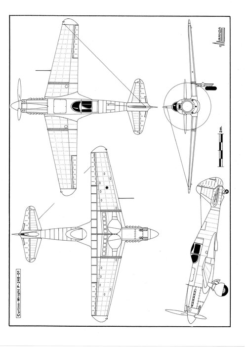

Curtiss proposed the P-248-01design, an Allison powered CW-21 Demon and the CW-24, an unorthodox tailless-canard fighter, with 45 degrees swept-back wings and pusher propeller.
Around fifty projects were presented by nine different companies. By the end of 1940 six of them had been selected: Vultee (XP-54), Curtiss Wright CW-24 (XP-55), Northrop (XP-56), MacDonnell (Mod 1), Republic (AP-12) and Bell (Mod 13).

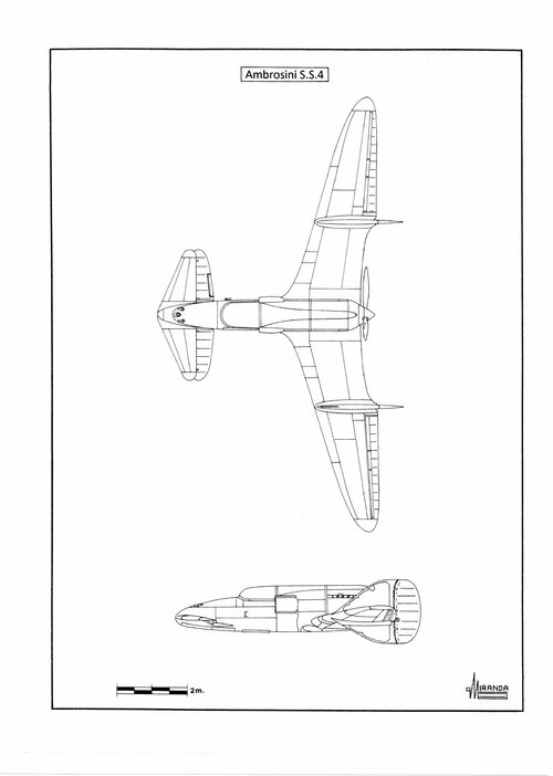

Early in 1939 the Italians built the Ambrosini S.S.4 a canard prototype fighter powered by one 960 hp Isotta Fraschini Asso XI RC.40 engine. The airplane was destroyed in 1941 due to a problem of vibration of the engine mount and the project was cancelled.

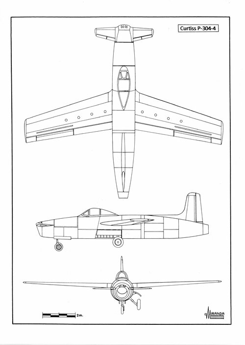

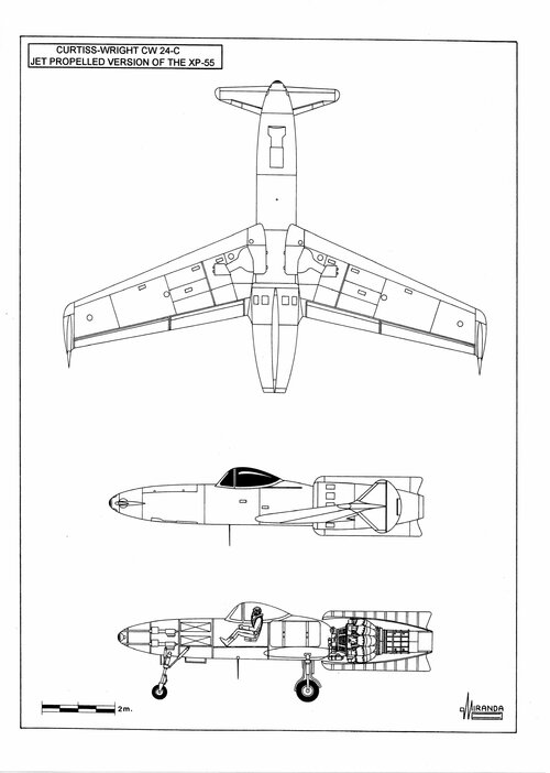

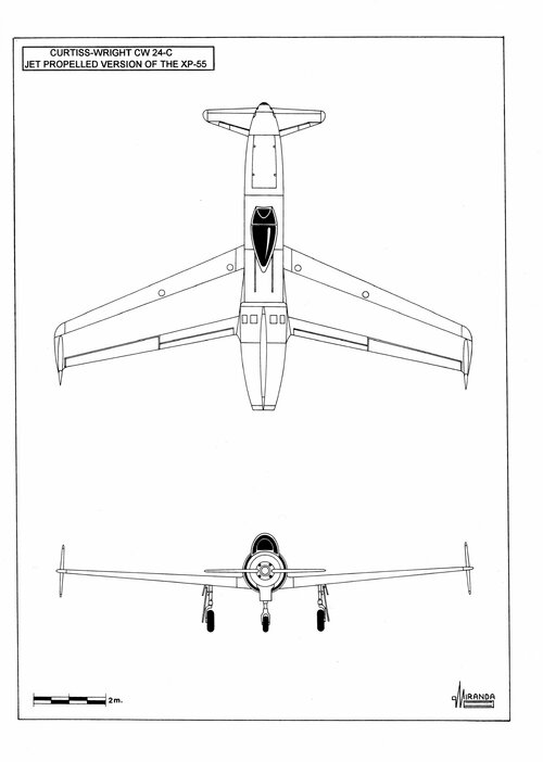

Before cancelling the project, the Curtiss firm proposed the production of a jet version based on the original P 249-C project, known in the specialized literature as P 286-17 or CW 24-C. It would have been propelled by a centrifugal De Havilland H-1B Goblin turbojet with a fuel tank of 1,059 lt., located behind the pilot, and armed with four 0.50 cal M2 machine guns. Its mass production was abandoned in favor of the Lockheed P-80.
On 31 March 1945 Curtiss proposed two versions of the P-304 a single-jet, medium-range fighter specifically designed to overcome the effects of compressibility, using the accumulated knowledge from the XP-55 programme.
Curtiss CW 24-C technical data
Power plant: de Havilland H-1B Goblin turbojet with 2,460 lbs (1,114 kgf) static thrust.
Wingspan: 39.36 ft (12 m), length: 28.10 ft (8.57 m), height: 9 ft (2.74 m), armament: four 0.50 cal M2 heavy machine guns.
Curtiss P-304-4 technical data
Power plant: one General Electric TG-180 turbojet with 4,000 lbs (1,814 kgf) static thrust.
Wingspan: 40 ft (12.2 m), length: 33.8 ft (10.3 m), height: 9.5 ft (2.9 m), wing area: 240 sq. ft (21.6 sq. m), max weight: 14,470 lbs (6,564 kg), armament: four 0.50 cal M2 heavy machine guns.
Curtiss P-304-5 technical data
Wingspan: 40 ft (12.2 m), length: 33.4 ft (10.21 m), height: 9.5 ft (2.9 m), wing area: 240 sq. ft (21.6 sq .m), estimated max speed: 622 mph (1,001 kph) at 10,000 ft, estimated climb rate: 5,530 ft/min, max weight: 14,170 lbs (6,428 kg), combat radius: 500 miles (805 km), armament: four 0.50 cal M2 heavy machine guns.

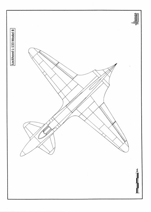

In 1939 Lockheed Aircraft Co. started the design of the first U.S. jet fighter.
The new airplane was powered by two Lockheed L-1000 turbojets with axial-flow compressor, intercooler, multi-stage turbine, 5,100 lbs (2,310 kg) static thrust and 6,700 lbs (3,035 kg) with afterburner.
The design team proposed three possible configurations: Model A, with the engines buried into the wing roots, Model B, with the engines housed in mid-fuselage and Model C, with the engines mounted in the rear fuselage.
The L-133-02-01, a variant of the Model C, was proposed to the USAAF on March 1942.
The L-133 had stainless steel airframe and 6 per cent thickness/chord wings, with hydraulically-assisted control surfaces and slotted flaps.
The engines would be fed by two long ducts emanating from the nose air-intake and four suck-in inlets were located above and below of the turbojets for laminar-flow control.
In 1942 the L-1000 turbojet was technologically superior to the centrifugal engines of its time, but harder to manufacture.
Lockheed facilities are not adequate for engineering and manufacture of turbojets, in 1943 the USAAF transferred the development of the L-1000, as XJ-37, to Menasco Manufacturing Company and Wright Aeronautical Corporation.
The low-priority of the project delayed the development of the XJ-37 that never materialized as a production turbojet.
L-133 technical data
Power plant: two Lockheed L-1000 axial-flow turbojets with 5,100 lbs (2,310 kg) static thrust, wingspan: 46.7 ft. (14.22 m), length: 48.3 ft. (14.22 m), height: 14.7 ft. (4.47 m), wing surface: 325 sq. ft. (30.19 m), maximum weight: 18,000 lbs (8,154 kg), estimated maximum speed: 612 mph (985 km/h), estimated ceiling: 40,000 ft. (12,200 m), range: 310 mls (500 km) with 500 gallons of fuel housed in three fuselage tanks, armament: four nose mounted 0.50 cal machine guns with 400 rpg. or four 20 mm cannon with 60 rpg.
In June 1943 it became clear that the development of the L-1000 axial-flow engine required more time and resources than expected and that the prototype would not be available until June 1946. The Lockheed design team began work on a new version of the L-133 fighter powered by one British centrifugal turbojet.
Knowing the poor results obtained by the Curtiss XP-55 during flying tests the USAAF decided not to accept any other canard design and the L-133 configuration was dropped in favour of the L-140 project, with conventional airframe and the laminar-flow wings of the L-133, under the designation XP-80.

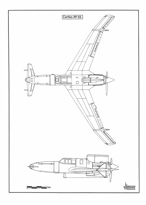

Regarding the XP-55; once upon a time, some 40 years ago, I used NACA's wind tunnel data on this aircraft for my graduate Stability and Control course and my final conclusion was "Damn, that one was dangerous to fly!" A lot of the data clearly showed that.
Many years ago, while on a research trip, I heard a story from someone who will remain nameless but I am still confident would indeed be in a position to know.
It appears that test pilot Tony Levier hated the XP-55 so much that for years afterward when visiting Washington, DC he would make a point of going to see the XP-55 in storage and and kick the aircraft's fuselage because it was such a dangerous and difficult aircraft to fly.
Now, I don't know with absolute certitude that this story is true, but it certainly seems to fit the circumstances, the nature of the aircraft, and it is a delightful story nonetheless.
Submitted for your amusement,
AlanG
Rutan said the XP-55 had the neutral point shift forward close to stall.
