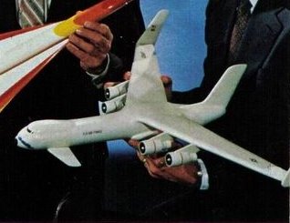

Speaking of Lockheed tanker concepts, what about this nuclear powered one
I would have thought that by 1979 everyone would have been done with nuclear powered aircraft as a concept that just was too complex and costly to be practical.
Too late ! Still during the '60s, nuclear powered aircraft could have been brought into service (if technologically
and economically feasible), but during the '70s, with its rising ecology movement, only States lke the SU, which
still kept their people firmly in hand, could have fielded such aircraft. In the western world even the costs for the
then necessary police operations, to remove protestors from the runways, would have been prohibitive !
