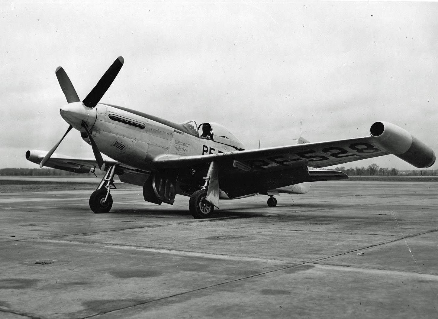

And to amend my mistake, here is another illustration of the definitively non-supersonic Ramjet Mustang (twin Marquardt engines that might have been a blast to fly with asymmetric thrust at the wing tips (!).
P-51D, 44-63528. A Marquardt XRJ-30-MA

Note that when Beguine was converted re-using the Marquardt pods (allegedly), it´s possible that they didn´t take into account the added extra mass and inertia that came with the installation of a radiator relatively to the emptiness of a ramjets (that are essentially a hollow tube with a flame holder and a spray bar). I am willing to think that the sudden roll divergence originated from some wing warping effects instead of the explanation given in link pointing to disturbed airflow in the absence of a filet. IMOHO, the fact that this manifested mostly with abrupt roll command is a clear enough sign. It´s even probable that the Marquardt airframe was roll restricted and that information was lost to the Beguine team.
Am almost 100% certain those are Marquardt rj- 20s. The 30" diameter engines would be way too heavy for the spar.
According to your posts and attached pictures in that thread, this is highly probable. The shape of the Marquardt engines matches the rj-20 outer lines more closely.
Good catch!
Good catch!

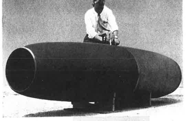

The p-51 wing spar wouldn't be able to support the weight of the RJ- 30 which weighed over
330 lds. and was over 11 feet long.
The P-80 was only able to test the xrj 30s for 1 minute...per short supply of fuel. 1 minute for engine warm up, then 1 min test at full fuel flow.

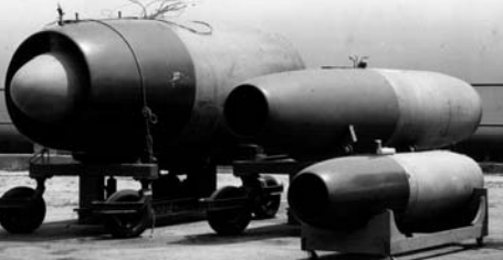

Here are the original 3..and that man sort or indicates the size of the xrj 30.
