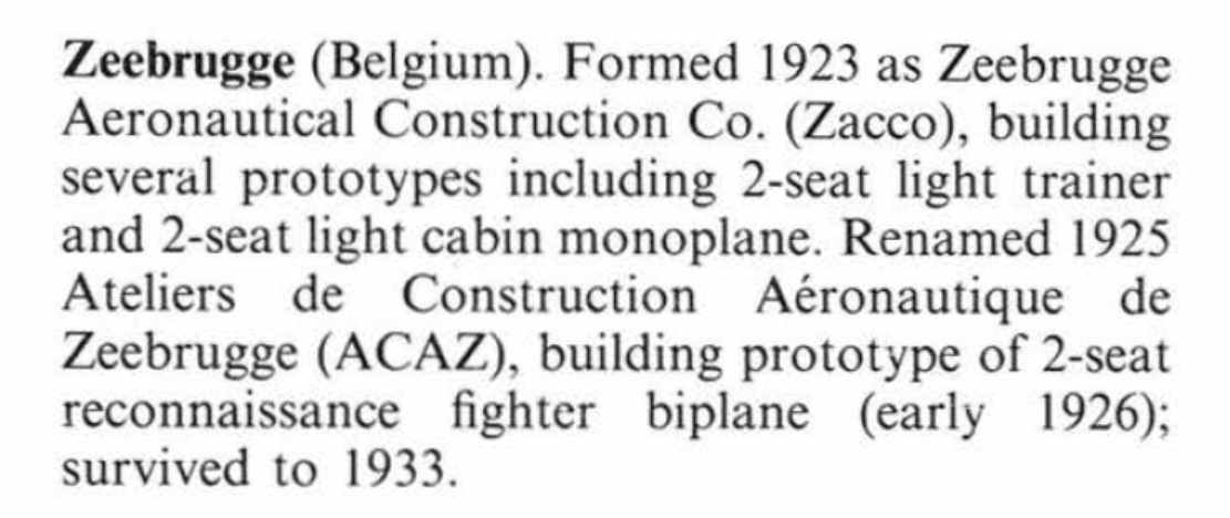

Of course I agree with that,but the T.1 or T.2 were NOT a light trainer at all ?!,so Mr. Bill Gunston
was very specifically to distinguish it from T series.
Okay, "NOT a light trainer at all ?!" Since your style there seems to indicate absolute certainty, can you provide evidence?
Any kind of certainty about obscure firms like ACAZ would be most welcome. Do you have an exact quote from Gunston?
I would be the first to agree that an aircraft like the T.2 is better described as a 'tourer'. However, similar lightplanes have often been described as 'trainers' - even by you in the past, my dear hesham. Anyway, we can debate usage and nomenclature but actual evidence must always trump :)

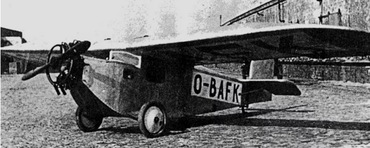

Yes, the T.1 was O-BAFK (and the T.2 was O-BAFM/OO-AFM).

the aircraft in number "1" is from the video,it was the T.1 of 1923,BUT the
Renard R-5 was not displayed in any where,and the aircraft was in 1920 ?!.

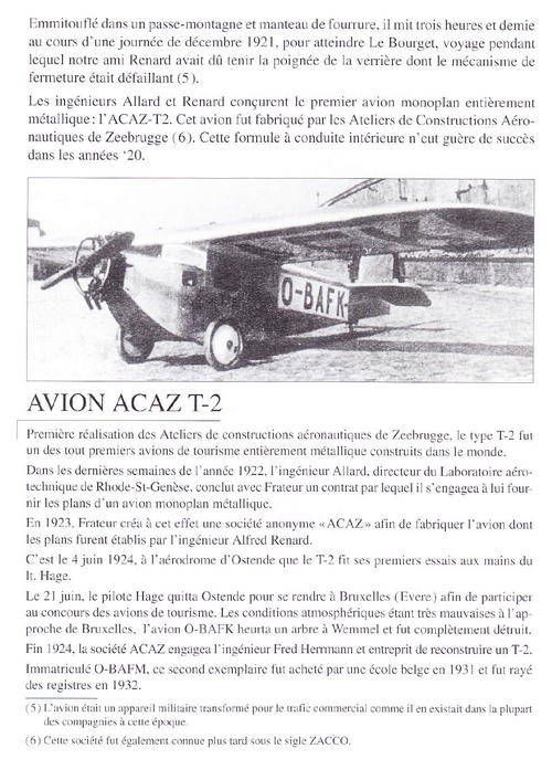

Just for the info :
.Avion A.C.A.Z. T-2 ..... fut un des tous premiers *avions de tourisme *
entiérement metalique dans le monde.
source : page111 (annexe2) Les Avions Renard- Andre Hauet
Thanks lark. Good to see the original. There are plenty of claims on the internet that the ACAZ T.2 was "the first all-metal airplane". Your Andre Hauet quote makes clear that this Renard/Allard design was the first all-metal tourer.
