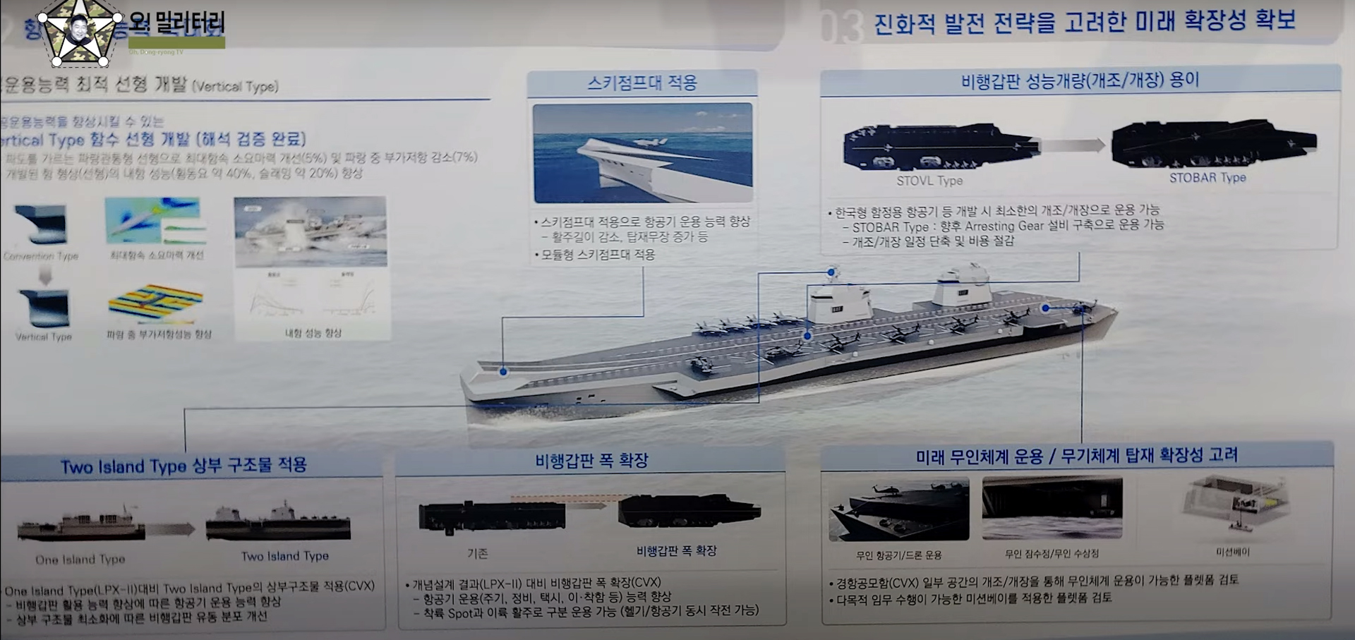

Interesting. Maybe it's just from trying to look at it on my phone, but the design looks like it has a provision for a full angled deck should S Korea choose to go that route in the future
The Reddit thread includes some quotes from the designers stating exactly this -- it's meant to have the option of an angled deck if desired.
Not sure that extends to a catapult and arresting gear, though. But an angled recovery deck could facilitate rolling short landings as well.
its still the same design posted months earlier
there is a angled version if you see on the bottom i
if they decide to do a stobar type
Interesting. "Angled deck" and "CATOBAR" are no longer 100% related. In other words: lessons drawn from angled decks since 1953 could also be applied to non-CATOBAR carriers.
F-35Bs would roll and land on the angled deck with others parked a safe distance away... this lesson remains valuable even without cats and traps.

there are two twin island designs (see page 2) including the tonnage, which is around 45000

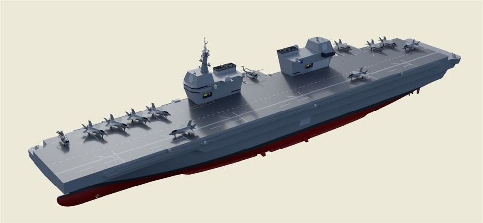

It isn't needed. The deck has 3 "lanes". There is a landing lane on the left, a take off lane in the middle, and a parking lane on the right of the deck. You only really need an angled deck to prevent crashing into parked aircraft and allow for bolters if the pilot doesn't catch the wire. It turns a one lane flight deck into a two lane one. On a STOVL carrier I think the QE design makes more sense, although a slightly prefer the Dual Tramline LHA(X) design that puts the parking (and islands) in the middle.
The Brits have had this three lane idea for a while. If you look at CVA01 it has a 3 degree angled deck (practically axial) hugging the port side, a catapult on the starboard side, and room for parking in between the two.
Cavour isn't wide enough for three 'lanes', it uses the same lane for takeoffs and landings, but it has a separate parking area to the right of the runway. Unless ROK decides to build something QE sized they will likely end up with something like Cavour or Juan Carlos in layout, with a combined landing and takeoff lane on the port and deck park to the right of the lane.

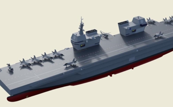

The 2-island DSME design is 263m long and displaces 45,000 tons… so more Charles de Gaulle/Essex size than Clemenceau.
Flight deck parking for ~16 F-35Bs and hangar parking for ~12 F-35Bs so with the usual density factors a total air group of 20-24 fighters sounds realistic (plus 4-6 helos).
