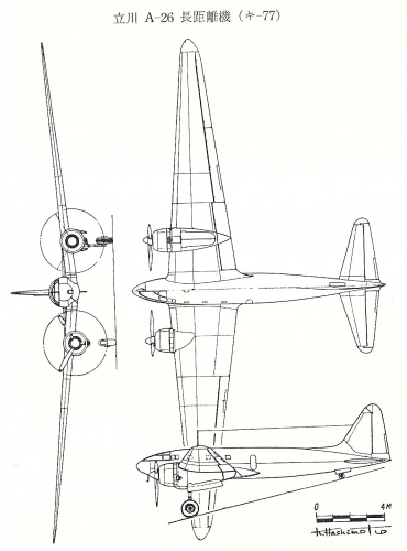

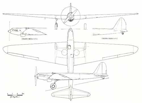

Yes Ed! Very good point. We must take care about the wing shape of Ki-77(A-26) and Kokenki because they were Professor Hidemasa Kimura's design same as TB.
Please take care about wing leading edge sweep back angle and wing trailing edge sweep forward angle.
I feel A-26, Kokenki and TB had same angle. If so we can imagine TB's wing shape easily , because we already know the wing area and span of TB.
