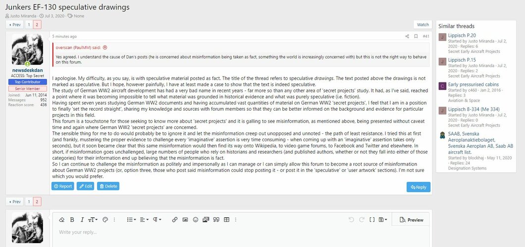

Yes agreed. I understand the cause of Dan’s posts (he is concerned about misinformation being taken as fact, something the world is increasingly concerned with) but this is not the right way to behave on this forum.
I apologise. My difficulty, as you say, is with speculative material posted as fact. The title of the thread refers to speculative drawings. The text posted above the drawings is not marked as speculative. But I hope, however painfully, I have at least made a case to show that the text is indeed speculative.
The study of German WW2 aircraft development has had a very bad name in recent years - far more so than any other area of 'secret projects' study. It had, as I've said, reached a point where it was becoming impossible to tell what material was grounded in historical evidence and what was purely speculative (i.e. fiction).
Having spent seven years studying German WW2 documents and having accumulated vast quantities of material on German WW2 'secret projects', I feel that I am in a position to finally 'set the record straight', sharing my knowledge and sources with forum members so that they can be better informed on the background and evidence for particular projects in this field.
This forum is a touchstone for those seeking to know more about 'secret projects' and it is galling to see misinformation, as mentioned above, being presented without caveat time and again where German WW2 'secret projects' are concerned.
The sensible thing for me to do would probably be to ignore it and let the misinformation creep out unopposed and unnoted - the path of least resistance. I tried this at first (and frankly, mustering the proper evidence to challenge every 'imaginative' assertion is very time consuming - when coming up with an 'imaginative' assertion takes only seconds), but it soon became clear that this same misinformation would then find its way onto Wikipedia, to video game forums, to Facebook and Twitter and elsewhere. In short, if misinformation goes unchallenged, large numbers of people who rely on historians and researchers (and published authors, whether or not they fall into either of those categories) for their information end up believing that the misinformation is fact.
So I can continue to challenge the misinformation as politely and impersonally as I can manage or I can simply allow this forum to become a root source of misinformation about German WW2 projects (or, option three, those who post said misinformation could stop posting it - or post it in the 'speculative' or 'user artwork' sections). I'm not sure which you would prefer.

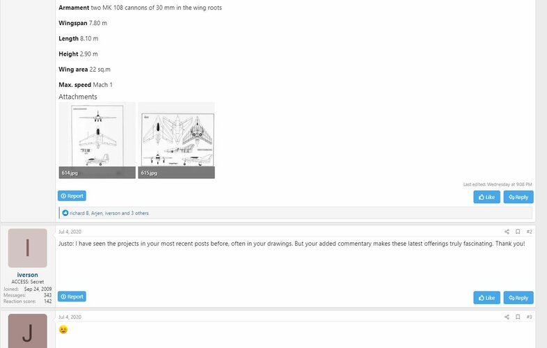

* See attached 'Similar threads'. You will note three of the five 'similar threads' presented to me this morning are on the projects of Alexander Lippisch. Looking at those three threads, all contain speculative text and speculative drawings. None are marked as such. They have gone entirely unchallenged, having been posted at a time when I was attempting to ignore such misinformation. I would argue that all three should be in the 'speculative' or 'user artwork' sections.
* Also attached 'P 15'. Here my sternest critic from the thread above has read misinformation presented about Lippisch's P 15 and been impressed by it. "Your added commentary makes these latest offerings truly fascinating, thank you!" As I said, if misinformation presented as fact, without a 'speculative' tag, goes unchallenged, people end up believing it.

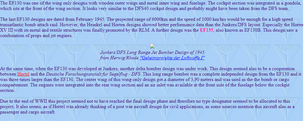

In my files,
we must to know the first purposed of EF.130 was to have a single engined,
and it was Heinkel HeS 011,also with its flying wing shape,and that happened during 1943/1944 ?.
Here is the source from a site about Junkers,
please note the EF.130B was also called EF.135 ?.

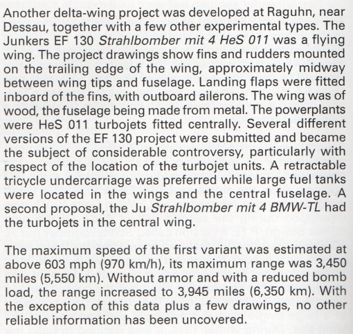

There is no easier way to say this - even according to his own publishers, Herwig is not a reliable source. They actually say this in his own books(!). For example, the English language version of his Luftwaffe Secret Projects - Ground Attack and Special Purpose Aircraft says (p7 of the 2004 'second impression'):
"During the course of the translation of the German original of this book into this English version, our translator Ted Oliver carefully studied the material as supplied and published in the German, and with our approval, has made some significant changes in sequence and content which we believe enhance the readability, accuracy and completeness of the finished German article."
Further down, after talking about the jumbled order of Herwig's material, it says:
"Throughout the book, Ted Oliver has taken the opportunity to eliminate some obvious contradictions in the German original, and to add to or improve information by using sources (principally captured German document sources in the UK and the USA) which were apparently not available to the author. In some instances the extent of the additional material available to the translator has necessitated more extensive additional text. Numbered footnotes are almost all translator's remarks and necessary explanations. These also provide commentary on the author's erroneous text repeated from sources known to be incorrect or speculative."
And I can tell you that as much as Ted Oliver has done his best to fix Herwig's work - much of it is still at odds with the known evidence.
So I refer you back to Post #5. That is the only known source material on the EF 130. As tempting as it is to extrapolate additional versions of the EF 130 or to guess at what might have been, the bottom line is that the EF 130 is only known from those two sources, which you now have in full. I would love for additional primary sources to appear but I suspect that they won't.
