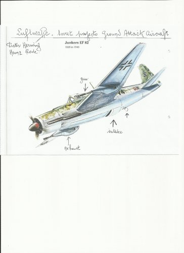

I have an illustration and scale model pic, both on Page 33 of Luftwaffe Secret Projects G round Attack and Special Purpose Aircraft by Dieter Herwig and Heinz Rode.

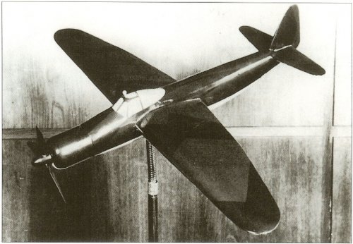

i needed the confirmation on ground attack and dive-bomber
i got only one picture of the Ju EF 82 scale model (from 1940?)
source: Junkers GMBH

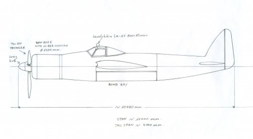

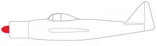

In the meantime....advice essential please.
First effort attached.
many thanks.
P

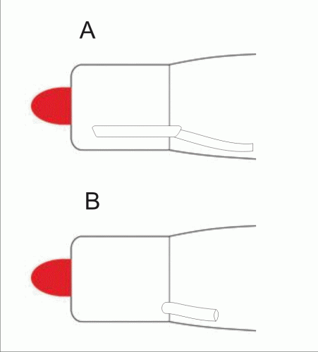

This probably was the EF 65, the forerunner of the EF 82, judging the text, which probably is based on the "Luftwaffe
Secret Projects" book. A model of the EF is offered via eBay. I've still difficulties in understanding, what is meant
with the "two exhaust stubs", or I should rather have written "exhaust pipes". What can be seen on the pictures,
to my opinion just is something like a flame dampener, or exhaust collector, not unusual at all, I think.
To me "two exhaust pipes" would mean something, as used for radial engines ( B ).

In the model pic, I can see the fuselage is much longer and more rectangular in cross section than my poor effort.
Back to Freehand....
P

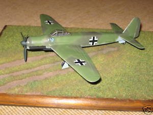

I think, you shouldn't put too much faith in this model ! It's made from a Bird model kit,
but I would trust rather in what seems to be a manufacturers model, although it quite
probably isn't really a windtunnel model, as the prop and the camo wouldn't make any
sense. And honestly I cannot remember having seen other German desktop models from
that era before. But maybe someone modified a windtunnel model later ?
Yes there were desktop or display models built in Germany during WW II. When going through the photo archives of JFM , several have shown up.
Best regards,
Artie Bob

Wow...many thanks...
This is beginning to take shape and it definitely points me, once again, in the right direction.
Many thanks
P

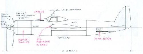

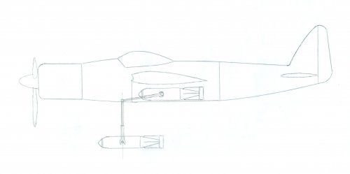

Just what the Doctor ordered.
Many thanks again Justo.
P

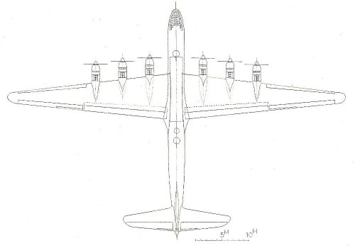

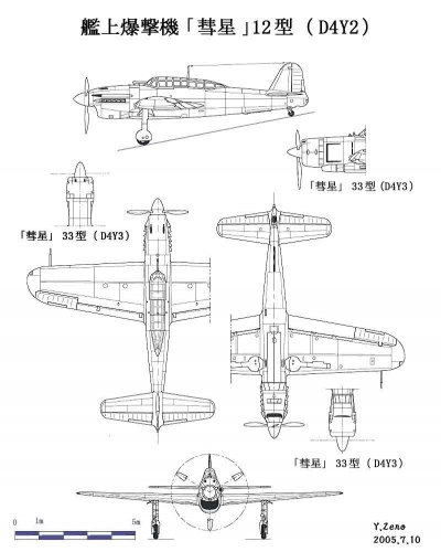

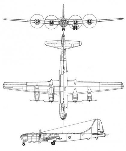

toura said:
Hi Flitzer and Justo
I think this drawing's bomb bay position is correct.
Bomb bay center, air center(1/4 MAC) and center of gravity seems to be almost same position for me.
Thanks Justo!
I think Suisei's bomb bay center, air center(1/4 MAC) and center of gravity seems to be almost same position for me,too.

I notice there is a small shallow intake aft of the bomb-bay doors on the illustration from the Luftwaffe Secret Projects book.
What would this feed so far back from the engine?
Where would this fit on with Justo's side view, same place?
Many thanks
P
As long, as the Jumo 214 wouldn't have been fitted with a supercharger, I really don't know !
And to my opinion, a supercharger wouldn't make much sense for an attack aircraft, as it
would mainly fly at lower altitudes.
I would rather trace this detail back to "artistic freedom" ... :-\
Thanks Jens...
I was hoping someone would say this.... :)
P
What if this intake is not for supercharger, but for cooling the engine radiator ?
The Jumo 214 was an inline-engine, so much we know for sure, I think, although details aren't available
still yet. But I would think, that it was similar to the Jumo 211 or 213. This relationsship and
the appearance in the model suggests, that it would have used a radial radiator for the pressurized
cooling system, that made for a relatively compact engine, reducing frontal area and easing
engine replacement. A radiator placed elsewhere in the aircraft would have spoiled those points,
I think.
And a look on Justos drawing, showing the bomb bay makes clear, that any ducting to the engine
would have met difficulties, contrary to, say the Mustang, which, as a fighter had a lot of "empty
space" in the fuselage.
