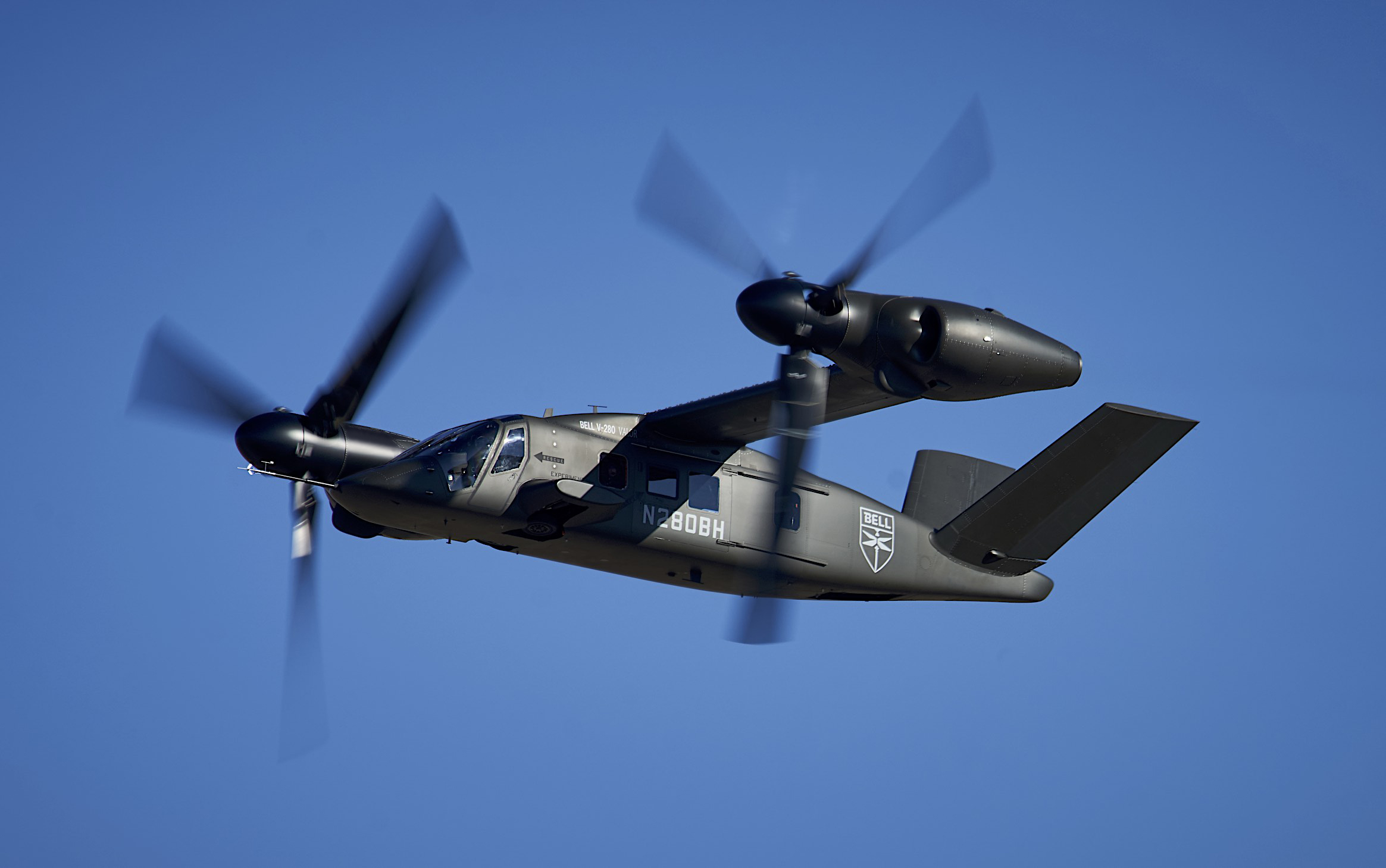

I like the solution for the coming capability gap between the US Army and NATO: buy some of our tilt rotors and we all win.![]()
Tiltrotor: The need for speed & range in response to global threats - Breaking Defense
With range and speed, the tiltrotor enables operations in dispersed locations, safe from most long-range fires and threats that make current assets vulnerable.breakingdefense.com
Bell Flight sponsored piece, but it does give you some insight into the rational they have been given by the DoD.
Said every vendor since the dawn of time.I like the solution for the coming capability gap between the US Army and NATO: buy some of our tilt rotors and we all win.
I mean, it's not wrong. How much of a transformation was having your troops delivered to the battlefield via helicopters in Vietnam?I like the solution for the coming capability gap between the US Army and NATO: buy some of our tilt rotors and we all win.

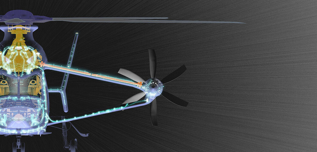

Racer is a compound helicopter with a somewhat novel antitorque solution instead of a tail rotor. It's fast but I don't know about how much range it has.Racer didn´t even made half a dozen of flight and we know nothing about the opened flight envelope or anything that concerns reliability. I think it´s pretty premature to even call it a solution, least, the better.
One good step for the future of NATO would be to not consider anything that flies out of Airbus or Leonardo shops as a machine of war. Racer wasn´t even though to have any utility in the military context.
Airbus claims a 25-35% range improvement for Racer over a conventional helicopter, depending on speed (180-220 knots). Scale that up to Valor’s 31,000lb take off weight, which is heavier than an S92 (27,700 lb TO weight, 750nm range), and you’re looking at potentially 1,000nm+ range for a troop transport using Racer technology, as a rough ballpark.It's fast but I don't know about how much range it has.
Yeah, and that's exactly where the bullets will fly... In the novel anti-torque rotors... Let´s hope the platoon's kids enjoyed their carousels rides.Racer is a compound helicopter with a somewhat novel antitorque solution instead of a tail rotor. It's fast but I don't know about how much range it has.
?? The Racer nacelles’ IR signature will be negligeable compared to a tilt rotor’s 6,000hp wingtip exhausts.Then there is the manpad aspect and the rise in IR emission from the nacelles.
I thought Bell would want to insource it, but the general consensus here was that they would have to partner with someone. It's just a fuselage. Bell can handle it.The most likely decision clearly. "If you don't own something, you don't control it."
Nope. Unload the rotor to ~20% of the lift and dump all that horsepower into the pusher props. Let's say Racer makes a total of 4000hp, and ignoring the amount used for antitorque means that the rotor in high-speed mode will only soak up about 800hp, while the props are pushing 1600hp each, give or take.No, no... Tilt rotors have direct cross shafting (mechanical). You see the difference here?
Bullet impact is also a function of the rotors area and blade number. Here we have an aggravated surface area, augmented blade number, that favorably increase the chance of a bullet hit.
The largely decoupled torque rotor is also a burden that a military version would have to carry for not much. Airbus widely separated the torque engine nacelles to favorably impact the power needed (lever arm), and aerodynamic purity of the rotors, since their priority was power efficiency with a system that is intrinsically not efficient to fly slow or fast (3 rotors instead of 2 or 3). They also choose oddly to have two anti-torque nacelles instead of only one, something that was possible but required higher power being redirected to the anti-torque, something that would have rationally lowered the max speed.
What increase in IR from the Racer's nacelles? There's no engines in there, just gearboxes.Then there is the manpad aspect and the rise in IR emission from the nacelles. How would that be managed without negatively influencing the overall performances (you add weight and Drag away from the main rotor axis and build unwanted redundancies by multiplying the IR treatment hardware that needs to be installed)?

First battle is just getting FLRAA through the various design reviews without getting derailed by the customer and then built/flying.‘Never done before’: tiltrotor technology and the future battlespace | Shephard
In conversation... Bell's Frank Lazzara talks to Shephard's Gerrard Cowan about the potential of tiltrotor designs to revolutionize U.S. Army maneuver operations, and how the technology could transform other mission sets across DoD and international armed services.www.shephardmedia.com
Nothing overly new here, but it certainly gives you a feel for where Bell would like to go with the program.
100%First battle is just getting FLRAA through the various design reviews without getting derailed by the customer and then built/flying.
Most convincing part of the pro-FLRAA argument:A well written article that articulates some of the critical aspects of the program.
However, I'm not sure I buy the idea of transformational tactics such as risky unescorted "hit & run" raids behind enemy lines... sounds like the much vaunted and epic failures of AH-64 Apache raids in Iraq, this time using light infantry instead of gunships. I'm pretty sure interdiction is better left to long-range artillery and the air force.The vulnerability of forward deployed assets has long been an issue. Western planners have traditionally assumed that their battlefield rotorcraft (Find, Lift, and Attack) would be located relatively close to the front lines. This was to enable their relatively slow transit speeds and endurance, when compared to a tactical jet aircraft, to be somewhat mitigated, as well as conferring an element of mobility and unpredictability over their location.
In future campaigns, even if 90% of the drone threat is eliminated, it only takes one to discover a flight site in the field, or a single careless radio transmission to be detected and geo-located. The 'God of War', artillery, has certainly been 'back' in Ukraine and as detection and targeting into 'the deep battle' improves, enhancements to long range fires (tube artillery, rockets and UAVs/Loitering munitions) have followed, and enabled the traditional sanctuary areas afforded to helicopters to be held at risk.
FLRAA offers the Army, and other purchasers, the opportunity to keep their assets well back from the front line and the concomitant risk of detection and destruction. The sheer speed, range and endurance of the V-280 design will permit FLRAA to deliver the same effect on the battlefield from a base of relative safety, well behind the lines.
In fact, the aircraft's speed around the battlespace will actually enable more to be done in the same operating period and increase the tactical area it can influence significantly over the UH-60. Potentially, FLRAA assault units could now reach into the enemy's rear areas - allowing for destabilising 'hit and run' raids and the targeting of those key logistical bottlenecks - all in addition to flying faster and 'smarter' than legacy platforms thanks to MOSA optimised battlefield SA. Speed and 'smarts' offer appreciable gains in terms of survivability and mission success.
With SOCOM requirements being considered during the FLRAA design phase, we'll see armed variants at some point with missile racks and ALE launchers. No Apache needed unless you really want that 30 mm cannon.Most convincing part of the pro-FLRAA argument:
The Apache 'deep attack' is almost as hard to put to rest as the Cavalry charge.Most convincing part of the pro-FLRAA argument:
That is my thought as well. One has to remember that once you put people on the ground you have to supply them until ground elements link up. Short dwell missions like raids might risk deeper operations, but again it will be a larger effort than just trying to sneak a battalion of Apaches across the front lines.In other words, 'Shallow Strike' may be back in fashion, at least for the moment.
A potential niche for a revived Ground X-Vehicle perhaps?That is my thought as well. One has to remember that once you put people on the ground you have to supply them until ground elements link up. Short dwell missions like raids might risk deeper operations, but again it will be a larger effort than just trying to sneak a battalion of Apaches across the front lines.
But to what end? No need for lower drag. Reduced vulnerability to ground fire during direct attack is unlikely to be the reason as the wing/nacelles stay the same and I really doubt we'll see one with a 30 mm cannon taking on tanks. A modern, dedicated attack tiltrotor is more likely to be a modified fuselage with a large internal capacity of ALE and weapons to be ejected through the sides/bottom of the fuselage with that extra weight paid for by removing external load capabilities, troop provisions/protection, etc. I suspect we'll see some basic weapons hard points on the wings of all FLRAA, but I would expect more out of a dedicated attack ship.I still expect a narrow-fuselage V280-based attack tiltrotor, kinda like a manned V247.
