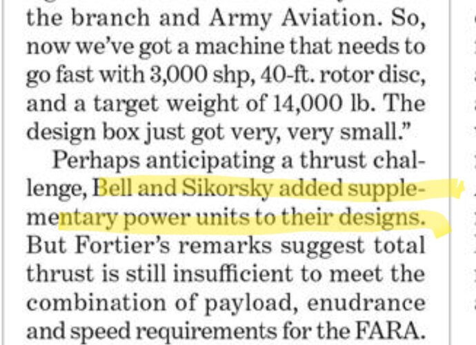

@yasotay : As far as I know only Invictus makes use of a Supplemental Power Unit (PW207D1, 439 kW).
I recall an article late last year where Sikorsky admitted to also implementing a variant SPU system, but I think it was behind a paywall and I am now having a hard time locating it.
The FARA has enough challenges with performance, to the point that while neither has "two" engines, both have "supplemental power units", likely to allow them to get to the mandated cruise speed of 180 knots.
I couldn't find a single Google match that would backup your claim... other than your post ;)
Do you have access to this?

I think the article may have been removed
No, I think something is wrong. I cannot access the current issue of AWST either.
Strangely, it works when I go directly to the AW archive. And I've found the article and quote you were looking for:
However, I also found an article from another source that very clearly states the opposite:
https://breakingdefense.sites.break...er-x-sikorsky-supersizes-s-97-for-army-scout/
Is Steve Trimble a member of this forum by any chance?
I think that the information in the first article is where I got the notion of both having SPU.

Obviously, in the flyoff a competitor will not be required to meet those specs that require the advanced engine to achieve; just that it would be reasonable to project that it would meet those once the definitive engine becomes available.
The fact that both platforms already needed and integrated power-offsetting SPUs - I would be suspicious if Raider X in particular would be baseline operational with any less power than the T901 since its SPU implementation is less capable than Invictus
