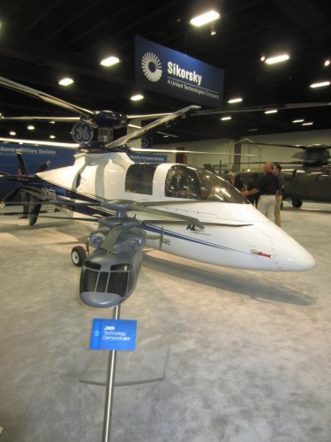

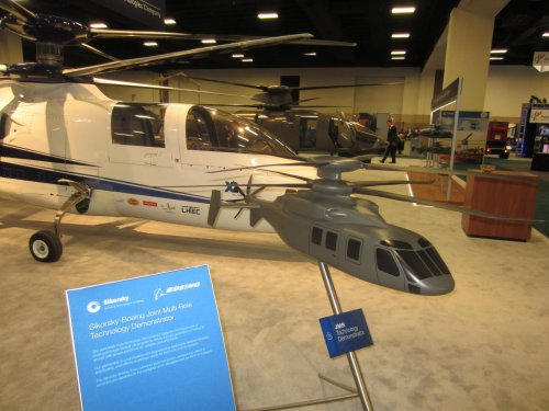

Photos of the Sikorsky/Boeing JMR/FVL Medium concept from the AAAA convention posted by the American Helicopter Society (AHS) International on Facebook.
https://www.facebook.com/media/set/?set=a.10151516962220528.1073741829.80119815527&type=3

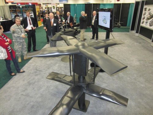

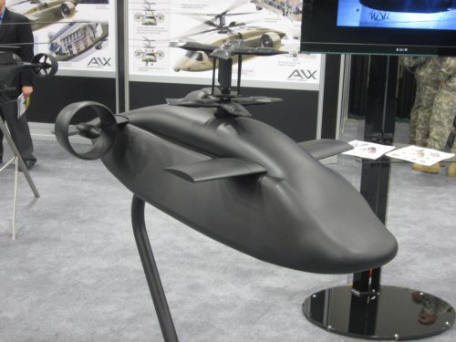

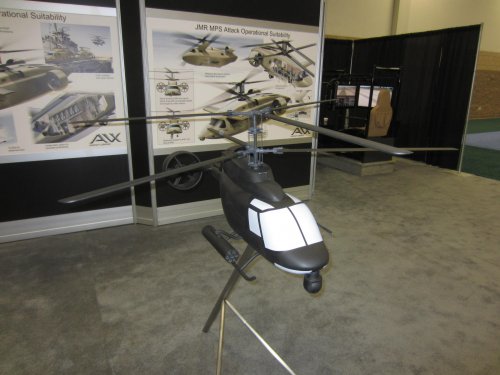

Photo of AVX windtunnel model and AVX booth from the AAAA convention posted by the American Helicopter Society (AHS) International on Facebook.
For a split second, I thought the AVX wind tunnel model was something a bunch of rotorcraft guys thought up as an alternative to the Cormorant UAV. Nobody is working on a submersible/amphibious UAV rotorcraft to fit in trident tubes, right?...
At one point DARPA was working on a UAV that turned into a submarine, but I don't believe it was a rotorcraft. Recovery was by some mechanical arm that extended out of a VLS tube, I think a 21 incher, and pulled it in.
Then there was the American Helicopter Society Annual student design competition several years ago where they asked the students to design a small helicopter that fit into a refurbished missile tube. There were a couple of very innovative concepts that the college teams came up with.
Now back to the JMR stuff.
I note that the AVX team went with both doors and a ramp. Seems to this old helicopter guy that the crunchies (er... Infantry) would like having more ways off the bus, especially if they have things with wheels, like heavy mortar systems etc.
It also facilitates carrying palletized break bulk stuff and just sliding it off, and sizeable parachute drops for resupply in hostile conditions. All the more so now that GPS guided parachute rigs sort of work, and could at least get very close to a typical FOB, if not necessarily inside the perimeter of a small one. This kind of capability apparently got a lot of attention on the CH-53K. Once you go to all the expense of making a high speed helicopter you really want to minimize use of sling loads anyway.
The ramp will also help with loading the internal weapons bays of the attack version. Because a ramp is orientated fore and aft like the launched weapons (Hellfire, JAGM, 2.75"). You will just be able to drive a fork lift or something up the ramp lower the ordnance to the level of the retracted rail or tube and slide them forward and into place. With sideways access you will have to reach in to behind (or forward) of the retracted launcher from (each) of the side doors to slide them into place, or scrable around under the fuselage with the launchers lowered, or completely swap out the firing modules meaning a much heavier lift in and out anda requirement for twice the number of launchers. None of them simple or practical solutions.

Does anybody here thinks the AVX designs have any hope for procurement compared to other manufacturers in these times of budget austerity?
Is there any evidence that the designs of the other manufacturers would be cheaper?
Which is the latest version considered?
The one with the integrated ducted fans into the fuselage or the one with the the ducted fans on pilons?

I believe the AVX concept with the canards is the latest version. As to their likelyhood of getting a contract, they are probably a long shot compared to the big three. However if they do get selected I am sure that they will attract the interest of one of the larger defense companies willing to take on the task.
As to the US Army being willing to stay the course in finacially constrained times, well it is anyones guess. Recall though that both the H-60 and the H-64 requirements were developed in finacially restricted times as well and went through a long period of doubt as well. Indeed Sikorsky was a long shot for the UTTAS selection with few thinking they would be able to compete with the giant Boeing. There are strategic issues that resonate with the rotorcraft situation. It has been ~40 years since a combat rotorcraft was designed in the US. I can tell you that it is not a pick-up game that any old aero engineer can whip up. Also with all of the adventures the US has been involved in, the life expectancy of they current fleet is greatly deminished. While rebuild and new build current aircraft may work in the short run, in 2030 when the entire situation may be completely different, asking a Boeing airline aero engineer to make a combat rotorcraft is not any smarter than asking an heart specialist to conduct brain surgery.

If the AVX Aircraft Company concept wins the FVL Medium contract, I wonder how long it will be before the company is acquired by another defense contractor?
Triton said:
I believe that John21 is asking if it is too risky for the United States Army to go with the design of a startup helicopter company that has not built any aircraft. Despite the fact that it was started by ex-Bell employees.
The other risk is that no one has built an aircraft quite like that. There has been a lot of experience with Tilt-Rotor, a lot of flgiht time on the X3 demonstrator (although I'm not sure how adaptable that technology is to this application), and while X2 is pretty limited, they did at least get an aircraft in the air.
I suspect that AVX may be hoping that Army will fund one low risk design, which at this level woud be Tilt-Rotor, and one "far-out-but-high-return-if-it-works" concept. Even if they didn't win, it would establish the techology as viable and could open the door for other civil and military applications. They could be looking at the long game.
