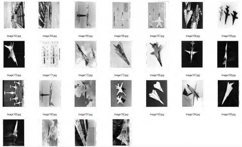

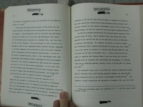

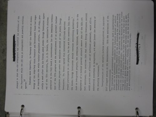

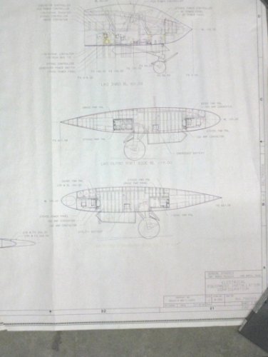

300 dpi. Selected images were scanned up to 600 dpi. Most were scanned grayscale, because most were either B&W line drawings or grayscale art. All color art was scanned in full color. All blueprints that were actually *blue* prints were scanned in full color.

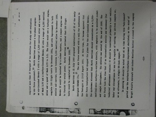

Some documents that were voluminous, largely text or I simply didn't have time to tackle with the scanner (about 40 seconds/page) were photograped with my new 8 megapixel camera. I tinkered a bit with the resolution from time to time. This obviously produced results less spectacular than scanning or photocopying... but photocopying would have been *real* slow (one photocopier, quite distant), and scanning was also slow. In the time I could scan a handful of detailed drawings I could photograph hundreds of pages of text.
Examples of photography below, all reduced to 1/4 their original size....

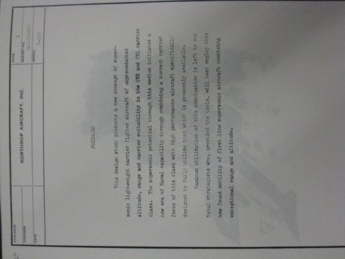

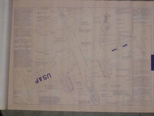

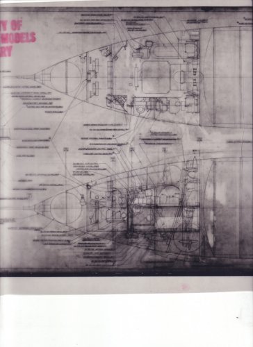

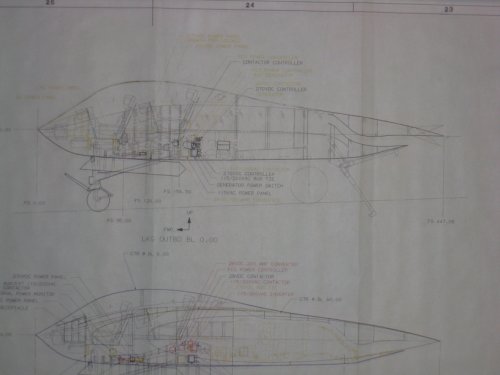

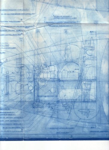

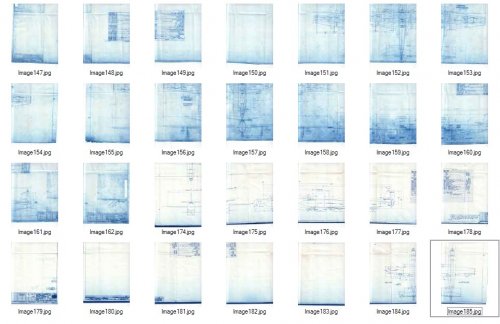

Here are some examples of large-format blueprints I scanned (again, shown one-quarter original size). One issue was that many of these have been folded for *decades,* and flattening them out perfectly would be impossible. One could argue, though, that it lends a bit of charm...

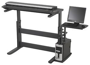

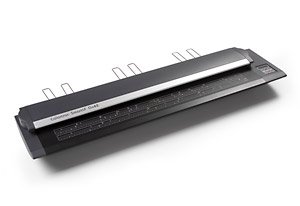

Hmm...seems this is one that Scott needs...up to 42” paper roll width))
Colortrac SmartLF Gx 42e scanner (separate block)...49 kg

There could be local rental services though...but it costs about 800-900 USD per month...
overscan said:
Hard to fit on a plane though.
And given that my clothes and, as it happens, the flatbed scanner I took are currently luxuriating on the West Coast rather than in my house indicates that dragging this thing hither and yon might not be such a good idea.
Also, to use one of these items *outside* the archive in question would require removing blueprints from the archive. This is often not possible. While I suspect I might have been able to talk Jay into allowing this on a limited basis while I was there, Boeing's archive, for example, would have me shot if I tried something like that.
So, scanning in pieces and stitching back together is time consuming and labor intensive and a serious pain in the ass, but it's generally the only option. For now, at any rate.

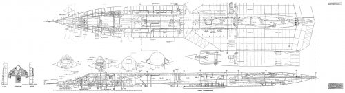

SR-71 inboard profile - Scott, are these scans or photos of giant blueprints roll?
And - if that's all Blackbird graphics of such quality that was there?
B-733, F3H, MX-775. :eek:..hope to see that files available for sale at your web someday...
Minor detail: it's actually a single-seat A-12, not an SR-71. Ooops.
Scans, cleaned up and stitched back together.

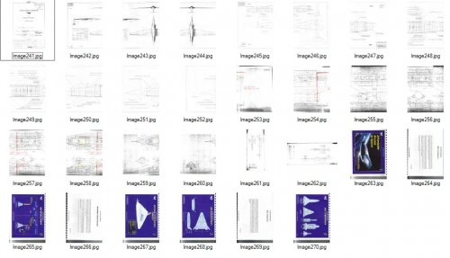

See the "lockheedlist.jpg" image up-thread for some other Blackbird stuff. For comparative purposes, the A-12 drawing was put together from the chunks found in "lockheedlist2.jpg," Image253.jpg to Image260.jpg.
