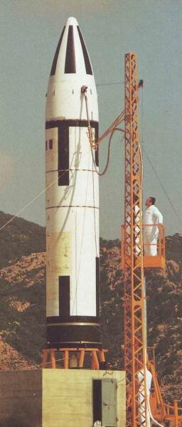

Italian SLBM ALFA Missile
A Polaris A1 Lite would be a better description; developed 10-12 years after the Polaris 1.
In the linked article it shows a cutaway diagram of the missile and under the payload fairing there appears to be a Mk-1 RV (Which carried the W47 warhead).
Scratching my head... 1600 km from the Adriatic is, indeed, enough to nuke Moscow. But the platform... a cruiser ? standing like a huge target on the surface of the sea ? Try giving that Alfa... SLBM a submarine ! Or an underground silo... SLBM: Ship (not Sub !) Launched Ballistic Missile ? not sure it is a good idea...
Or maybe the goal was just to scare the living bejesus, not of Brezhnev, but of Tito...
Hmmm... well not Moscow: from Trieste, it is 2000 km to the Kremlin...
Then again, Alfa was the size and weight of a Polaris A1 or A2, and they could hit much farther than 1600 km... even the A1 had a 2200 km range. And A2 immediately did better.
Look at the Informations about the Italian project of a nuclear submarine
If this SLBM had gone into service what warhead would it have carried?
