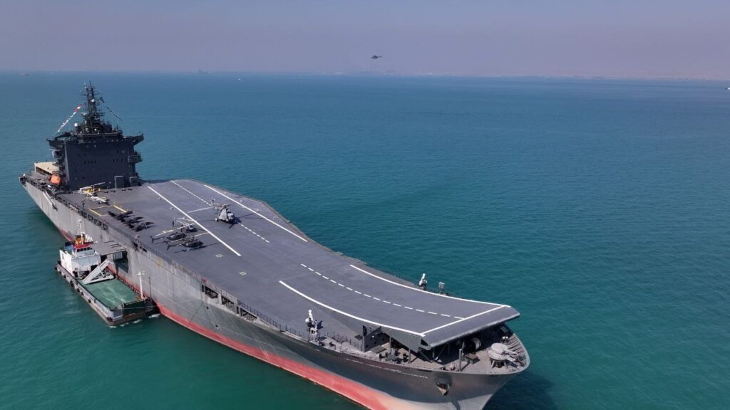

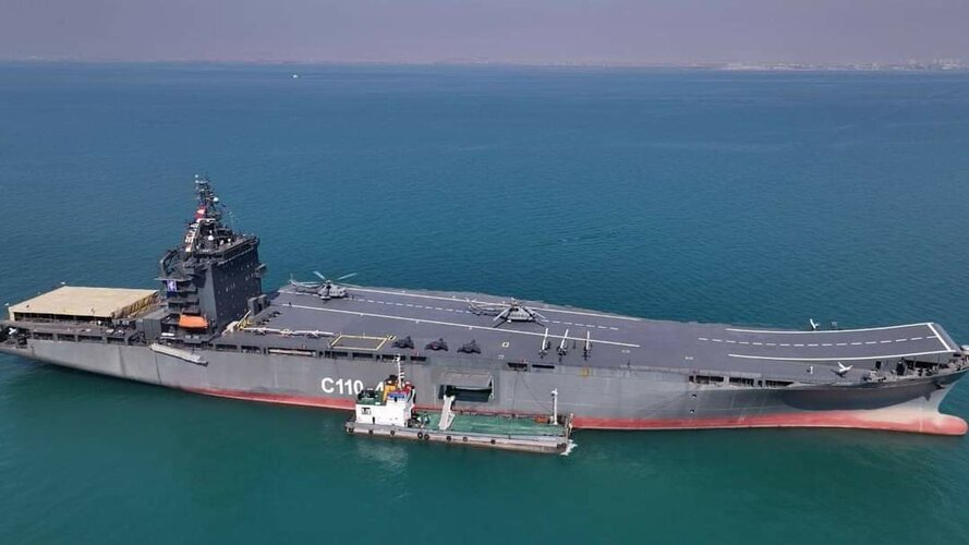

Looking at the picture,
For some (optical and perspective) reasons, I can't unsee the flight deck as undulating - as if there was a depression between the island and the ski jump.
Put otherwise: near the island the deck is level, then there is a "slump" downwards before the ski jump rising.
A very weird feeling, as if the deck was made of molten chocolate or plastic. Must be that Persian gulf hell of climate.

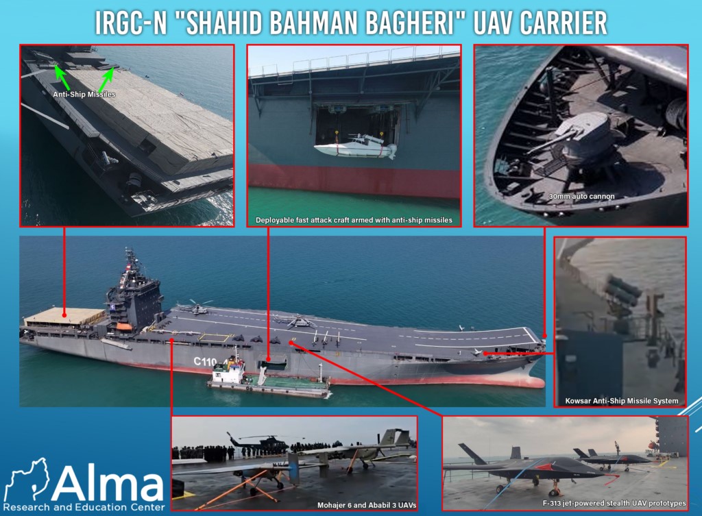

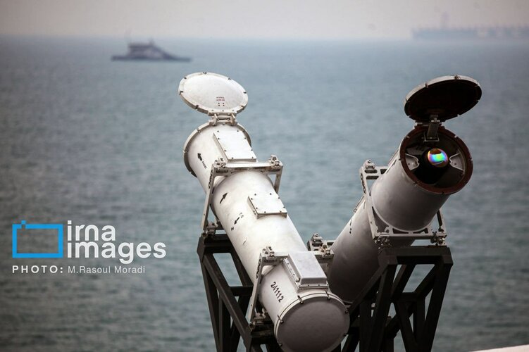

While a design of questionable usefulness in most hypothetical conflict scenarios for Iran, this vessel certainly has some interesting armaments beyond the flight deck:
1) 30mm Cannon, identical to the one fitted to the FS313-class corvettes also operated by the IRGCN. Presumably 2A42-based given Iran's familiarity with this design in other domestic projects.
2) 4x pairs of Kowsar-222 SAMs (claimed range is ~15km) installed at each corner of the vessel's deck / IR-guided based on the appearance of seeker.
3) 8x AshM Launchers (likely C-802/Noors based on appearance) located behind the superstructure / Notably, no Fire Control Radar appears to be installed...
4) At least 4x Gatling guns (20 or 23mm) similar to those fitted to FS313-class corvettes, co-located with Kowsar-222 SAMs.
IF there is a half-decent command system connecting all this kit, it's honestly a decent defensive suite given the vessel's civilian design.

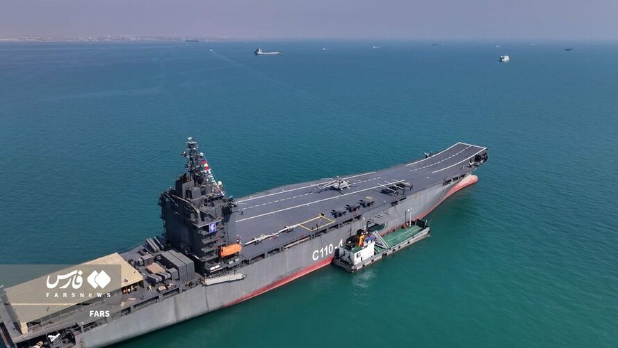

As it is, the Shahid Begheri is more like a modern version of WWII CAM, catapult armed merchantman, But with ski jump instead of catapult, and merchantman aspect degraded to virtually zero. It can not be considered to have risen to the level of a modern day escort carrier.
I think Iranian’s level of confidence in their own ability to fabricate the hull and structures of a real naval aircraft carrier can be discerned in the fact that they apparently didn’t feel up to remodeling the superstructure of the Shahid Bagheri, Despite the fact that the original blocky superstructure of the container ship so close to the axis angle deck doubtless present a menace to flight operation. In fact that didn’t even remove the now pointless bridge wing, normally used for docking, that hangs over the angle deck.
Also, they didn’t fair in the support under the angled deck. This makes the angle deck susceptible to damage in any heavy sea. This is likely to mimimise the weight of the new addition because the original hull girders were probably not reinforced to support the weight. Again this is an indication of timidity in reworking unsuitable structures.
One would think slightly more confidence would see Iran raze the ship’s original superstructure, build an axial flight along the length of the hull, perhaps slightly offset to the port side, fabricating a new starboard side island for smoke uptake and command and control, and fill in the original container holds with something like a hangar maintenance space connected to the new flight deck with an elevator. Then at least it could be said to have made a proper modern day version of escort carrier.
