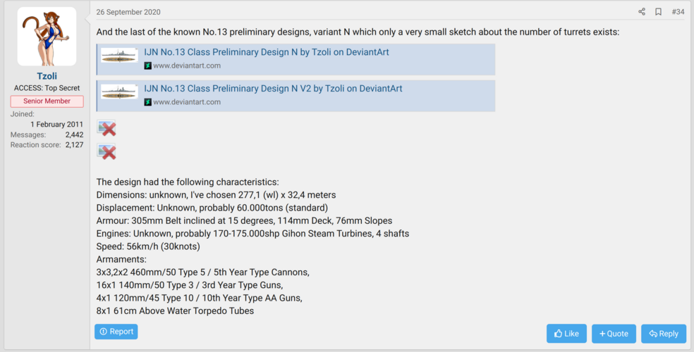

Does anybody have issues seeing the direct images of my drawings in this thread? Linked from my DA pafe?
Yeah they are not showing for me either.
Okay... I will look through them and fix them. Likely DA changed something on the links side.
Check now the direct drawing links should work now
I read somewhere about the No.13 design "O" which was a 35 knot+ battlecruiser variant of the No.13 K design (roughly) with 6x 460mm/50 cal. guns. Was this project really considered in the 8-8 fleet program? If so, is it reasonnable to imagine Design "O" being built as the battlecruiser alternative to Design K or whatever the official No.13-class design would've been?
I should update this thread to be about the Modified Kii designs and not No.13.
As for the Design O, I've only seen it in one book and an artist interpretation of it being 3x2 46cm with 3 funnels or 1+Y funnels, but I've never seen a mention of it in the Hiraga archive. I'm not sure it's a real proposal at all! Even the last design, N is just barely a sketch text above the data table!
