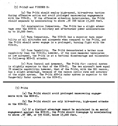

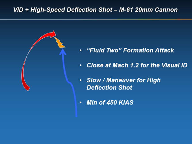

I don't think people realize just how poor the F-104's maneuverability was. Or what 'boom-and-zoom' tactics really mean. It doesn't mean just pulling up into the vertical and diving back down, or flying away for 10 seconds and returning. It means you need to accelerate to high mach and very high altitude and extend away from your bandit by enough of a distance that he doesn't get a fox 2 or gunshot on you as soon as you turn around. It requires a decent amount of preparation, coordination with wingmen, high SA, and generally favorable conditions to pull off properly.
If you are doing Defensive Counter Air, then you are in a good position to pull these tactics off.
If you are escorting bombers into enemy airspace with low SA, as we spent a significant amount of time doing in Vietnam, and you end up getting ambushed by high-maneuverability fighters - then forget it. Firstly, you wont have the raw instantaneous turn rate to jink an incoming gunshot (and with the F-104's downright dangerous performance at high-aoa you might even depart flight if you try). Secondly, if you try to extend away in order to rejoin in a better position, you will not only leave your bombers vulnerable but you may end up with a head on gunshot on your bandit at best.
All of this is to say that while these tactics can work, especially against older, subsonic fighters, it can be a downright headache to it pull it off properly. And that's against aircraft that should be obsolete against yours. If you are engaging MiG-21s, you will have such a disadvantage in sustained and instantaneous performance that you will need to stay above 600 knots and very high altitudes just to survive. I don't know how familiar you all are with modern dogfighting, but most merges will happen at 450-500 knots and by the time any one aircraft is in a position for a reliable kill you may be down to 200 or even lower.
Its so much easier to just build an aircraft that can turn properly to begin with. It got to the point in the '71 war that F-86s were more consistent in the air superiority role than the F-104s were.

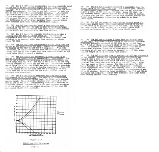

dispute its reputation the mig-21 wasnt ever maneuverable,it only seems like it is because of great first turn proformance thanks to its delta, but that same delta causes it to drop like a brick on every subsequent turn. hell its even called a interceptor on Wikipedia!
Although the MiG-21 was technically/officially a point interceptor, it did actually end up with decent maneuverability. That's why the U.S. used the also respectably maneuverable F-5 to simulate it. The E-M diagrams and evaluations in HAVE DOUGHNUT also show this quite clearly. HAVEDOUGHNUT 1.PNG HAVEDOUGHNUT 2.PNG HAVEDOUGHNUT 3.PNG

And yet whenever the f-4 dogfought mig-21, sometimes even from ambush it regularly out turned the mig-21, besides this only said it has better manuvbilty then the f-104 not the f-4. Dosnt help that the turning abliatly of the f-5 has been exatuated do to its use in training. Those were generally with very light aircraft.

I’m not surprised that the f-4 can outturn the mig in certain situations. The f-4 had a decent TWR and at low altitudes/high speeds could perform well against the mig. Doubly so if the mig is coming in too hot and is way above his cornering speed or gets too slow.
At higher altitudes the delta wing of the mig actually gave it an advantage.

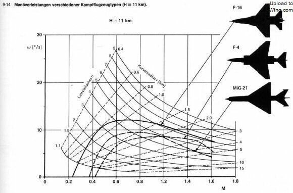

Edit: For proof here’s an E-M diagram comparing the F-16, F-4, and MiG-21. Looks to be at an altitude of 11km if I’m reading that correctly.
Consdering i can't think of a dogfight that happened above mach 1 I think that diagram rather proves my point.

Take a look at the diagram again. It shows that at 11km (30k ft.), the MiG has a higher sustained turn rate below Mach 1.2. Above 1.2 and the Phantom starts to out-rate the MiG, but those speeds are really uncommon.
Your right i did miss read that chart, but you do really have to keep in mind its a chart on 11km on the first turn. deltas always give a false impression of manuvbilty do to great first turns but they lose energy rapidly on every subsequent turn and when you consder how close they already are then you see that the f-4 rapidly gains huge turning advantages after the first. thats why every frount facing fight whent to the f-4, most neutral fights and even a lot of disadvantage fights (they could get fast enough to get distance) whent to the f-4 when you break it down (difanceses in polite training also helped but if f-4 manuvbilty was an issue you would see these numbers a lot more even then this).

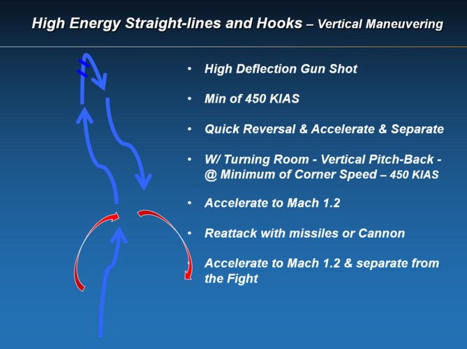

"boom and zoom" is one term, but I'd prefer "fighting in the vertical" (vs. a horizontal fight, i.e., sustained turn). Barrel Roll, High Yo Yo, and Lag Displacement Roll are all examples where energy tactics, in the vertical, are used to avoid having to simply turn with an opponent. These require neither high mach nor high altitude.
These tactics do take a higher level of pilot training than simply turning hard, but the USAF has had a comfort level with them since WWII in the Pacific, in particular. When faced with the Zero, neither the US Navy nor the AAF tried to produce planes that would turn with the Japanese fighter; they wanted planes that had speed and altitude advantages that could be converted, via good tactics, into superior dogfight performance.
None of this is saying that a good turn rate isn't desirable, especially in the days of early AAM and gun fighting and an F-104 pilot that got pulled into a turning fight would be in a bad spot, but the thinking behind the F-104's design (as an F-86 successor) was solid and was vindicated in the Featherduster trials, where F-104s emerged as the superior air to air fighter vs. a variety of other US models despite poor turning performance.

This is where I think the F-104 scenario has the edge. It's not that it's a stellar fighter - it isn't, although it's not a total disaster either. It's that a USAF which buys F-104s is a USAF that views air-to-air combat as something worth training pilots for.

You are still reading the chart wrong. It is illustrating the sustained turn rates of these 3 aircraft, i.e., how hard they can turn without losing energy. And it shows quite clearly that the MiG-21 can sustain it's energy better than the Phantom at any speed below 1.2 mach.
At low altitudes, this would be a different story. The Phantom's thrust to weight might give it an advantage, although it will probably still need to stay fast. You have to remember that this chart is showing the performance at 30,000ft(!).

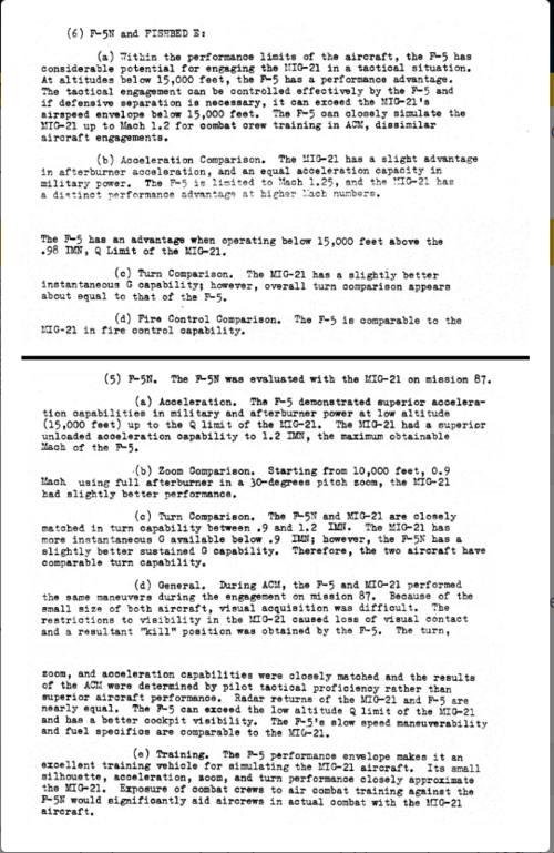

Could something akin to a F-86H, FJ-3/4, or F-9J with Sidewinders be a reasonable counter?
No, not an F-86. .50cals are not effective at taking down MiG-17s. FJ3/4s have 20mm, that's the minimum effective caliber on jets.
Also, I question the ability of any of those aircraft to have the range to fly with the bombers due to early engines.
