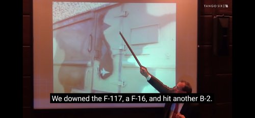

Colleagues, thank you for your input. I watched the film that Ronny referred to. (Thank you Ronny for the link.) Mr Dani mentioned in it that their P-18 worked on the lowest frequency of 140 MHz which he named the 'L-1,' streamlining the detection of the F-117, and that the information from the P-18 went to -- I assume -- the SNR-125, to its TV monitor, which suggests that the tracking method might have been other than a radar. overscan (PaulMM) mentioned the SNR-125's TV capability. (Thank you overscan (PaulMM) for the important comments.) At 22:01 of the film starring Mr Dani, he mentioned: "on our manual targeting screen, it was very clearly shown". The F-117 was downed after 8pm, so I assume it happened in complete darkness, which would be in line with the F-117 tactics. While we do not know if the SNR-125 in place was equipped with a night vision tracking camera instead of the standard daylight camera the original kits were sold with, does this mean that the lock was indeed obtained through the SNR-125 radar, which could pump out, as far I remember, about 0.2MW of RF power, or even more? Assuming that the F-117 indeed was visible to such a beam at 13 km, what eventually could be the source for missile CLOS data: the radar or a thermal camera? Also, how Mr Dani could have determined with such a precision that the F-117 was 13 km away from their S-125 battery?
