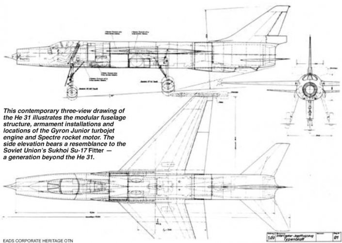

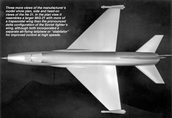

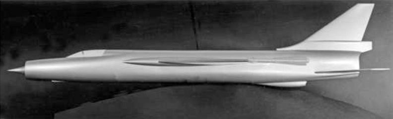

You may find it interesting that in German Wikipedia an article on the Heinkel He-031 Florett has recently appeared (http://de.wikipedia.org/wiki/Heinkel_He_031). It is obviously in German, but can be easily understood even without help of the Google Language Tools.

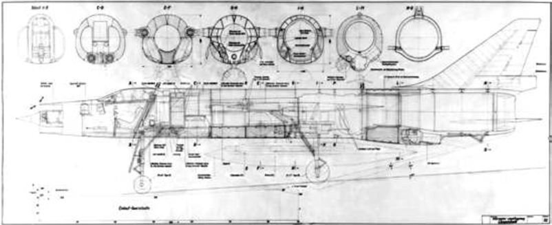

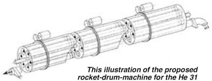

Anyway, the article says the Florett was to be armed, besides the wing-tip mounted missiles, with two batteries of unguided 50mm rockets. Personally I cannot see these batteries in drawings of the fighter that are being available here (albeit they are not of the highest quality). Could anybody clarify the issue?

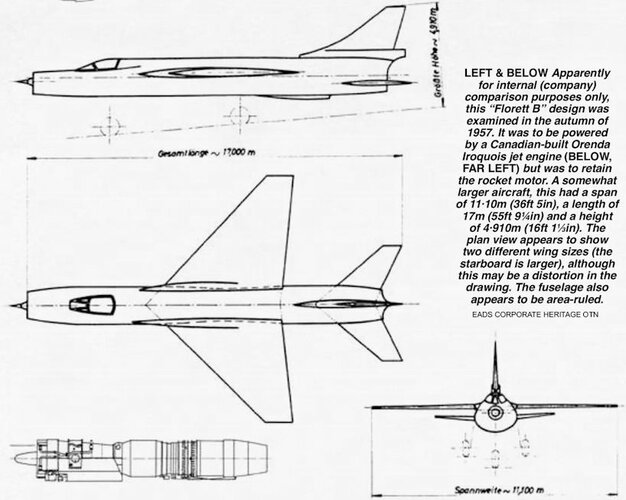

The Wikipedia article claims that the Florett was cancelled in the early 60s due to the Luftwaffe's desire to procure VTOL tactical aircraft, however, as far as I'm aware, those specifications didn't come until later in the decade. Considering the timeline of the He 031's development, I have to question whether this design was killed not by the Luftwaffe's desire to structure their air force around VTOL tech, but rather the F-104G...
Florett B with the Orenda Iroquois is a cool find! Thanks for that.
As for F-104G vs planned VTOL, dating works for both. The BMVg issued its tender for a VTOL all-weather fighter on 02 Dec 1957. By then, Heinkel had dropped the He 031 Florett interceptor project. Heinkel's design team led by Siegfried Günter were already exploring a J79-powered tail-sitter followed by what became the 1957-58 He 231 canard with nose- and tail-mounted J85s (prior to the shift to rotating engine concepts).
I forgot that the West German Luftwaffe was rearming at a breakneck pace, also admittedly wasn't certain of the timeline on their VTOL requirements, I didn't realize they were put forward as early as 1957. I guess the combination of the F-104G procurement along with the coinciding requirement for a future aircraft to have VTOL capabilities left no reason for Heinkel to continue work on the Florett, abandoning it in favor of the 231 and further VTOL concepts. I do wonder about the timeline on the Florett B concept and again, why the in-house HeS 053 was never considered for this airframe.
